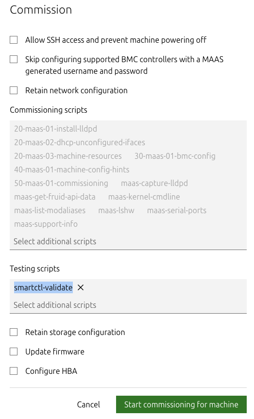

I need to run custom script in “testing” section automatically when I run commissioning (like “smartctl-validate” on screenshot). I mean that when I press commissioning I want to see this script already added in section “testing” and I don’t need to choose it manually from the list.

P/S/ my suggestion regarding default was wrong. this parameter just locked script like other defaults scripts
Ah, now I follow. Thanks for the explanation.
Thats actually looks like a nice feature request.
AFAIK there is no way to do it, but one thing you can try is to set the default field in the database to true for your script in maasserver_script table
