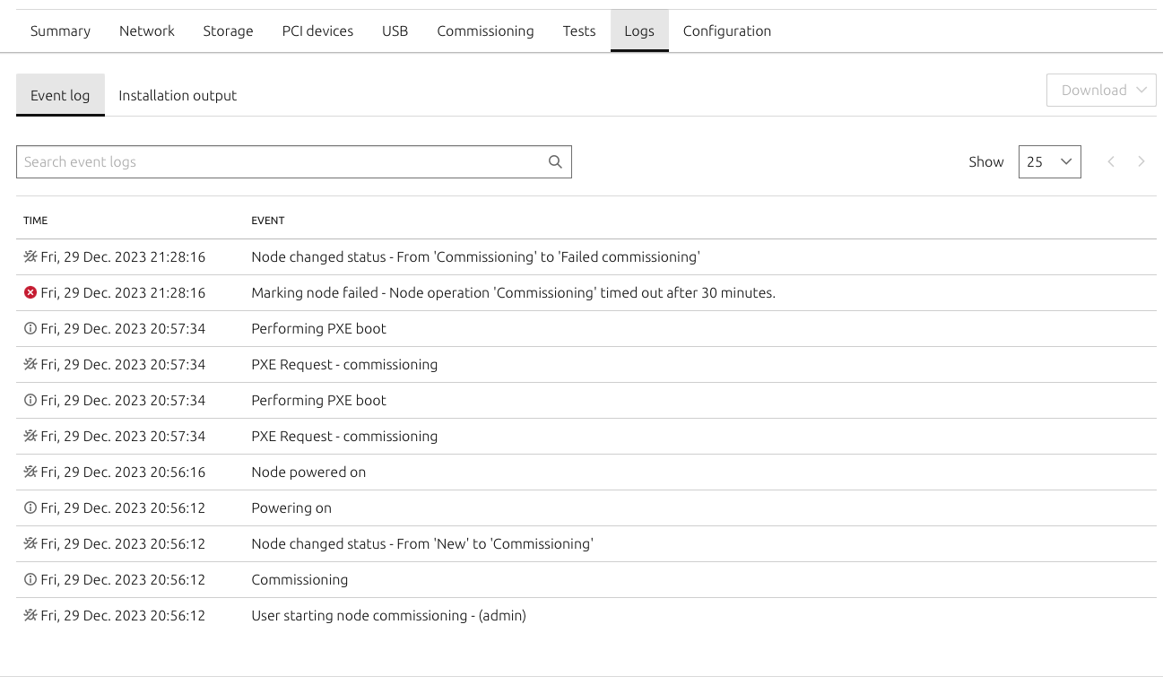

I’ve been trying to familiarize myself with Ubuntu’s MAAS, but consistently encounter failures when trying to get a test environment up and running. For reference, I’m following the guide “Build a MAAS and LXD environment in 30 minutes with Multipass on Ubuntu” and after spending several hours on this “30 minute” experiment, it just won’t work as described.
I first tried with a (fresh) install of ubuntu-18.04.6. When that didn’t work, I then installed ubuntu-20.04.6. In either case, I followed the guide linked above step-by-step, but it ultimately fails whenever I try to commission a machine:
So far, nothing terribly insightful showing up in system logs. I also connected to the console of the lxc instance I’m attempting to comission, and it simply shows this the message: “Booting under MAAS direction…” and nothing else. Clearly, the PXE boot is failing, but I’m not sure why that would be.

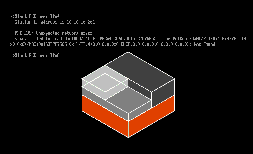

I managed to get a console screen shot earlier in the boot:
That IPv4(0.0.0.0…) bit looks very suspicious. Some conversation with DHCP server must have happened because PXE got an IP address, but the boot details seem to be missing.
I think you should check maas /var/snap/maas/common/log/dhcpd.log for errors. Another log file you could check is /var/snap/maas/current/supervisord/supervisord.log (superviord is coordinating various daemons that MAAS is composed of)
