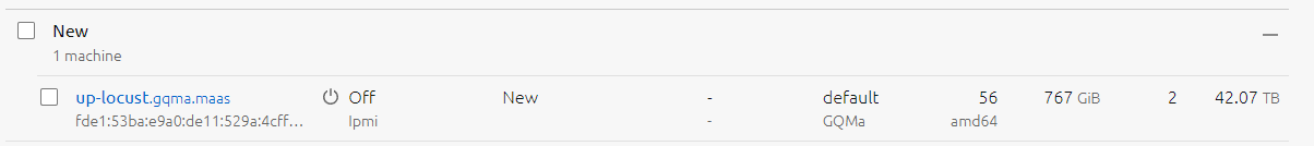

I actually have one question on how to use Terraform MAAS provider to setup a “new” system.
MAAS discovered and setup a new system.
I already have TF resources networks, subnets defined.
For this particular server I also defined the phyisical interfaces and vlans, drives, etc.
I created Terraform for it but i’m getting.
Error: ServerError: 400 Bad Request ({"mac_addresses": ["MAC address xx:xx:xx:xx:xx already in use on up-locust."]})
It seems that the MAC address is already in use by some other node in the system.
