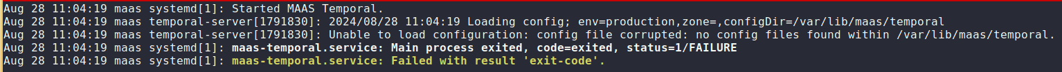

      Unable to load configuration: config file corrupted: no config files found within /var/lib/maas/temporal.

After the upgrate I got:

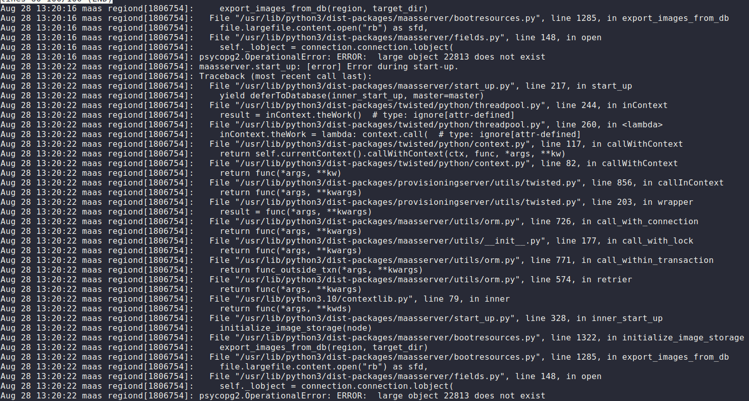

@troyanov the last lines of journalctl are:
It seems that an initiation script failed because of the images that were previously stored in the db
@eliasb in 3.5 we changed the way we store bootresources (they are not in the database anymore) and during upgrade to 3.5 they should be extracted onto the disk.
At first glance it seems that some of the blobs that should be exported do not exist in your database.
the missing BLOB is likely an unrecoverable error, so I suggest that you remove it
