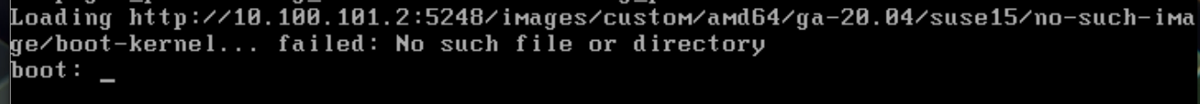

When deploying after the first reboot, I am left with this
I tried to create that folder and copy contents from similar folders in to the one mentioned in the screenshot (there is also a boot-tgz in a suse15 folder somewhere else (generic) that I placed on this location, too) but so far it made no difference.

Fri, 11 Aug. 2023 10:20:43 HTTP Request - /images/custom/amd64/ga-20.04/cenost8stream/no-such-image/boot-kernel
Fri, 11 Aug. 2023 10:20:43 Marking node failed - Missing boot image custom/amd64/ga-20.04/cenost8stream.
Fri, 11 Aug. 2023 10:20:43 HTTP Request - pxelinux.cfg/01-00-50-56-8b-25-d9
Fri, 11 Aug. 2023 10:20:43 Performing PXE boot
Quick note before it gets forgotten:
maas admin boot-resources create name='custom/suse15' title='suse15' architecture='amd64/generic' filetype='tgz' content@=sles15.tar.gz
As suspected you need to change the name attribute in the command:
name='custom/suse15
to
name='suse/suse15
This way MAAS will assign it to the right directory and the correct “boot kernels” (?) will be assigned. This way I was able to get past this initial error.
