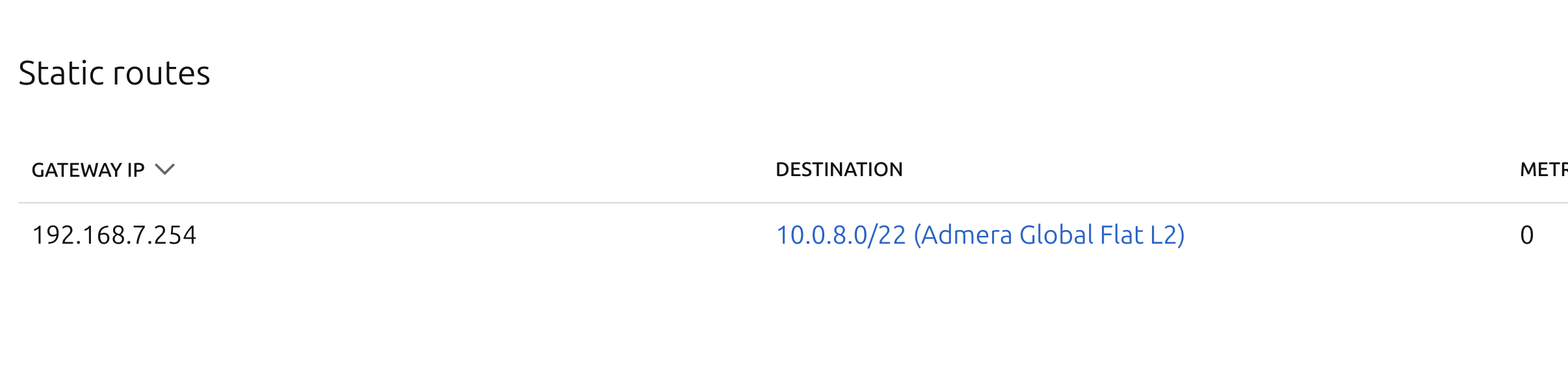

I’m facing a serious issue where maas is not adding static routes correctly. Instead of using the gateway defined in the static route, maas is creating an additional route for the network via the default gateway for the subnet. See bug
This is a pretty serious blocker for us right now in the middle of a production deployment. Any advice on how to get the additional static route on the the machine would be huge - thinking I might be able to use dhcp snippets as a workaround.
