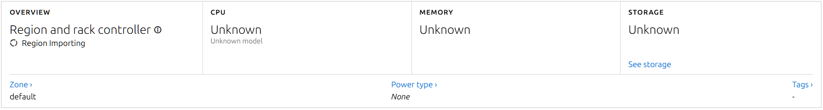

Effectively, the 3 controllers appears up and green (and in sync) through the UI but when I display the details of a controller, I get this and the “Region importing” process never ends and details are stuck to “unknown” :

Probably the commissioning scripts for the infra nodes are not being processed.
We know that there are issues when the host have really a lot of network interfaces. Is that the case?
Output of ip a?
