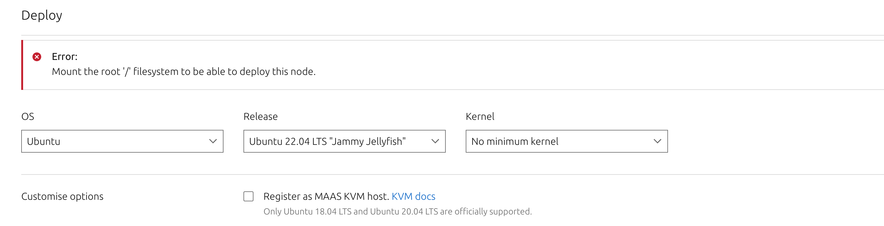

However, when I try to Deploy the node, it immediately throws an error that says Error: Mount the root '/' filesystem to be able to deploy this node
I see the following traceback in /var/snap/maas/common/log/regiond.log:
2023-06-02 22:49:54 maasserver.preseed: [warn] WARNING: '/snap/maas/27405/etc/maas/preseeds/curtin_userdata' contains deprecated preseed variables. Please remove: main_archive_directory, ports_archive_directory
2023-06-02 22:49:54 maasserver.websockets.protocol: [critical] Error on request (12) machine.action: {"storage": ["Mount the root '/' filesystem to be able to deploy this node."]}

	django.core.exceptions.ValidationError: {'storage': ["Mount the root '/' filesystem to be able to deploy this node."]}
Is there some incapability of the layout to mount / on a RAID device?

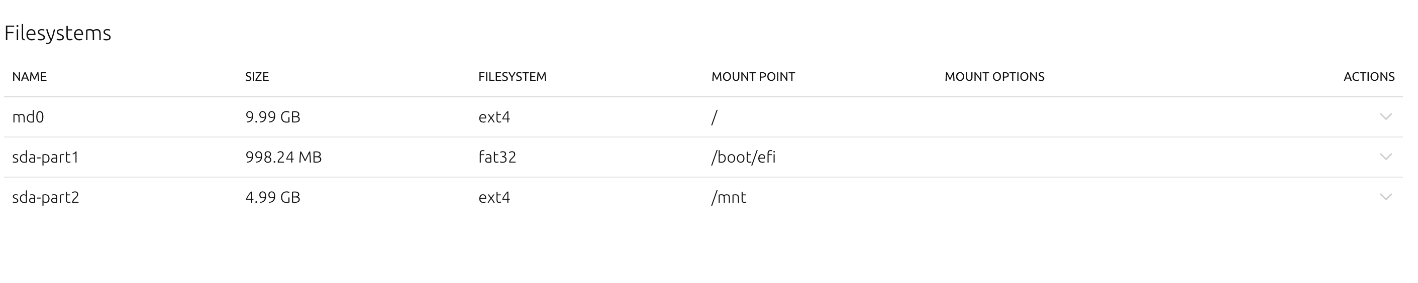

Once I uploaded this script and re-commissoned the node, the “Storage” tab of the node showed me the layout I expected:
Then I was able to Deploy the node without any errors. The layout looked exactly as I expected.
I’ll also mention here for posterity that I was also able to mount the RAID device to / once I added a “bootable” partition
