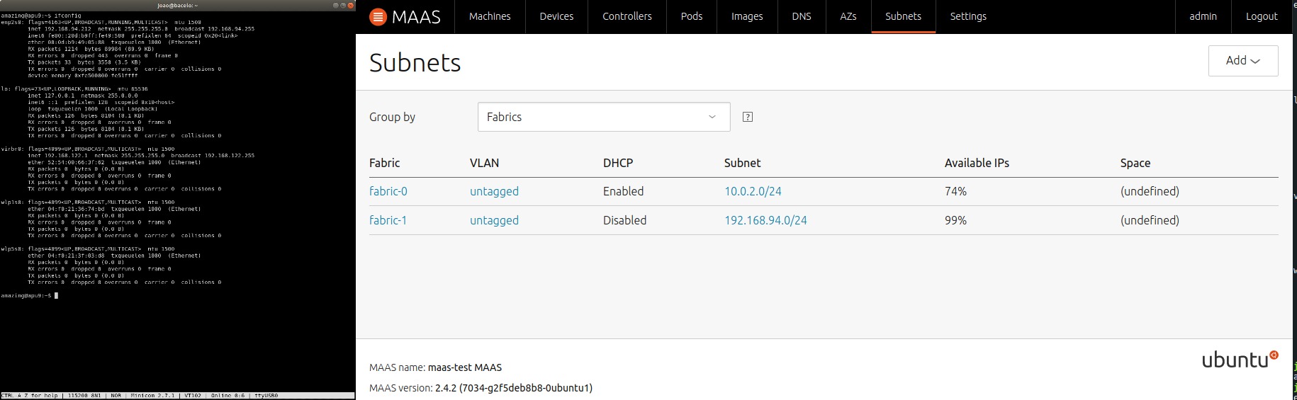

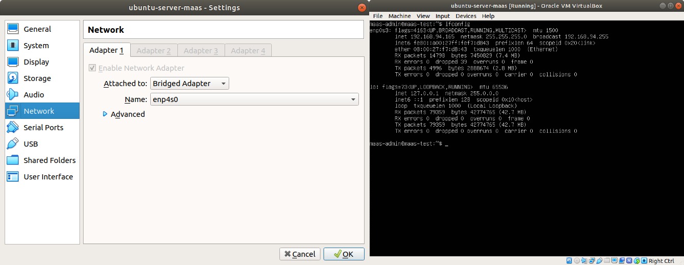

- Have you checked that your MAAS controllers PXE interface is bridged to the physical network that the node is plugged into.
- Have you configured your subnets and enabled DHCP on the rack controller?
- Can your verify that when the node boots it’s first boot device is a PXE capable network card and that there’s no operating system on the primary hard drive

Yes, I think I set up it well:

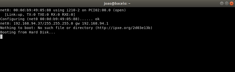

The node first boot is a PXE capable network but is has indeed on the Hard Disk a ubuntu server 18.04.
And after that it boots from the hard disk.

On top of that, you aren’t even getting that far. I have had a problem in the past where I couldn’t get certain types of network traffic into a VirtualBox guest. I can’t remember the exact details but I strongly suspect that I was trying to do exactly what you are doing now. I was running VirtualBox on my Mac and the network traffic was clearly being filtered even though I was using a bridged connection. I expect that the DHCP packets from the APU are not being forwarded to the MAAS virtual machine.

I just used Wireshark to see how is the booting process going on, this what I got:
- I guess MAAS is working fine because I can see that it is sending Discovery packages to the network.
- When I boot the APU via PXE I can see that it is sending a Discovery package as well but it has no reply by the MAAS machine…
On the other hand, the MAAS is listing the APU (after its Linux boot), on the “Network discovery”.

So, I started again from scratch using Virtual Machine Manager instead of Virtualbox and I end up solving the problem.
I don’t now why Virtualbox didn’t allow the VM to talk and reply to the DHCP request coming from the APU.
