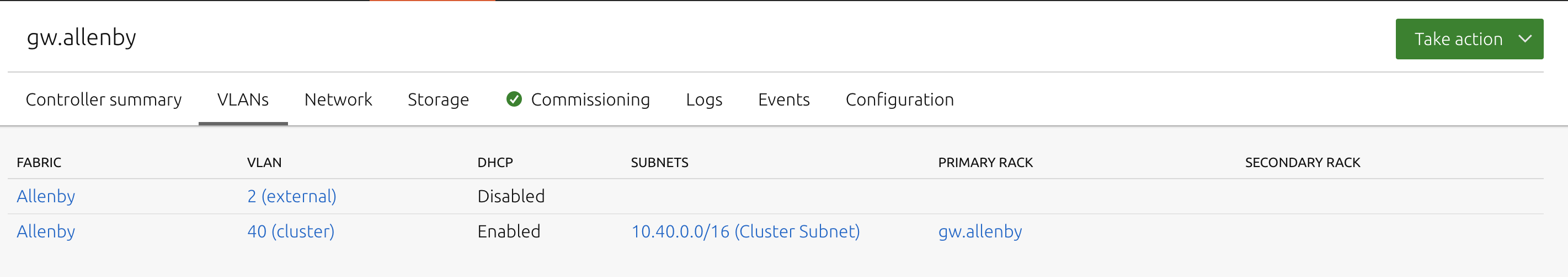

Hello @cgrabowski,
Apologies on the delay in replying. But I looked at your suggested actions and tried to follow them to the tee, but we cannot seem to get MAAS provided DHCP run on multiple VLANS.
Shown below is the configuration of the system, with specific directed questions:
MAAS Version: 3.1.0
Netplan Configuration
Here is the netplan
configuration of the node which runs the rackd
process
network:
ethernets:
eno1:
addresses: [10.40.1.1/16]
nameservers:
addresses: []
search: []
eno2:
addresses:
- <REDACTED>/24
gateway4: <REDACTED>
nameservers:
addresses:
- 127.0.0.1
search:
- mcgill.ca
- allenby
- maas
vlans:
vlan-fpga:
link: eno1
addresses: [10.60.1.1/16]
vlan-data:
link: eno1
addresses: [10.50.1.1/16]
version: 2
Questions
- Is the Netplan configuration look sound and conforms with what
MAAS
expects?
DHCP Configuration
We want the DHCP server to run on eno1, vlan-data, vlan-fpga
interfaces.
The interfaces were configured before the rackd
process started.
All the interfaces are up and running, with valid IP Addresses, as seen in ifconfig
eno1: flags=4163<UP,BROADCAST,RUNNING,MULTICAST> mtu 1500
inet 10.40.1.1 netmask 255.255.0.0 broadcast 10.40.255.255
vlan-data: flags=4163<UP,BROADCAST,RUNNING,MULTICAST> mtu 1500
inet 10.50.1.1 netmask 255.255.0.0 broadcast 10.50.255.255
vlan-fpga: flags=4163<UP,BROADCAST,RUNNING,MULTICAST> mtu 1500
inet 10.60.1.1 netmask 255.255.0.0 broadcast 10.60.255.255
However when the snap runs, it only picks up eno1
. Here is the exact command that the snap runs
/snap/maas/17694/usr/sbin/dhcpd -f -4 -pf /var/snap/maas/common/maas/dhcp/dhcpd.pid -cf /var/snap/maas/common/maas/dhcpd.conf -lf /var/snap/maas/common/maas/dhcp/dhcpd.leases eno1
The interfaces also don’t show up on the Network
tab for the Rack Controller. Only the 10.40.x.x
interfaces mapping to eno1
shows up.
Questions
- We feel like we are missing something quite obvious or we have encountered a possible bug in the system?
- Is there something else we can try?
I am also tagging @anton5mith for added visibility, since this was issue was an action item from our meeting.
