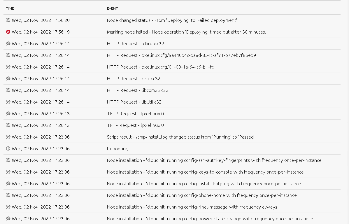

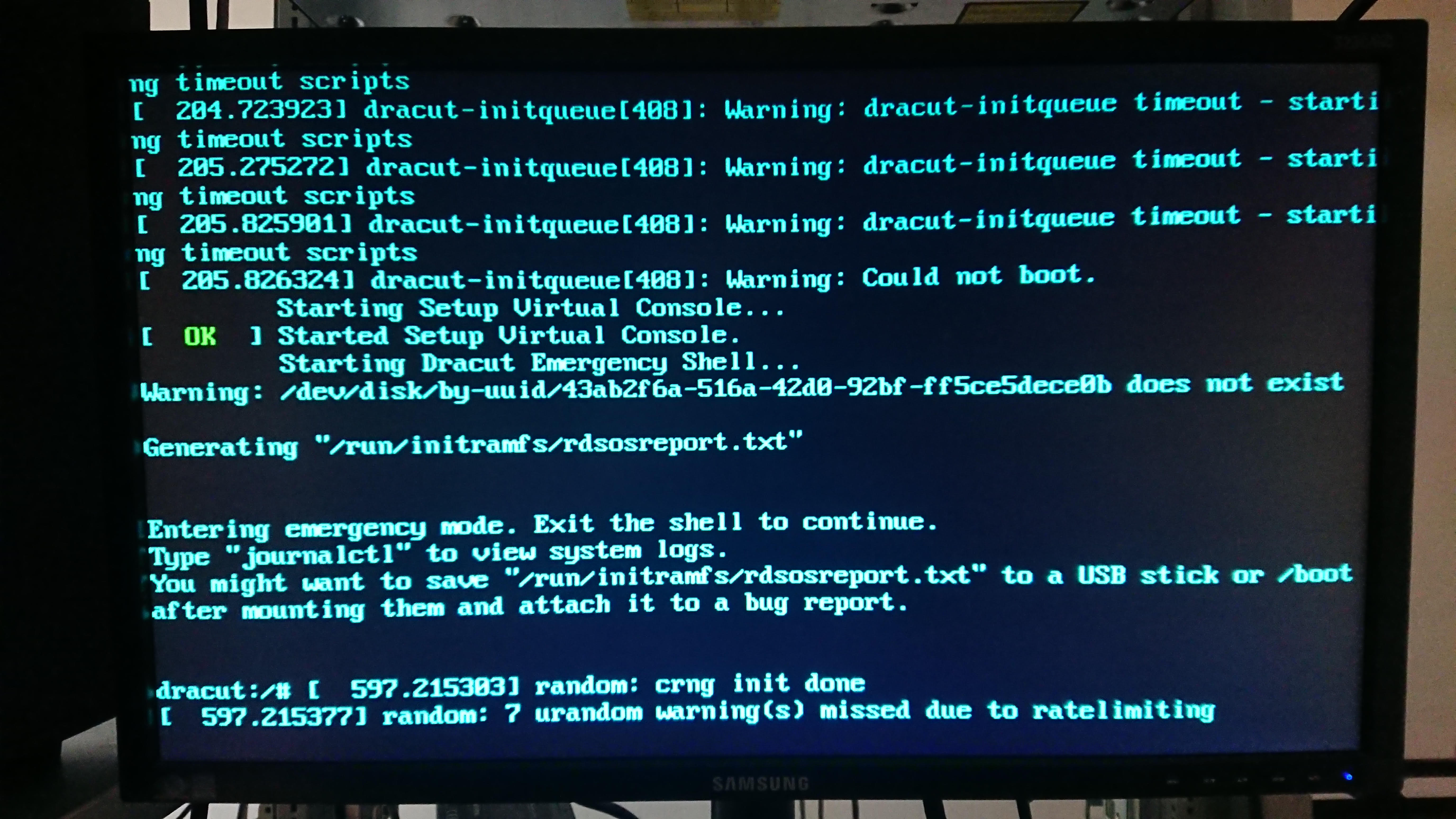

In short, I am getting “Failed deployment” on the node and the only message I am getting from maas UI is this:
Looking at logs I see that after all the software was installed when the next step is to reboot machine it just do not start. Did anyone experience something like that?

curtin: Installation finished.
This is what I see in monitor screen:
After I made a reboot this was on the screen:
Let me know if this works for you.
https://github.com/Shadowphax/maas-rocky8-fix
I will reword the README at some point. Just wanted to get the fix to you ( which I think works )
Hi, thank you for the reply. May I ask you which curtin_userdata_rocky file I should use in /etc/maas/preseeds/? In readme says that it curtin_userdata_rocky file is just a copy of centos, but in my case content of curtin_userdata_rocky and curtin_userdata_centos differs. Shall I use curtin_userdata_rocky file as copy of centos curtin file or I should create a new curtin_userdata_rocky file and add content from this file https://github.com/Shadowphax/maas-rocky8-fix/blob/main/curtin_userdata_rocky ?
Use a copy of curtin_userdata_centos and call it curtin_userdata_rocky.
