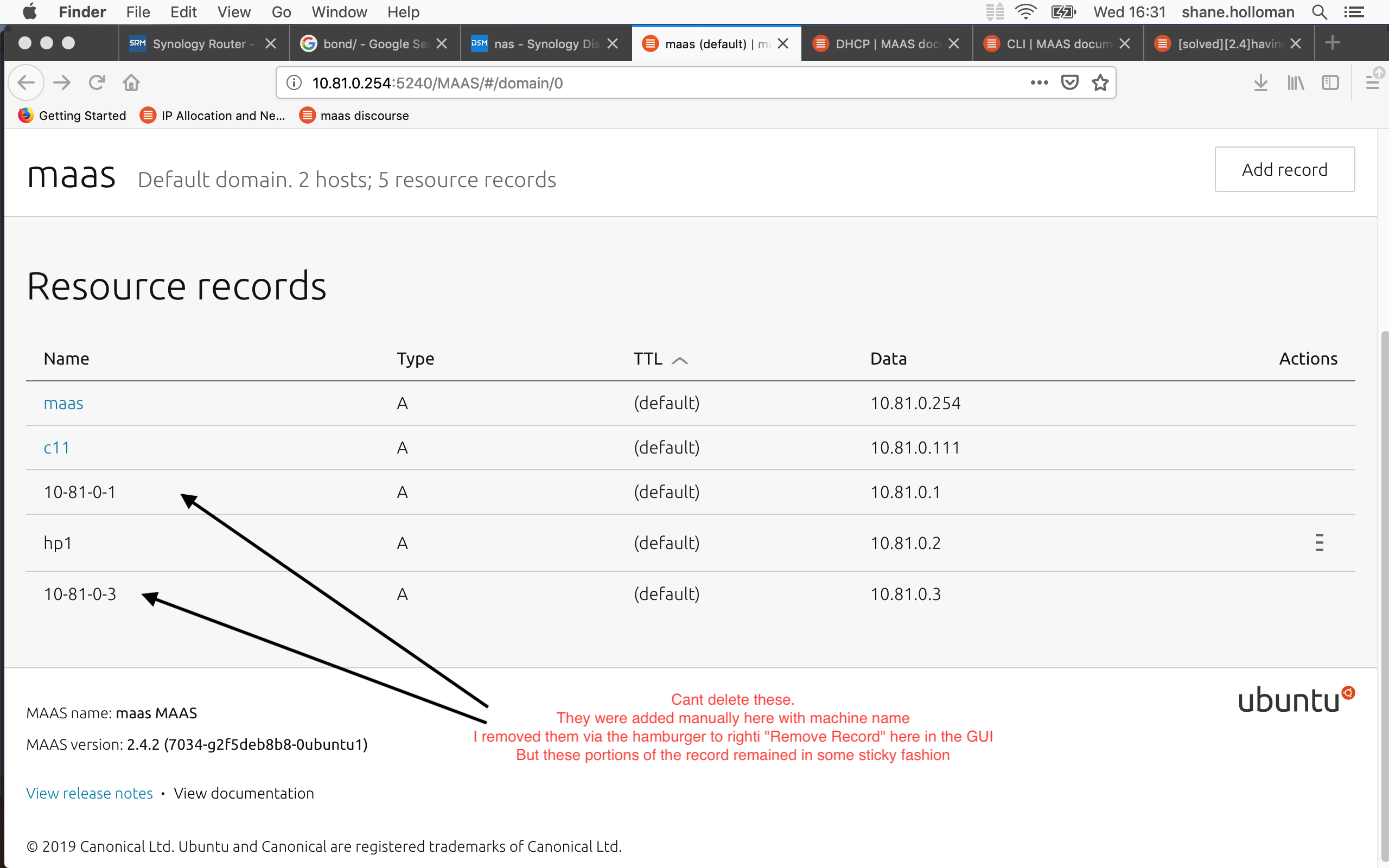

I removed manually entered host entries but they remained even after I removed with the GUI and then via this example [solved][2.4]having difficulty deleting a dns record
See image below NOTE: I did not place those as xx-xx-xx-xx I used machine names. maas replaced as this when I attempted to delete
If I attempted to delete hp1
the same thing would happen

I think I just found out what’s going on. When you do such an error a static ip address is reserved based on the data field of dns record. In your case 10.81.0.1,10.81.0.3.
You can try do the following:
maas root ipaddresses release ip=10.81.0.1
maas root ipaddresses release ip=10.81.0.3
In my case I managed to delete both the reserved ip and also the stale dns record

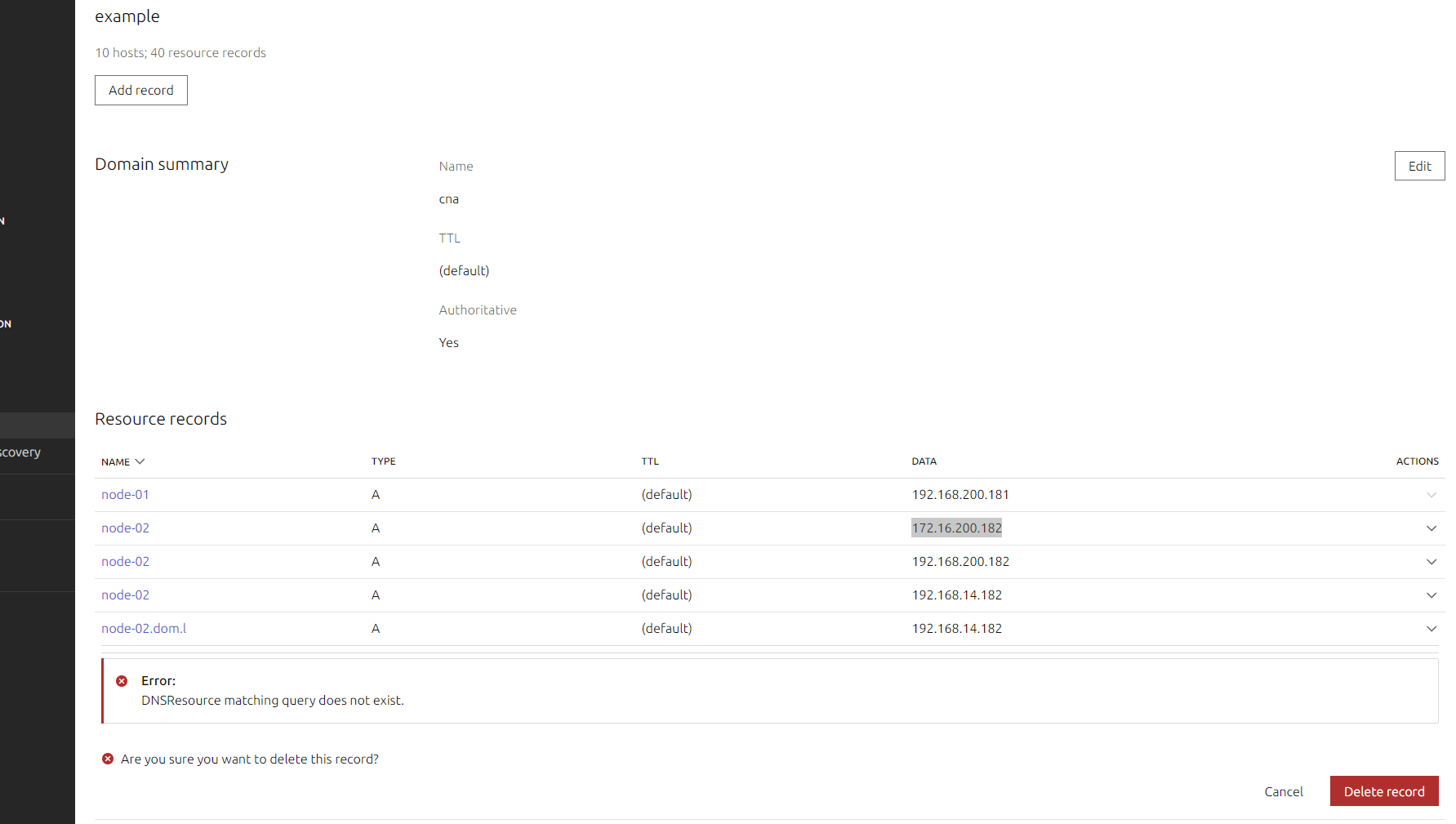

i had same issue with this different error but i removed with the suggested command
maas root ipaddresses release ip=192.168.14.182
