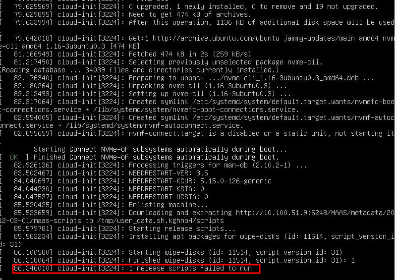

Release server with secure erase disk failed
When releasing with secure erase disk enabled the disk failed to erase
Above was the log of the failed deletion
Does this mean that my disk’s firmware does not support this operation ?
Im using MAAS 3.5
The disk is SAMSUNG MZQL23T8HCLS-00A07 with the firmware GDC5A02Q
The image is the default Ubuntu 22.04

The installation output is just empty
After running the script wipe-disks manually on a deployed node I found out that the virtual disk sda is detected and the script tried to wipe it resulting in the error below:
  File "/root/maas_wipe.py", line 719, in <module>
    main()
  File "/root/maas_wipe.py", line 697, in main
    zero_disk(kname, info)
  File "/root/maas_wipe.py", line 517, in zero_disk
    with open(DEV_PATH % kname, "rb") as fp:
OSError: [Errno 123] No medium found: b'/dev/sda'
