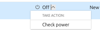

I do it from the machine page:
selected the machine and then Power Cycle>Power On…
from the list view i cannot do it:

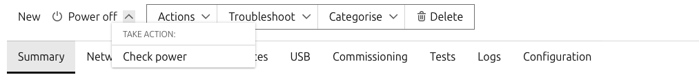

Sorry, I was talking about machine details/summary view:
i cannot do it neither from that view:
Does it need to function even before the machine is commissioned? Is that correct?
Redfish has its own API.
Oh, you have your machine in the status New
, in that case it won’t work.
