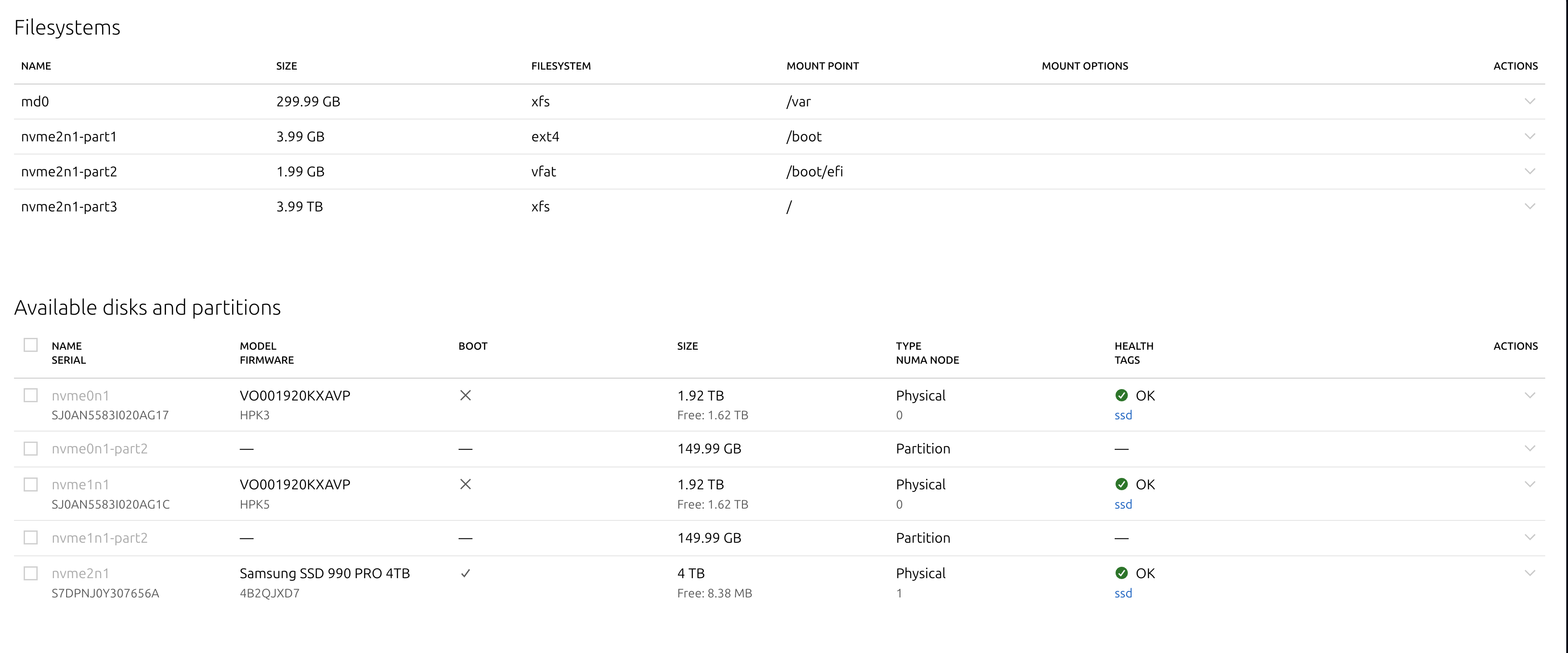

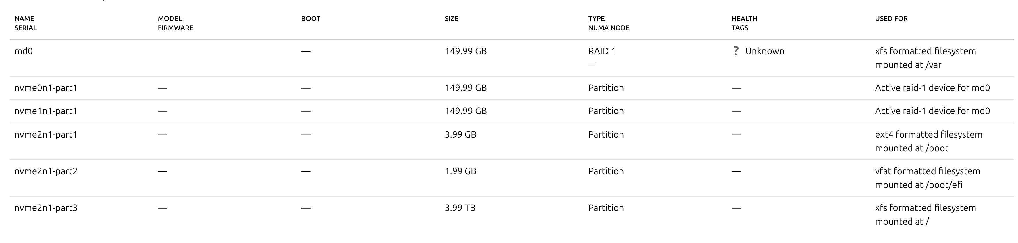

I was able to deploy maas from a custom ubuntu 24.04 image but when I tried to set up raid 1 on two disks or two partitions from two disks the changes are accepted but not reflected on the OS after deployment.
and even the disk layout is not applied as you can see in the screenshot.
any assistance would very appreciated Thank you
