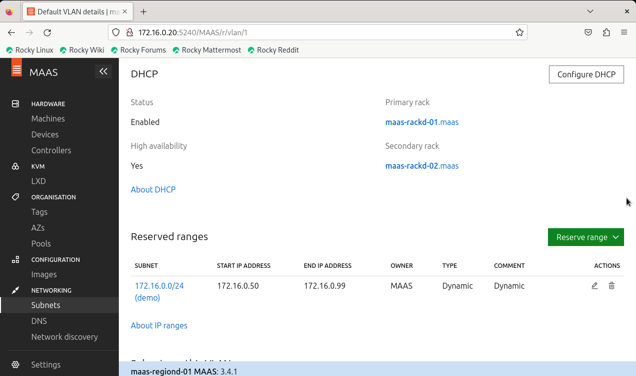

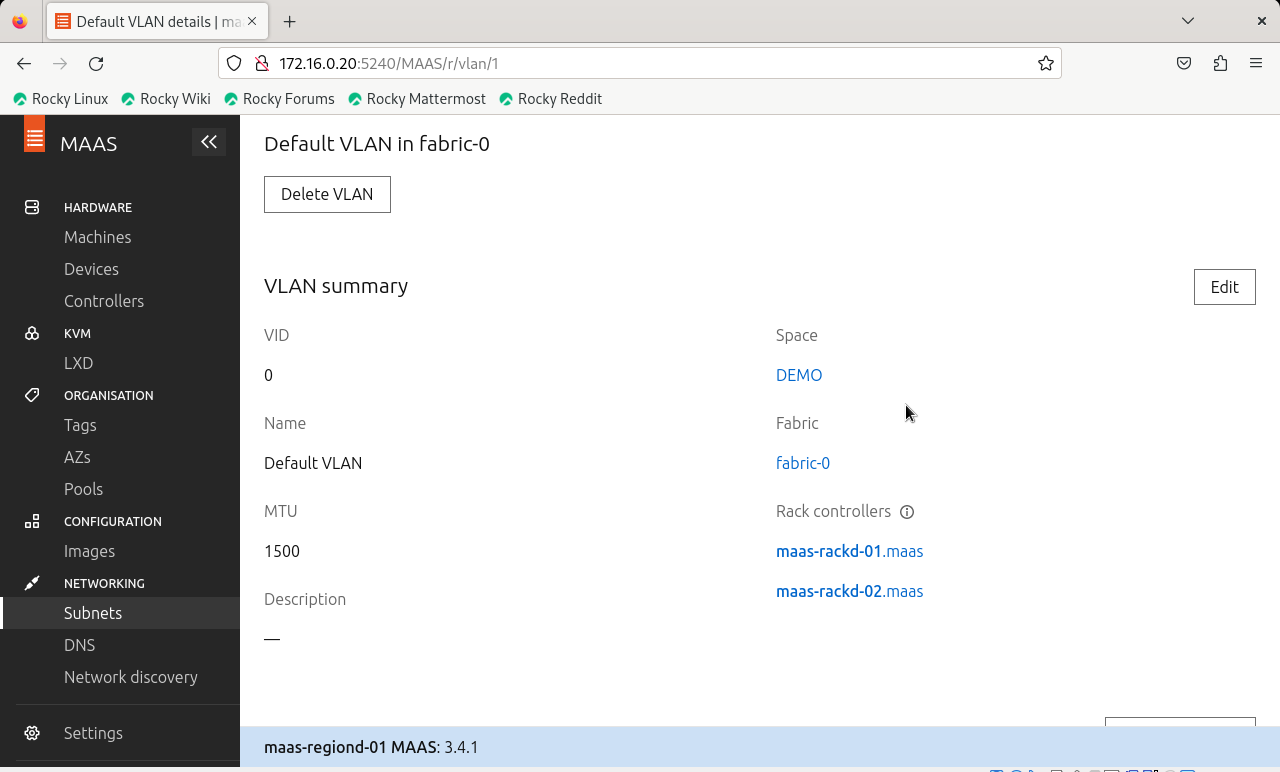

The vlan are configured to use two rackd as follow:
When the “maas-rackd-01” are working, everything works as well, If I do a hard shutdown on rackd-01, the pxe boot stop to work.

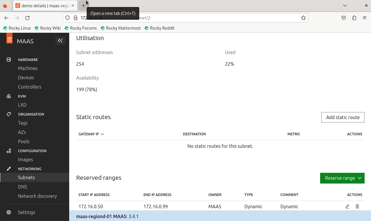

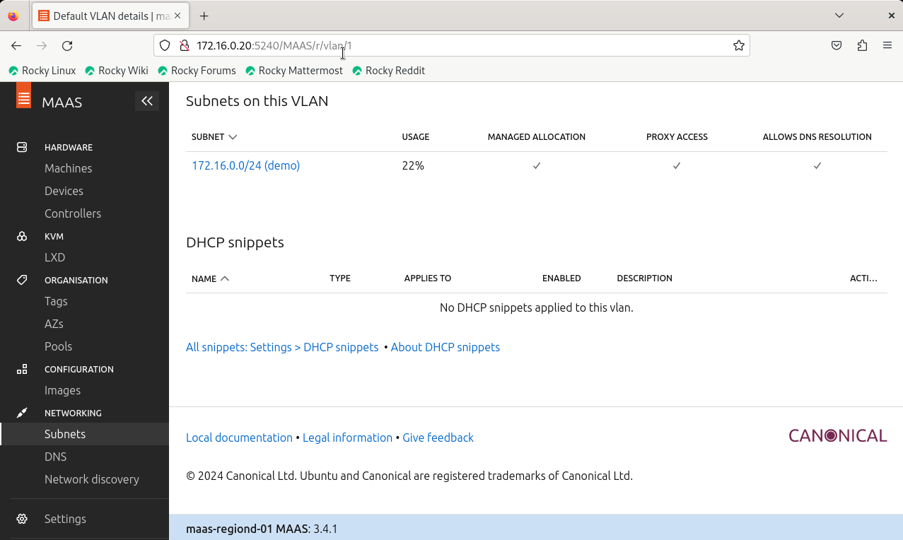

You understanding is correct. If one rack goes away the other one should take over. However, you must allow DNS resolution on the subnet. Can you send a screenshot of the entire page of the subnet and the output of http://maas_ip:5248/MAAS/metadata/latest/enlist-preseed/?op=get_enlist_preseed ?

Screenshot of subnet page:
Sorry about the lot of screenshots. I’m using a jumpbox who has a small screen :frowning:
Your subnet has 8.8.8.8 as DNS server. This will force MAAS to use IP addresses for the racks (as you can see in the preseed output I asked you to extract), which means that your setup can’t work in HA mode.
If you remove the DNS server setting, MAAS will use a domain name for the racks and you your env should work in HA mode.
