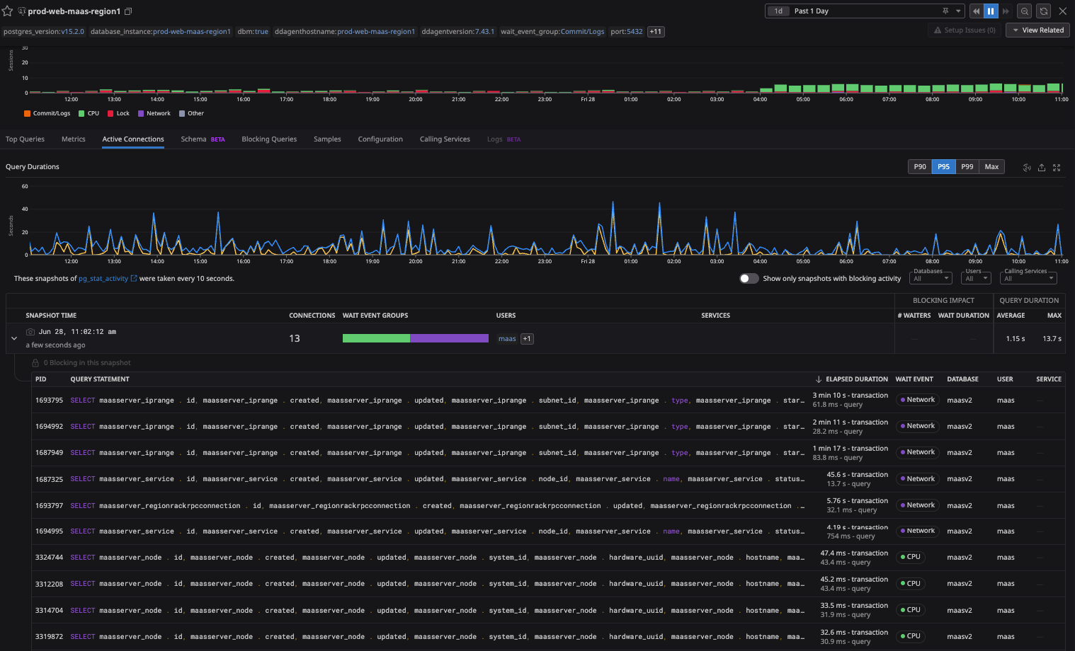

We had this problem of high CPU usage by regiond and postgres, and as maas was not stable, we decided to roll back to the previous version that was, but now it started showing this query behavior

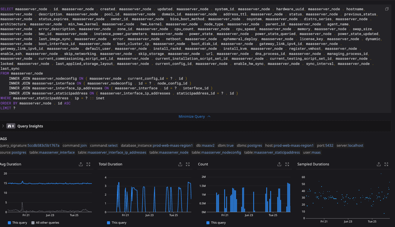

So do we need to take any action? because the problem is still happening from time to time as you can see in the screenshot below.
