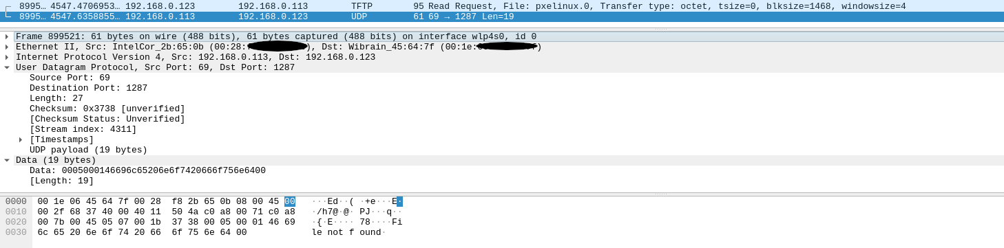

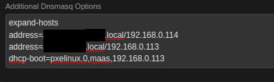

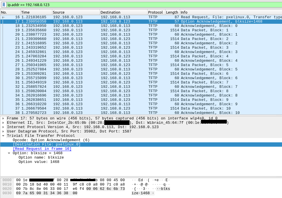

My setup is region+rack combo with a external DHCP, I have ensure that client machine is able to reach the MAAS tftp using wireshark.
Looking at the logs I’m seeing 404 related to the pxelinux.0 which is also shown in the wireshark “file not found”.

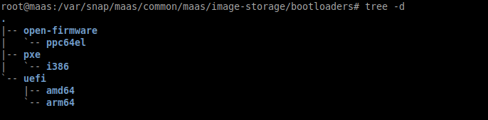

#root@maas:/var/snap/maas/common/maas# maas admin boot-resources read | jq -r '.[] | "\(.name)\t\(.architecture)"'
grub-efi-signed/uefi amd64/generic
grub-efi/uefi arm64/generic
grub-ieee1275/open-firmware ppc64el/generic
pxelinux/pxe i386/generic
ubuntu/jammy amd64/ga-22.04
ubuntu/jammy amd64/ga-22.04-lowlatency
ubuntu/jammy amd64/hwe-22.04
ubuntu/jammy amd64/hwe-22.04-edge
ubuntu/jammy amd64/hwe-22.04-lowlatency
ubuntu/jammy amd64/hwe-22.04-lowlatency-edge
