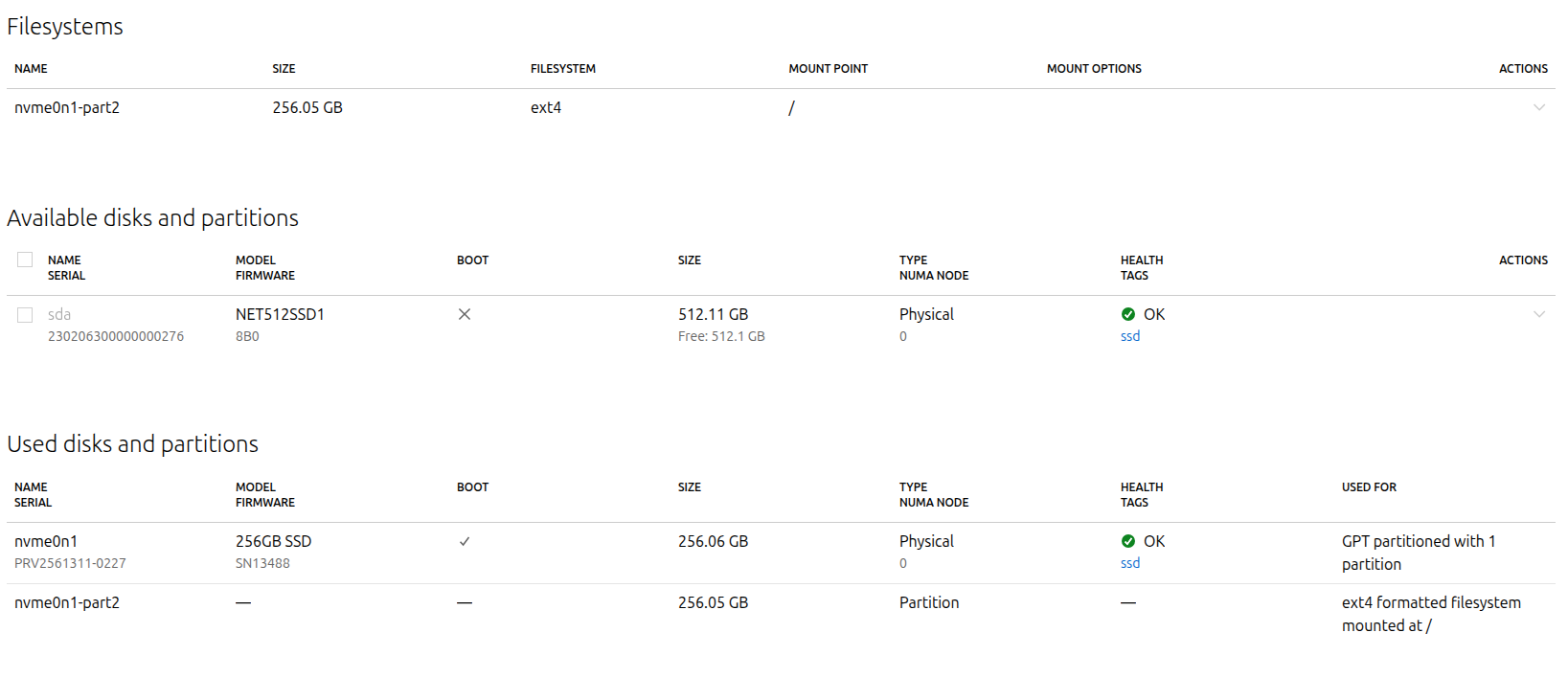

The operating system is correctly installed on /dev/nvme0n1.
The /dev/sda disk is not marked as boot and has no partitions, as shown in the MAAS Storage screen:

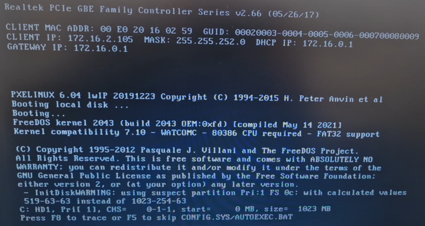

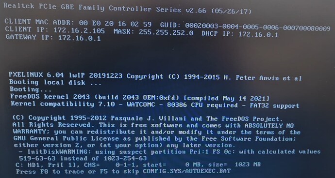

After the OS is installed and the system reboots, the server starts via PXE.
PXE then displays something like “booting from local disk” and loads /dev/sda instead of /dev/nvme0n1.
This results in an endless boot loop, as the SATA disk has no valid OS.
To confirm the issue, I manually installed FreeDOS on /dev/sda. After reinstalling the OS via MAAS, PXE booted into FreeDOS — proving that the PXE fallback is loading the wrong disk.

This is weird according to your screenshot. MAAS should have wiped that disk, so you would not boot into that OS
