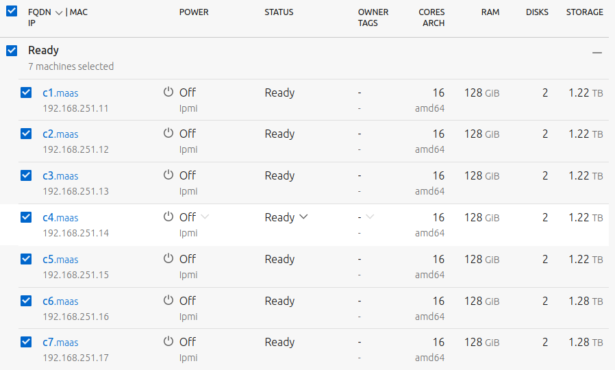

In our team, we are planning to implement MAAS into our production. So, we have set up a test environment for this. but there is one thing that I don’t understand, when deploying an OS on multiple machines at once (or sometimes just one) it get stuck on status “powering on”. The machine has actually already began to PXE boot and is able to transfer two files bootx64.efi and grubx64.efi. The machine then get stuck at Grub shell and when i manually reboot it and the PXE boot starts, everything is working as expected.
In the test environment we got 1x Maas controller/region/rack and 7x nodes. PXE network is isolated and runned by Maas. I have only tried implementing Ubuntu 20.04/22.04 as this is the OS’s we are going to run in the end. BIOS is configured to only have the specific ethernet PXE boot priority (tried without disabling the rest), UEFI only (have tried both) and BMC/IPMI network configuration.
