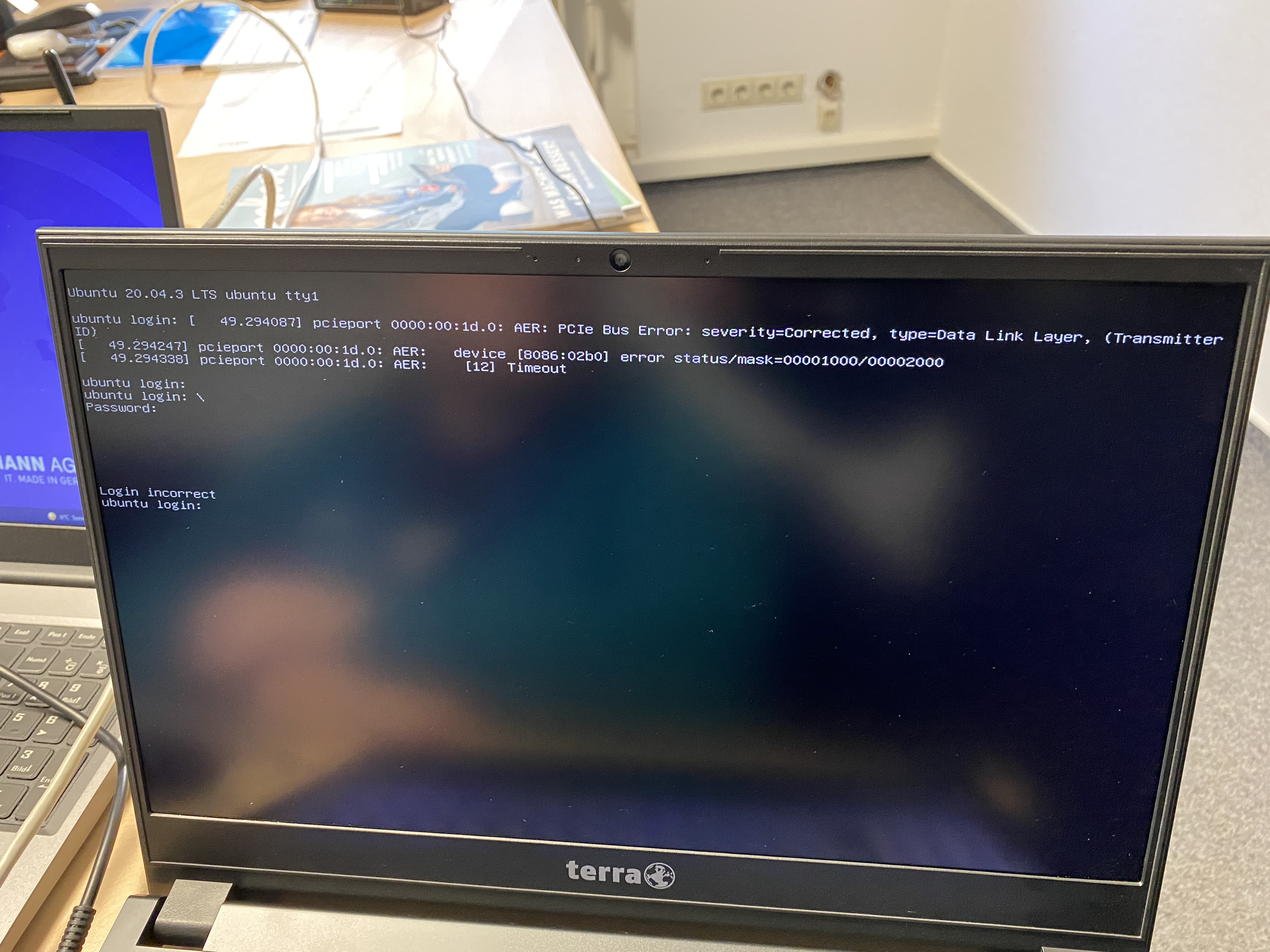

Hello Guys,
My plan is to install Windows and also Ubuntu to devices over PXE.
I am new to maas.io and just started. I did a little testbuild to test out features and try to boot and install ubuntu over pxe onto a laptop which is capable to pxe boot.
I did build a tiny network with one 5-Port Gigabit Switch, a nuc (maas.io is installed on there in region+rack mode), and a laptop.
DHCP is enabled and the Ubuntu Image is synced. When i boot over PXE, the Datatransfer stops after about 100Kbytes. The little Box in the right corner says “-stalled-”.
I tried to leave it on for about 1 Hour which did not do anything good.
I tried to re initiate the Bootprocess which ended in stalling the Datatransfer at about 1Mbyte.
When screenshots need to be provided so someone can help me, tell me what i need to do. And is there any kind of log which i can provide so everybody is able to see what i did right and/or wrong ?
English is not my first language, so i hope you guys understand me =). If you need more info or i need to clarify something, please tell me.
Thanks, cya =)

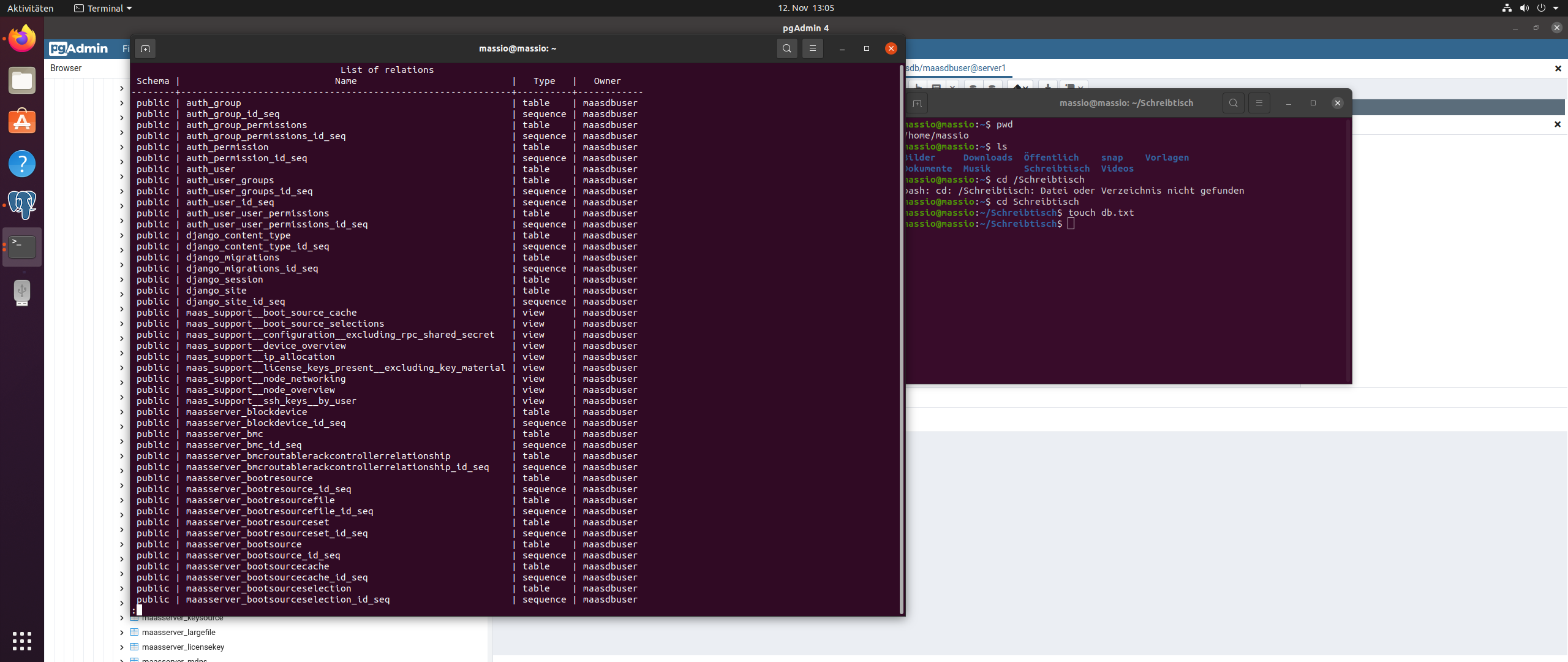

Here are the Log from regiond:
2021-11-10 15:34:26 twisted.scripts: [info] twistd 18.9.0 (/snap/maas/15003/bin/python3 3.8.10) starting up.
2021-11-10 15:34:26 twisted.scripts: [info] reactor class: twisted.internet.asyncioreactor.AsyncioSelectorReactor.
2021-11-10 15:34:26 maasserver.start_up: [error] Database error during start-up
  File "/snap/maas/15003/usr/lib/python3/dist-packages/django/db/backends/utils.py", line 84, in _execute
    return self.cursor.execute(sql, params)
psycopg2.errors.UndefinedTable: relation "maasserver_config" does not exist
LINE 1: ..._config"."name", "maasserver_config"."value" FROM "maasserve...
The above exception was the direct cause of the following exception:
  File "/snap/maas/15003/lib/python3.8/site-packages/maasserver/start_up.py", line 64, in start_up
    yield security.get_shared_secret()
  File "/snap/maas/15003/usr/lib/python3/dist-packages/twisted/python/threadpool.py", line 250, in inContext
    result = inContext.theWork()
  File "/snap/maas/15003/usr/lib/python3/dist-packages/twisted/python/threadpool.py", line 266, in <lambda>
    inContext.theWork = lambda: context.call(ctx, func, *args, **kw)
  File "/snap/maas/15003/usr/lib/python3/dist-packages/twisted/python/context.py", line 122, in callWithContext
    return self.currentContext().callWithContext(ctx, func, *args, **kw)
  File "/snap/maas/15003/usr/lib/python3/dist-packages/twisted/python/context.py", line 85, in callWithContext
    return func(*args,**kw)
  File "/snap/maas/15003/lib/python3.8/site-packages/provisioningserver/utils/twisted.py", line 870, in callInContext
    return func(*args, **kwargs)
  File "/snap/maas/15003/lib/python3.8/site-packages/provisioningserver/utils/twisted.py", line 202, in wrapper
    result = func(*args, **kwargs)
  File "/snap/maas/15003/lib/python3.8/site-packages/maasserver/utils/orm.py", line 706, in call_with_connection
  File "/snap/maas/15003/lib/python3.8/site-packages/maasserver/utils/__init__.py", line 194, in call_with_lock
  File "/snap/maas/15003/lib/python3.8/site-packages/maasserver/utils/orm.py", line 751, in call_within_transaction
    return func_outside_txn(*args, **kwargs)
  File "/snap/maas/15003/lib/python3.8/site-packages/maasserver/utils/orm.py", line 554, in retrier
  File "/usr/lib/python3.8/contextlib.py", line 75, in inner
    return func(*args, **kwds)
  File "/snap/maas/15003/lib/python3.8/site-packages/maasserver/security.py", line 78, in get_shared_secret_txn
    secret_in_db_hex = Config.objects.get_config("rpc_shared_secret")
  File "/snap/maas/15003/lib/python3.8/site-packages/maasserver/models/config.py", line 169, in get_config
    return self.get(name=name).value
  File "/snap/maas/15003/usr/lib/python3/dist-packages/django/db/models/manager.py", line 82, in manager_method
    return getattr(self.get_queryset(), name)(*args, **kwargs)
  File "/snap/maas/15003/usr/lib/python3/dist-packages/django/db/models/query.py", line 402, in get
    num = len(clone)
  File "/snap/maas/15003/usr/lib/python3/dist-packages/django/db/models/query.py", line 256, in __len__
    self._fetch_all()
  File "/snap/maas/15003/usr/lib/python3/dist-packages/django/db/models/query.py", line 1242, in _fetch_all
    self._result_cache = list(self._iterable_class(self))
  File "/snap/maas/15003/usr/lib/python3/dist-packages/django/db/models/query.py", line 55, in __iter__
    results = compiler.execute_sql(chunked_fetch=self.chunked_fetch, chunk_size=self.chunk_size)
  File "/snap/maas/15003/usr/lib/python3/dist-packages/django/db/models/sql/compiler.py", line 1140, in execute_sql
  File "/snap/maas/15003/usr/lib/python3/dist-packages/django/db/backends/utils.py", line 67, in execute
    return self._execute_with_wrappers(sql, params, many=False, executor=self._execute)
  File "/snap/maas/15003/usr/lib/python3/dist-packages/django/db/backends/utils.py", line 76, in _execute_with_wrappers
    return executor(sql, params, many, context)
  File "/snap/maas/15003/usr/lib/python3/dist-packages/django/db/utils.py", line 89, in __exit__
    raise dj_exc_value.with_traceback(traceback) from exc_value
django.db.utils.ProgrammingError: relation "maasserver_config" does not exist
2021-11-10 15:34:29 maasserver.start_up: [error] Database error during start-up
psycopg2.errors.UndefinedTable: relation "metadataserver_script" does not exist
LINE 1: ...server_script"."apply_configured_networking" FROM "metadatas...
  File "/snap/maas/15003/lib/python3.8/site-packages/maasserver/start_up.py", line 68, in start_up
    yield deferToDatabase(inner_start_up, master=master)
  File "/snap/maas/15003/lib/python3.8/site-packages/maasserver/start_up.py", line 114, in inner_start_up
    load_builtin_scripts()
  File "/snap/maas/15003/lib/python3.8/site-packages/metadataserver/builtin_scripts/__init__.py", line 209, in load_builtin_scripts
    script_in_db = Script.objects.get(name=script.name)
    num = len(clone)
    self._fetch_all()
django.db.utils.ProgrammingError: relation "metadataserver_script" does not exist
2021-11-10 15:34:32 maasserver.start_up: [error] Database error during start-up

If you connect to the db, do you see a bunch of maasserver_* tables (e.g. maasserver_config) in it?
Sorry, but how do i exactly connect to the db ?
sudo -u postgres psql maasdb should do.
then \d from the psql shell will show the tables in the db.
That helped, thanks.
Yes there are quite a few listings for “maas”.
Here is a picture

I used chmod on the database directory and now i have a whole other screen. Much appreciated.
