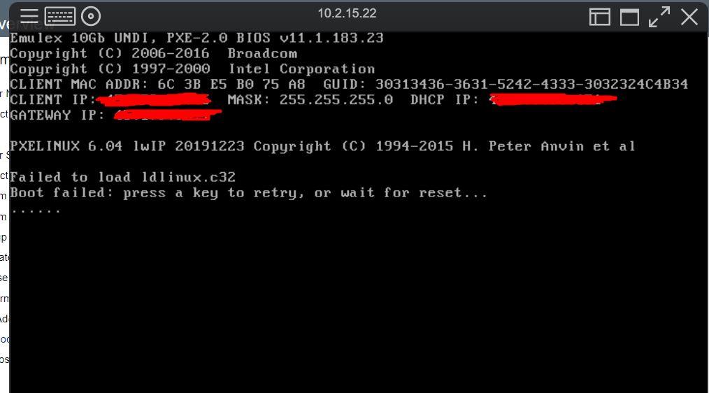

I have a problem when commissioning a machine with MAAS 3.3.4. I saw that some people already faced similar problems, but didn’t post a solution.
This is a BL460c Gen8 server and HP FlexFabric 10Gb 2-port 554FLB Adapter.

It could be that you have both MAAS DHCP and external DHCP server. According to your screenshot external one sends DHCP Offer first, so machine is not booted towards MAAS actually.

It looks like the machine is getting the IP XX.XXX.XX.45 from the non-MAAS DHCP server as @troyanov pointed out. In order to ensure this is the root of the problem, could you turn off (or just unplug) the machine that has the DHCP server and retry?
On the PXE screen it correctly shows the MAAS IP as the DHCP IP.
After disabling the other DHCP server still continues.
In the logs it is also possible to see the TFTP request with lpxelinux.0, but after that it does not proceed.
