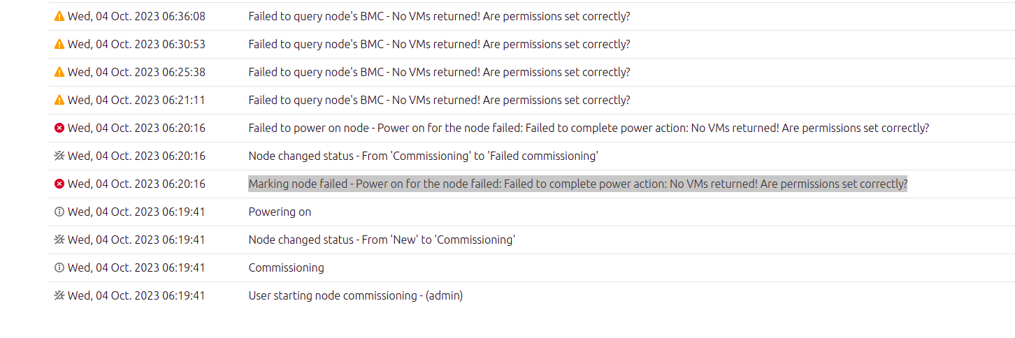

I am trying to provision and deploy a Proxmox vm by MaaS. VM was able to PXE boot by MaaS and able to deploy Ubuntu 20.04 LTS image- with power management type as manual. My Mass Vm is in proxmox itself.
I heard that Maas supports power management type as proxmox and i tried that and it was not working for me. All the permissions are added correctly along with proxmox api key. Is this a limitation of the Proxmox power driver in Maas or do i have to install any proxmox driver that allows maas. - https://coldnorthadmin.com/posts/maas_proxmox_power/
I am attaching the event log.

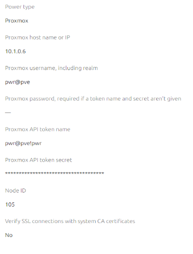

Check that the token name contains the login realm. I could not get it to work without this despite the documentation saying that it should not be included. I did put in a pull request for this to be amended.
For me it looks like this:

I added Just like in the screenshot the you have shared. Still not working! Have you done any configuration changes in MAAS. ?
Thankyou
No configuration changes in MAAS. I am using version 3.4.0~rc1.

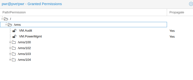

The other thing to check is that your API token has the right permissions to your VM tree. It should look something like this:
Also make sure that you have set the right VM Node ID number in the MAAS machine power type config. In my screenshot it is 105 but this must match the VM that you are working with.
