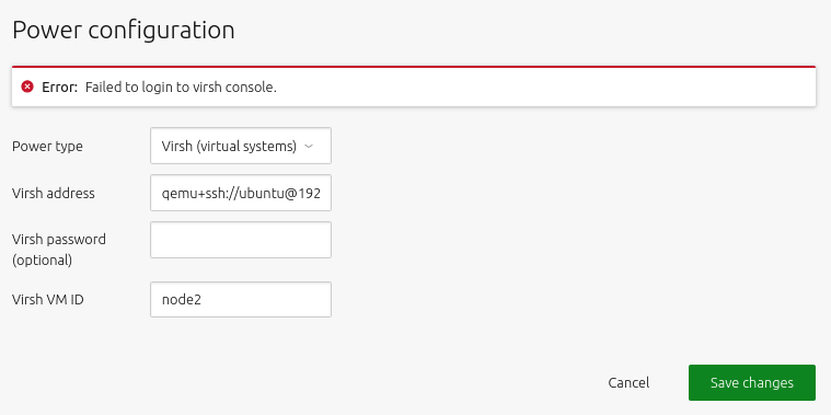

Virsh power type (UI)
Consider a machine backed by VM. Below, a ‘Power type’ of Virsh
has been selected, and the ‘Power address’ of qemu+ssh://ubuntu@192.168.1.2/system
has been entered (replace values as appropriate). The value of ‘Power ID’ is the VM domain (guest) name, here node2
Pro tip: The machine’s hostname – according to MAAS – is a randomly chosen string (here dear.ant
). You should change this hostname to something descriptive, that helps you remember why this machine is in your MAAS network.
