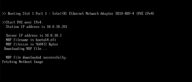

Just an update on Oracle Linux. Updated Maas to version 3.5.1 as mentioned here:
But still had errors when deploying OL: Oracle Linux 8 and 9 not being deployed
