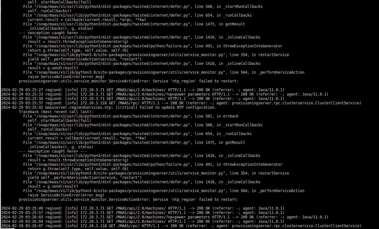

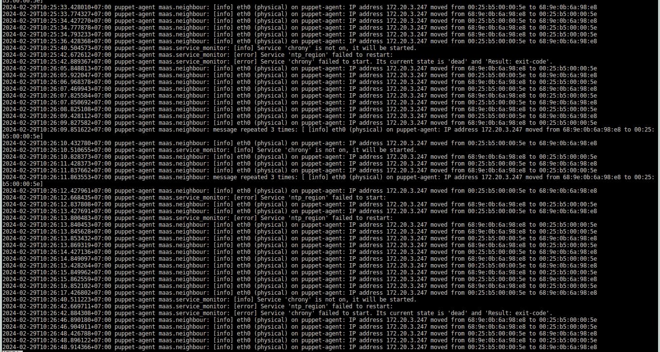

I am using Maas snap version 3.1.2. After installation, ntp crashed and could not be run. I have turned off all other ntp and chronyd services.
I have attached the error description in the attached images.
