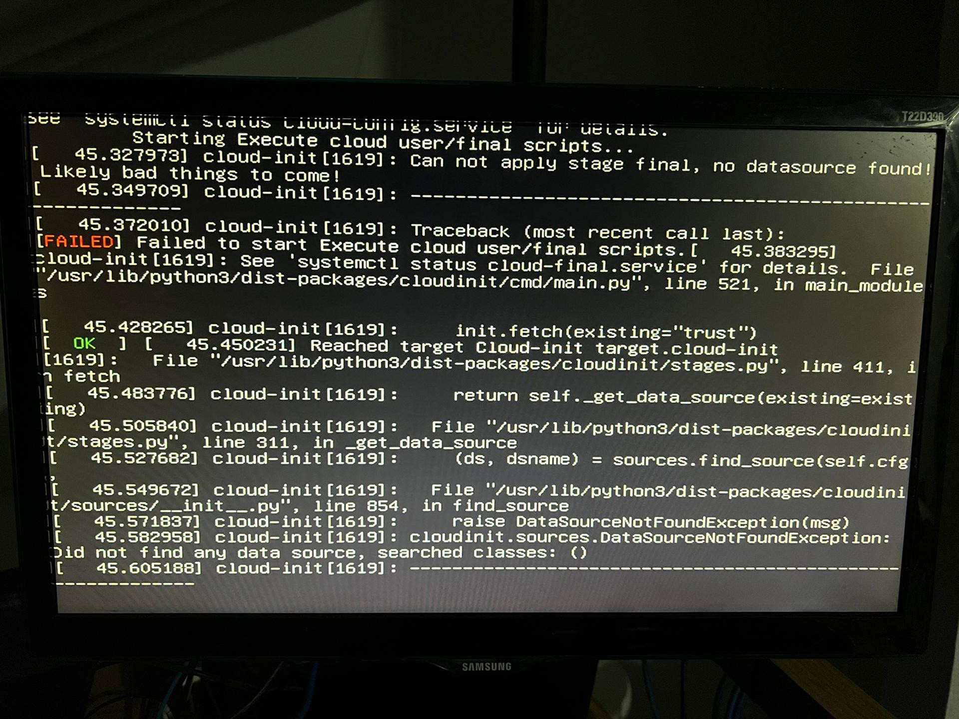

I’ve installed maas latest version with the test-db on a laptop here and I’m testing in my personal lab to get two servers enlisted into maas.
I have an Dell R610 and a Dell R810, for some reason, R810 worked fine, showed up on maas I was able to commission and then deploy.
On the other hand the R610 is not even showing up to be commissioned.
Upon checking the server, this was the message:
I’m not sure what’s up, I tried accessing the the node through SSH but I wasn’t able, maybe the maas didn’t deploy the ssh key idk, but I essentially cannot see any logs besides that one.

So it seems like this error is not impacting MAAS somehow, after days without touching the servers it showed up for commissioning, I rebooted it to check and it’s still showing the same error but now somehow it’s available for commissioning…
Anyone knows how we could debug this to get more info about it? just to prevent future issues I guess

I still cannot fully believe… but I found the issue… a super wierdly faulty ethernet cable or patch (haven’t debugged yet the exact point of failure)
I’m not sure if it was the ethernet cable or the patch panel but somewhere somehow… it was getting an IP and connecting nicely, I could even access the iDRAC, it would boot to the iso from MAAS and then it would drop the connection somehow.
How it happened that it worked only for boot and then dropped the connection I still cannot understand at all but I just tried using the cables from R810 and it just worked first try, no issues…
