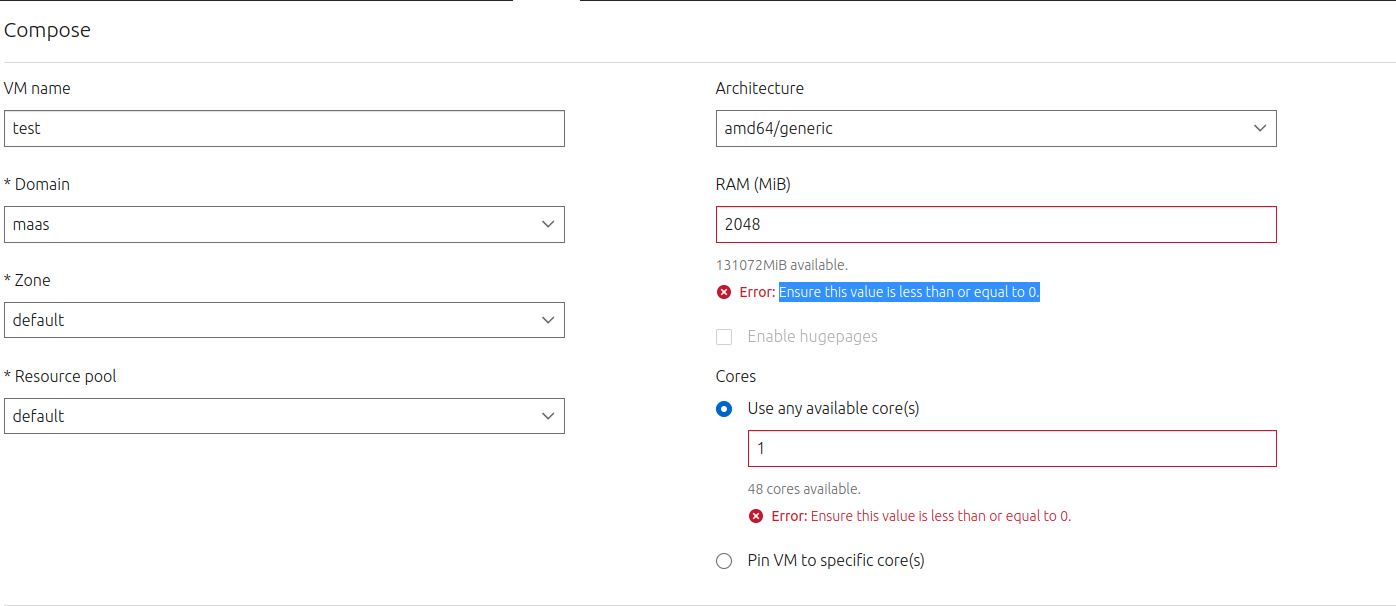

Trying to create VM in an LXD host. Even if there are a lot of memory and cores, it will not accept it.
The host NIC is configured in bridge with OVS

Also inside MAAS Postgres DB cores,memory are set to zero. I tried to manually update the row in the DB but it didn’t work.
I follow the doc with recommends doing lxd init from the command line
