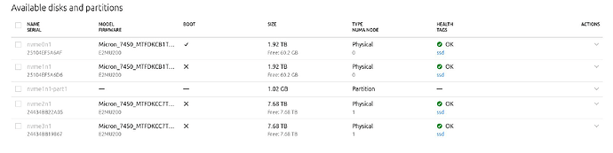

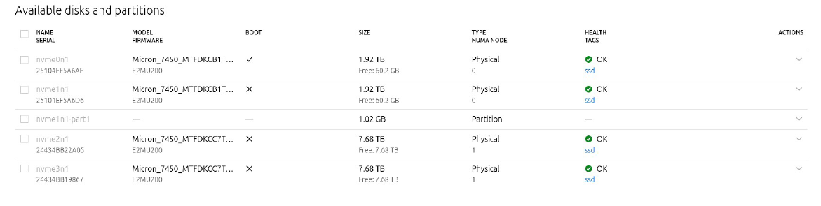

Hi Everyone so we started installing an OS on an Mdraid. After deployment we observed that we have missing disk. Please note that there are 5 disks in the disk column instead of 6
These servers are experiencing problems with the one 1.92 TB disk.
After the commission we are missing disk There should be two NVME 1.92 TB drives. This is set also in UEFI Shell
May we know what we need to check? to correct this issue
