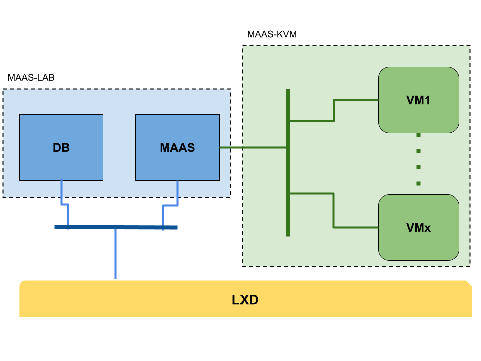

How to run a LXD container-based MAAS lab using an lunar host

Create a network for the control plane (MAAS, DB and KVM host):
lxc network create net-lab --type=bridge \
dns.domain=net-lab \
ipv4.address=10.0.1.1/24 \
ipv4.dhcp=true \
ipv4.dhcp.ranges=10.0.1.16-10.0.1.31 \
ipv4.nat=true \
ipv6.address=none
Create an un-managed network for the VMs:
lxc network create net-test --type=bridge \
ipv4.address=10.0.2.1/24 \
ipv4.dhcp=false

Containers
Create service containers in the project proj-maas
lxc project switch proj-maas
DB
This container is optional, you can use the maas-test-db snap instead (see bellow)
cat <<EOF | lxc launch ubuntu:jammy lab-db

Create MAAS container
lxc launch ubuntu:jammy maas-stable -p default -p prof-maas-lab

Configure the unmanaged network interface:
sudo tee /etc/netplan/99-net-test.yaml <<EOF
network:
version: 2
ethernets:
eth1:
addresses:
- 10.0.2.254/24
EOF
sudo netplan apply
