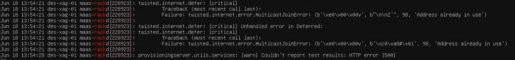

So far we have successfully connected a rack controller, but we notice that the network interfaces of our rack are not registered or discovered. I saw similar problems reported caused by MAAS beaconing not being able to work because of multicast issues (not being able to join a group) which seems necessary for network and interfaces reporting.
In our case this is explained by multicast not being supported by netbird so the beaconing error makes total sense.
I tried disabling the option with cli: set-config name=network_discovery value=disabled, but i still see the error pop (see capture) and interfaces are not refreshed.
So my question is: Is there a way to make network discovery on the rack work without relying on multicast ?
