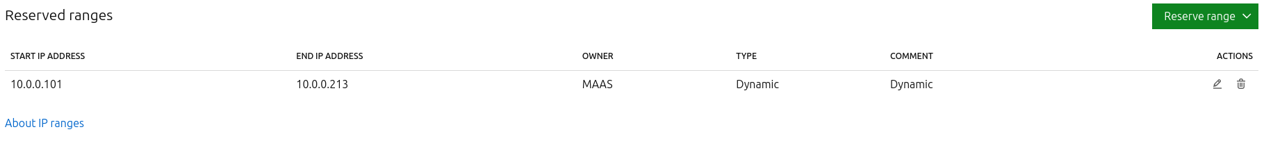

From this, I understand that if I have reserved (dynamic) range, e.g. like the screenshot below, nodes booting in MAAS would get IP addresses outside of this range (so, nothing between 10.0.0.101 and 10.0.0.213).

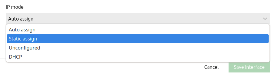

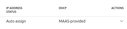

Another related question : it seems my non provisioned nodes get an “auto-assigned” IP address, but I can manually edit their networking settings to change this IP to a DHCP assigned one… What is the difference between these two modes ?

  1. Dynamic range: This range will be used during the commissioning or the enlistment stage. In particular, MAAS DHCP server will pick up an IP from this range to PXE boot the machine.
    Then, after the machine has been commissioned/enlisted
    1. If you set the IP mode of the machine to DHCP: MAAS will pick up an IP within a dynamic range also for the other stages (like deployment and when the machine is powered on).
    2. If you set the IP mode to Auto-IP: MAAS will use an IP outside the dynamic ranges.
    3. If you set the IP mode to Static-IP: you can use any IP address you want outside the dynamic range (but you can use an IP within a reserved range.). If you try to use an IP within the dynamic range, you’ll get an error.
  2. Reserved range: MAAS will never assign IPs within this range in any case, unless you use the Static-IP mode and you assign the machine an IP within this range.
