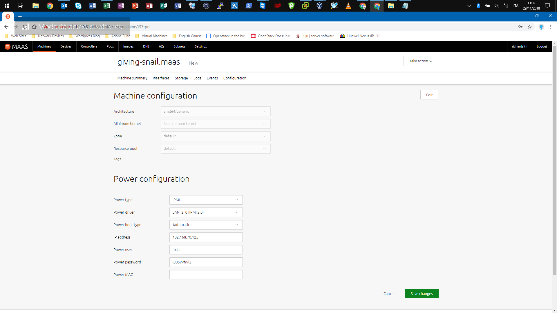

I’ve 4 IBM Server X3650 M4 and I’d like to manage them on my MAAS server but I don’t know how to set on MAAS their Power type (BMC).
What you see below is what I have on MAAS after the first boot, but if I try to run the commission the nodes not start and their status remain on New.

When a host is booted on a network which MAAS controls the machine goes into enlistment which gathers basic information about the system. If an IPMI, HP Moonshot, or Facebook Wedge BMC is detected MAAS creates its own user to interact with the BMC. It appears MAAS is detecting that the IBM Server X3650 M4 is using an IPMI BMC and has configured it with a MAAS username and password.
A rack controller must be on the same network as the BMC. You can test this by SSHing into the machine running the rack and executing the following command
$ ipmipower -s -D LAN_2_0 -h 192.168.70.125 -u maas -p l005vVhVl2
The MAAS logs may also provide more information, they are available in /var/log/maas

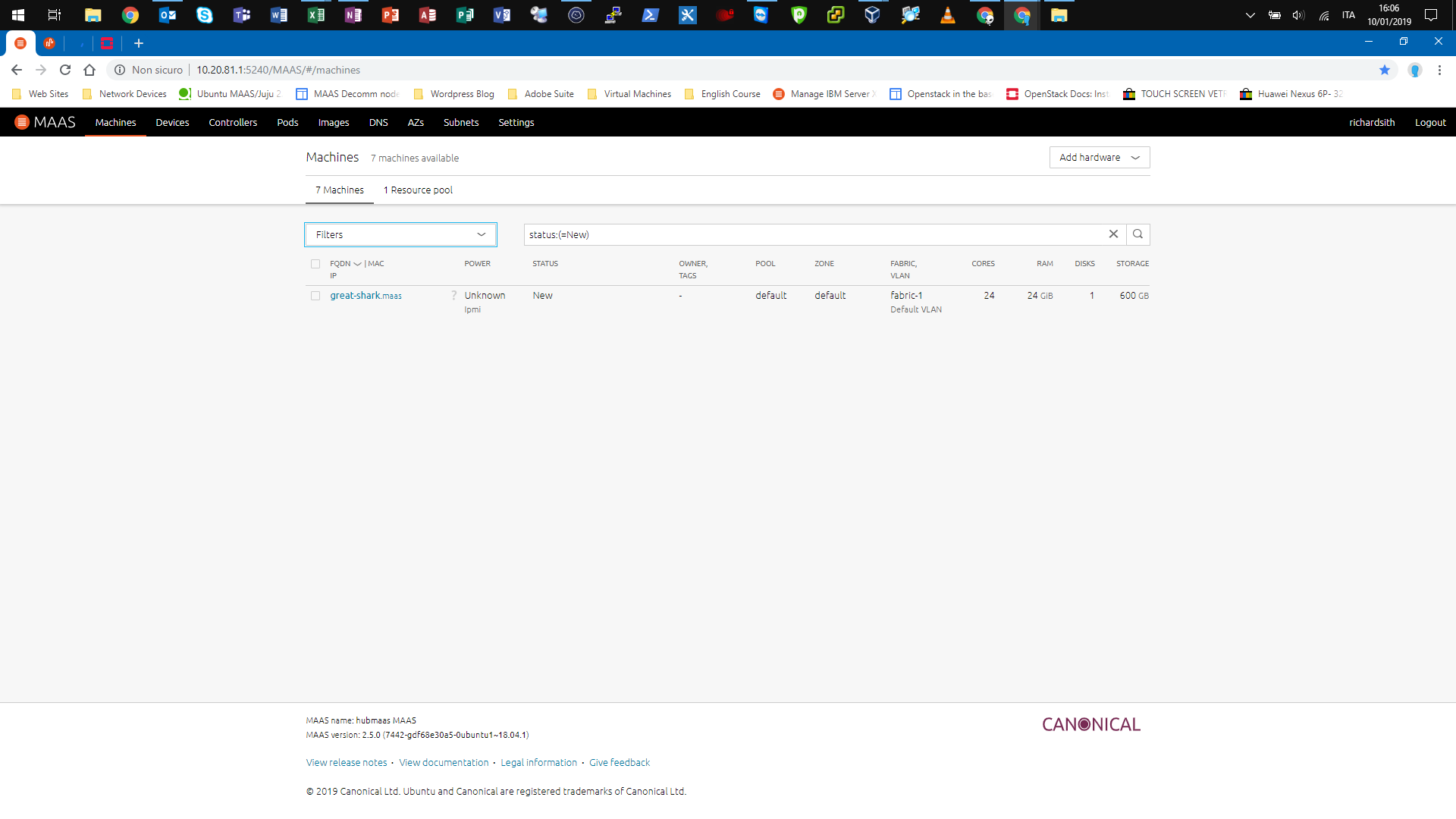

My issue is after that the node is enlistmented on MAAS, the node don’t start after I run the commission. it rest down.
Did the ipmipower command work? What do the MAAS logs show when you try to power on a machine? I suspect the BMC of your server is on a network MAAS does not have access to.

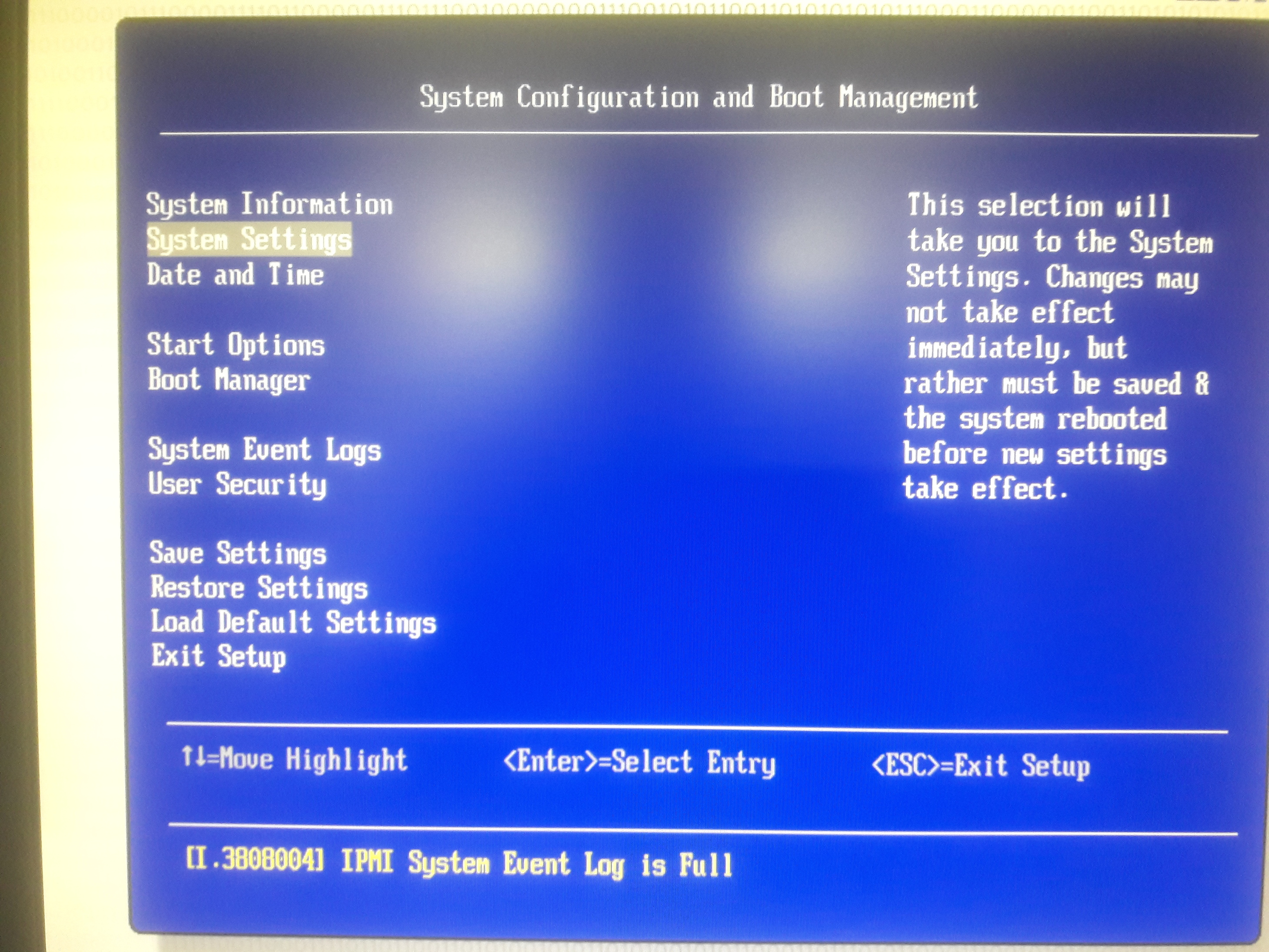

Ricardo- make sure the IPMI is enable in the IMM setting (bios), reboot the system (M3650 M4) and make sure the IMPI is enable in the IMM configuration, that can cause the maas not to power on/off the server. leet me know thanks
This is the result after I’ve made some sets on its Bios

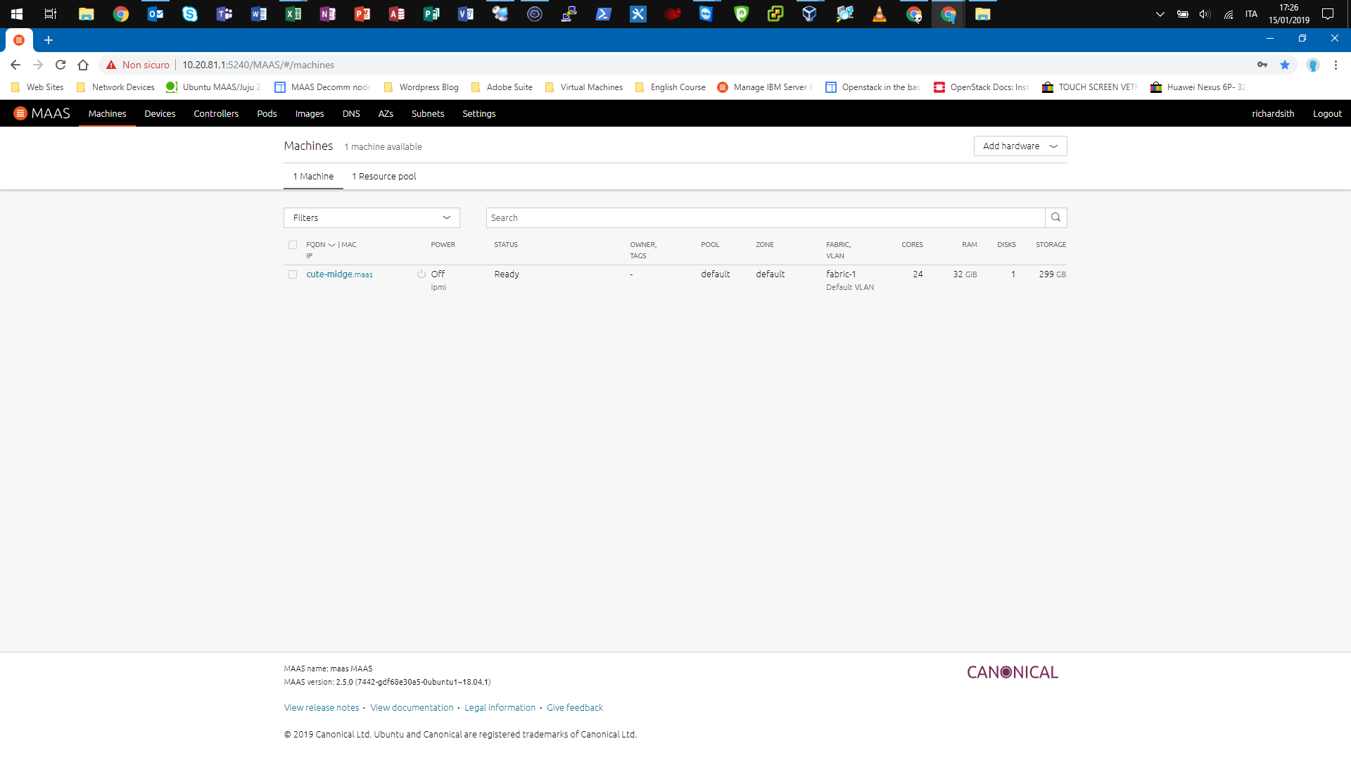

but I’m not sure all of that are correctly right, now on MAAS the node is in ready status. Soon I’ll post the screens of the bios and we can see if all sets are right.
From the screenshots you’ve posted it appears that power management should be working correctly. I would try deploying an operating system or commissioning again to verify.

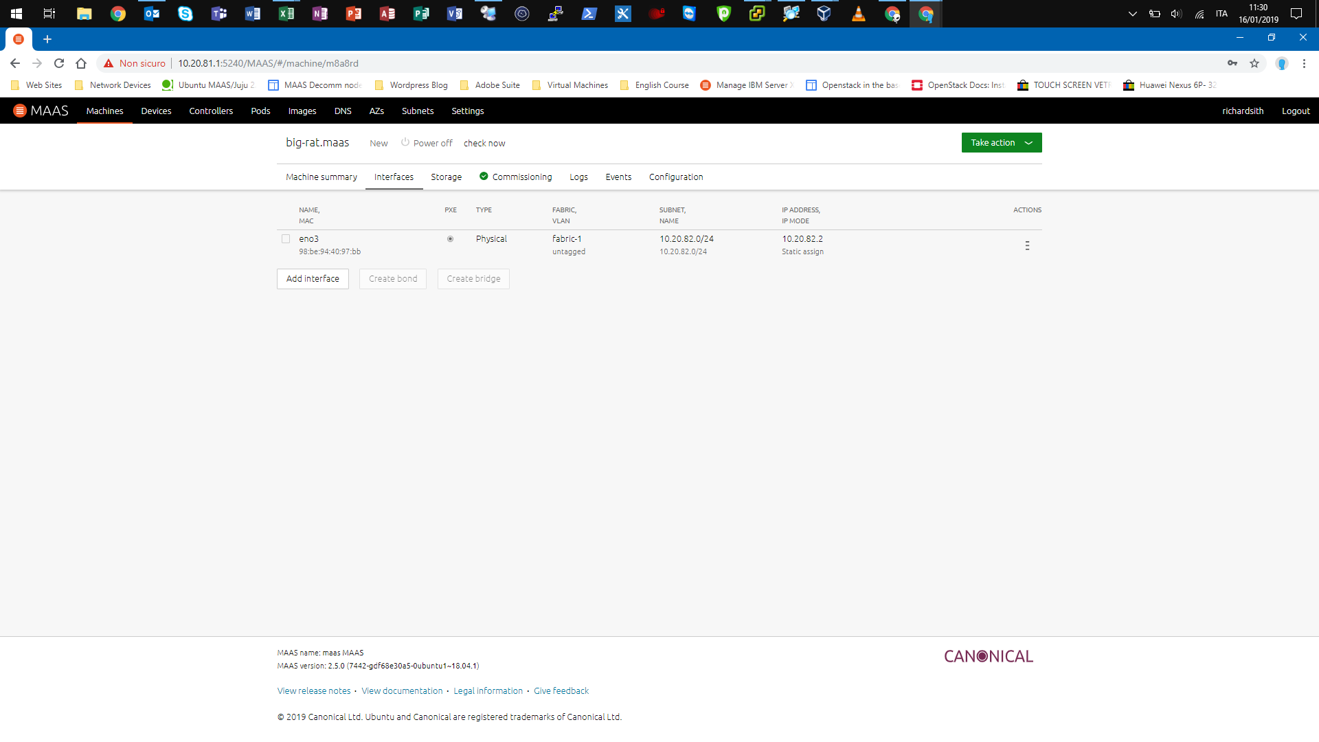

like that:
I’ve removed all interfaces and left the eno3 where is actived the DHCP.

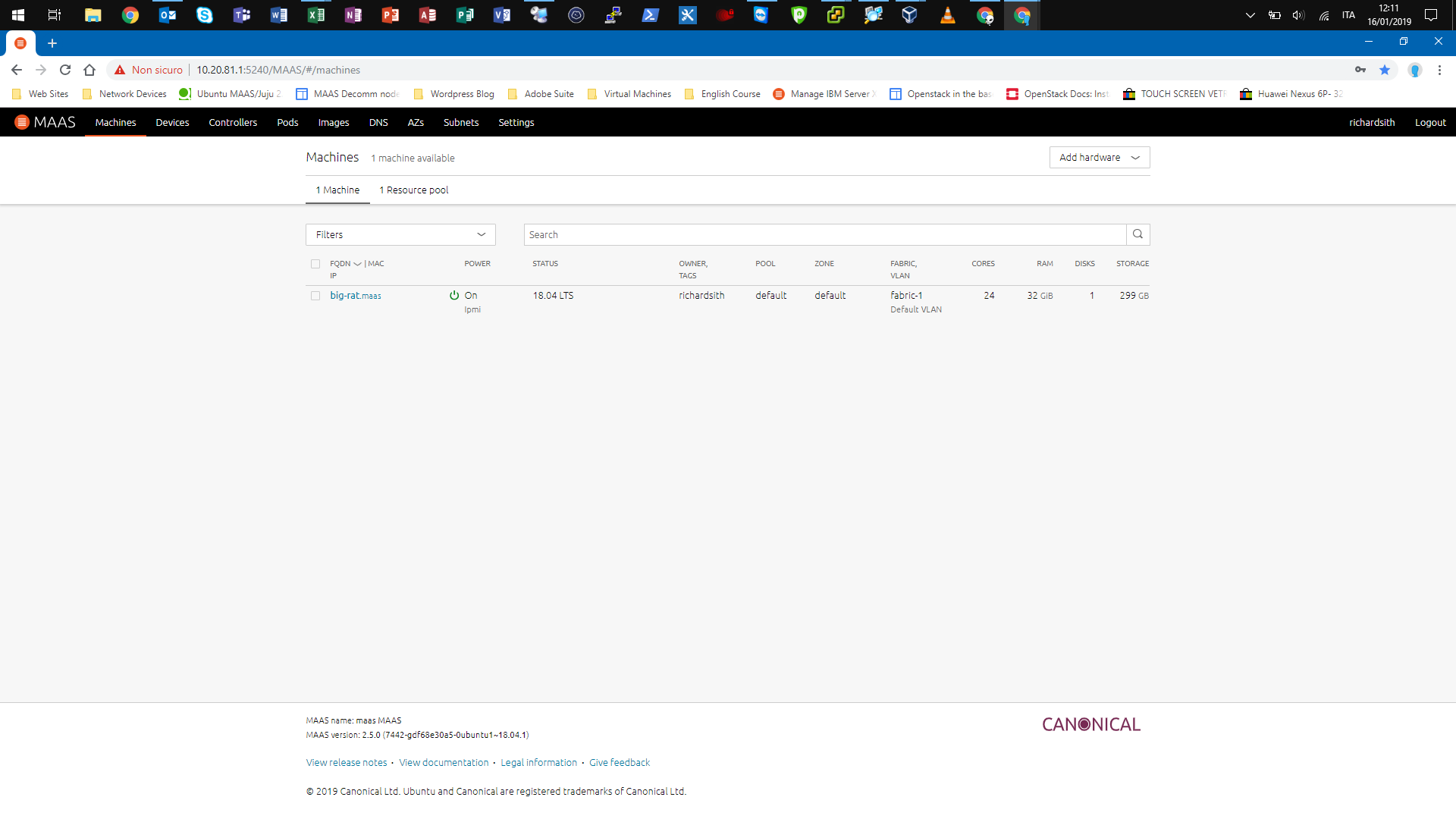

Ubuntu is deployed on IBM system M3650 M4 via Maas. To use a connection via ssh, do you know which are the credentials? thanks
these are the screens of the BIOS to set IPMI on IBM system x3650 M4
Ric,
Switch the shared option to dedicated and try to commission the box, everything else looks fine to me. Also disable the ip6 let us know thanks

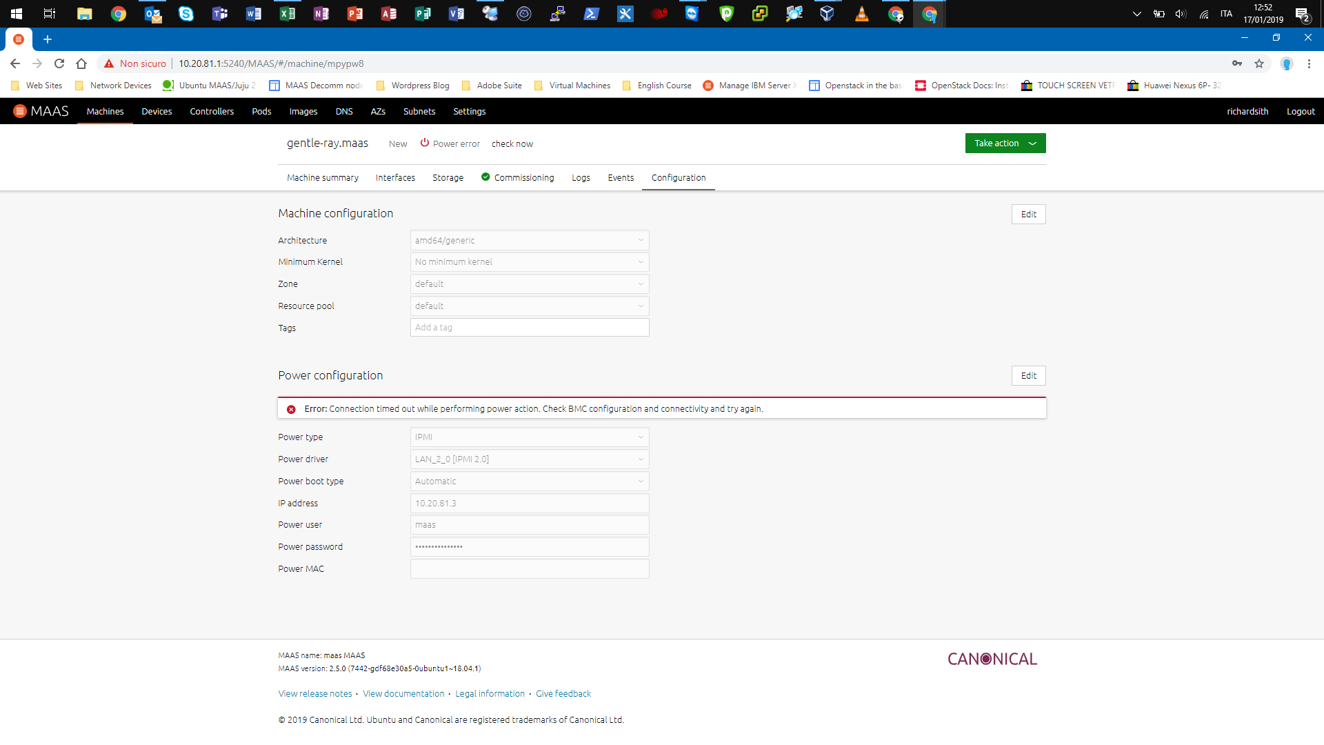

I’ve done that, but I’ve optained this error
Error: Connection timed out while performing power action. Check BMC configuration and connectivity and try again.
Ok Try this 1-delete the node, 2- poweron the node let come back to the maas under machines 3- commission the node. let us know thanks.
the same error…
my opinion: maybe there is a set to make on the Bios to indicate on which interface we want actived the IMM??? in this way the dedicated option is correct, if it is shared I think that the IMM address IP can be reached from each physical interface. no?
