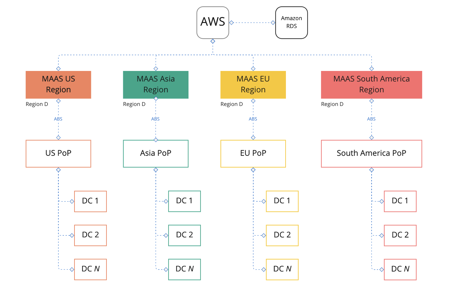

  • Using AWS as a Region controller
The first way our users set up MAAS aims to remove the need to manage Postgres themselves and create a semi-centralised MAAS setup by installing region controllers on AWS. In this example scenario, there are 4 MAAS instances distributed by 4 geographical locations in the world. So the MAAS instance acts as a PoP for all data centres and there are about 20-60 machines per data centre. In total they are managing around 200-500 machines per PoP.
One of the biggest pain points here is Image Management, especially, custom images.
The current way to manage images requires you to upload the images to the region, then the images will get served to RDS. From here, there is a synchronisation process between MAAS and RDS, so all the rack controllers in the PoP will have to download all the images back from that database. Then when you go into the next PoP, you need to go through the exact same step.
There are 2 problems here:
  1. Dealing with images is manual and redundant
  2. There is a lot of traffic of the same data being stored multiple times in the Database
Database cost in the cloud is expensive
