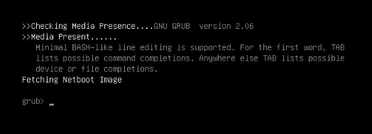

MAAS stuck on grub prompt during second reboot on deploy
I’ve been trying to get my arm64 servers deployed through MAAS and am running into an issue where it keeps getting stuck in grub on a prompt and requires manual intervention (reboot cmd via kvm). Once rebooted it seems to then proceed as it should.

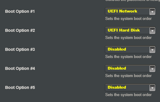

Are your machines set to UEFI? Is your MAAS ipmi boot type set to UEFI? These are my initial sanity checks when I run into this issue.
I believe it is already set to UEFI. MAAS also correctly set the power boot type as EFI when it commissions the machine.

I’m facing the same issue, and the machines are already configured to use UEFI. Is there a way to enable additional logging to help troubleshoot why it fails after the reboot?
does it fail with the same message on the screen?
It’s stuck at the grub prompt with a slightly different message, it shows that its trying to PXE boot and the last line is stuck at “Fetching Netboot Image”.
