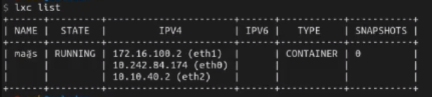

Suppose we have a LXD, with just one container running MAAS, like this:
This is what you see when you don’t specify a project, because LXD uses the concept of a default project. If you explicitly list the projects, you can see that what we were looking at is, indeed, the default project – but there are two other projects:
