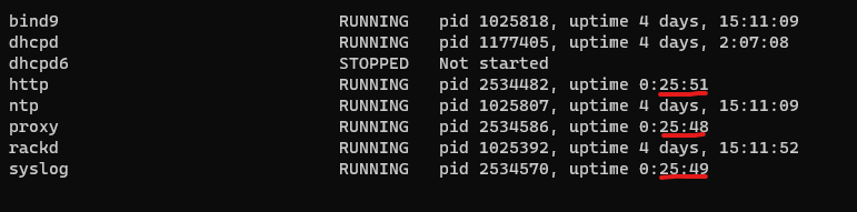

I’m noticing that some of my Deploys sometimes fails because the Deploy stuck in some steps, for example:
HTTP Request - /images/ubuntu/amd64/ga-22.04/jammy/stable/boot-initrd
or
Node installation - 'cloudinit' searching for network data from DataSourceMAAS
And I saw that this happens when some of MaaS services restarts.
Example of one Rack Controller status:
Is valid to say that sometimes just the proxy service restarts, but almost everytime its proxy, http and syslog restarting together.
