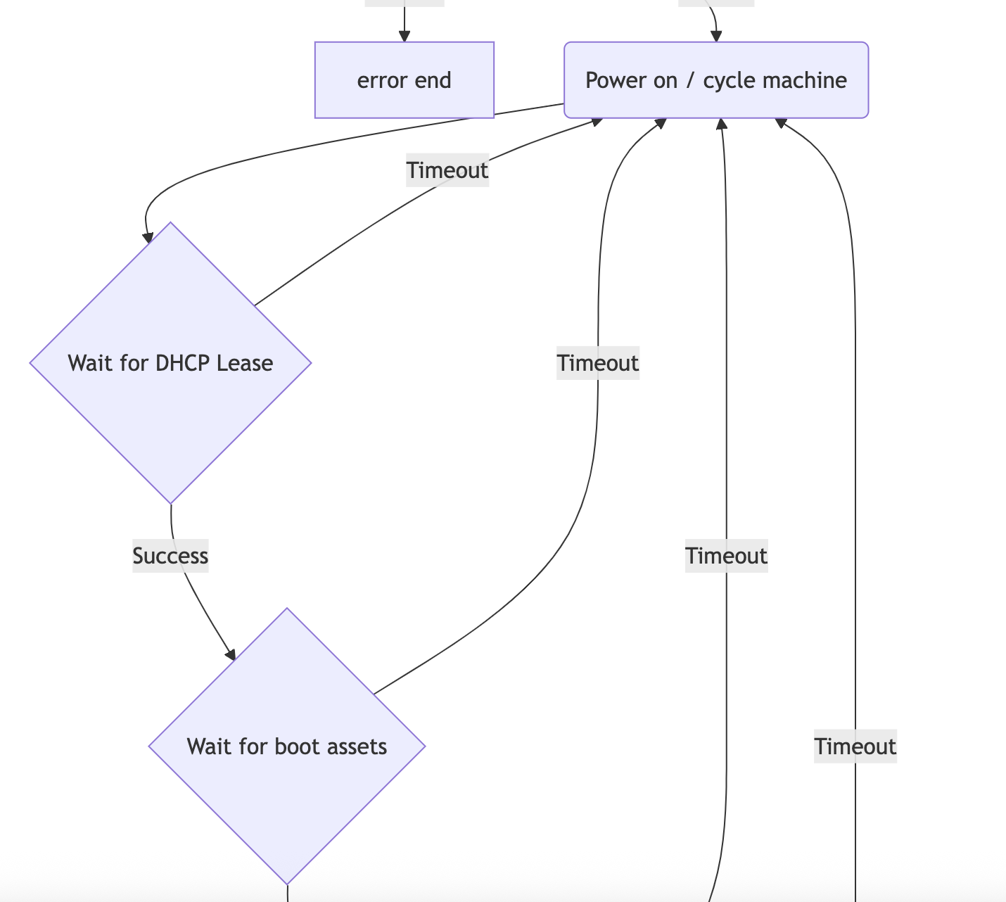

AMT Power driver is being smart by checking if the machine is already powered on, then it tells it to restart.
Combining the 2 issues together and you get machine that keeps restarting while deployment.
- MAAS is trying to power on a machine twice when deployment is started.
- AMT Power driver is trying to restart machine when MAAS is asking it to poweron and the machine is already powered on.
Looking at other power drivers, it seems like the expectation of the power driver is to restart the machine if its already powered on, so I take it that issue is with MAAS trying to power on the machine twice.
Please let me know if I am doing something incorrect.
