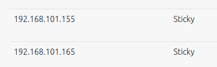

I have provisioned and deployed Openstack controller(Ubuntu 20.04) using MaaS. The IP mode of Controller interface(ens160) is set to Automatic(tried with static also). The Openstack controller correctly creates few lxd container and it uses the bridged interface to set the IP address of the containers. But when i browse through the subnet (fabric-0/untagged) of the interface(ens160) the type of the IP address of containers is reported as sticky instead of static.
However, if i enquire about the IP address type inside lxd container created in Controller machine it shows the type as static.

However, in the MaaS UI i can see the type of IP is set to sticky.
I will appreciate if anyone provides any insights on the issue.
