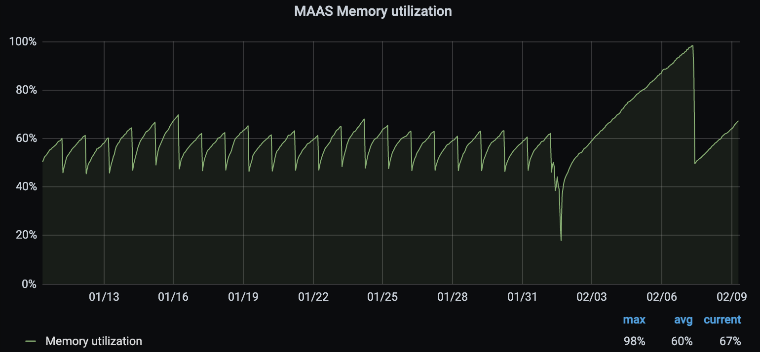

MAAS regiond allocates an increasing amount of memory
We discovered this when we stop with restart of MAAS regiond services every night for backup of DB.
I can see this behaviour both in 2.7 and after the upgrade to 2.9.1, upgraded 2021-02-01.
And after that we stoped restart of MAAS region services every night.
And it is only one of the regiond processes that use a increasing amount of memory.
After turning maas-metrics off in MAAS and removed it from Prometheus. Now memory consumption looks OK. Memory utilization is also evenly distributed across the MAAS python processes. So something is broken in Prometheus maas metrics.

Now it’s confirmed that every query to MAAS/metrics does allocate memory that is never released.

I have a case with Canonical support and they have observed the same behavior. So this will definitely be filed as a bug. This metrics is a good way to keep track of the MAAS environment. We use it for things like HW (machine) and subnet utilization in our HW cloude.
