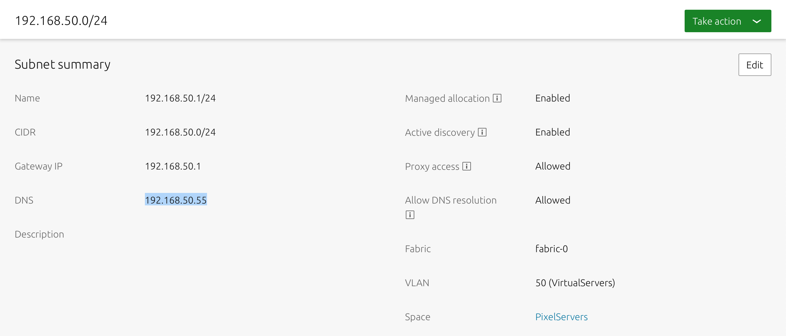

‘data source not found’ indicates that cloud-init is unable to reach MAAS’s metadata server. This is where cloud-init gets SSH keys and user_data. Make sure your machines have access to the MAAS DNS server or disable DNS on the subnet by settings Allow DNS resolution on the subnet to false.
I hope this helps somebody. I faced the same issue, and the problem was very simple.
You must be sure to specify a DNS IP in the Subnet Summary. If you enabled the “Allow DNS resolution” the DNS IP must be yours MaaS Region/Rack servers IP.
