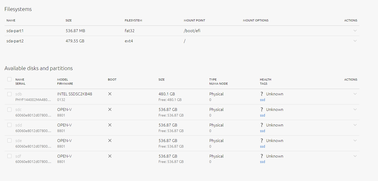

I have MAAS 3.1 deployed and I just booted my first server through MAAS and PXE. When I look at the storage configuration of the server I can see that MAAS didn’t recognize the Intel VROC RAID Configuration. Also, I have an storage LUN mapped to the server and MAAS doesn’t show any type of mapper for multipath.
Is there any way I can either create a custom script or make MAAS recognize the Multipath device and the VROC RAID Configuration? I’ll be using Ubuntu 20.04
can you use this guide to get us some logs? (no need to file a bug, yet, tho it might come to that later). we’d like to see what’s happening underneath when this fails. tia.
sorry about the super long time it took me to reply and I’m not sure if I should be replying to this topic at all (it has been almost 1 month) but I had a lot of different things to deal with while we transition from our current Openstack Cloud to a Charmed one. This is the paste bin file with the log of the node.
@carlosbravo, saw your bug and triaged it into the buglist. i’m going to close this entry as “bug filed,” but if we need to come back here and document the solution, we can.
