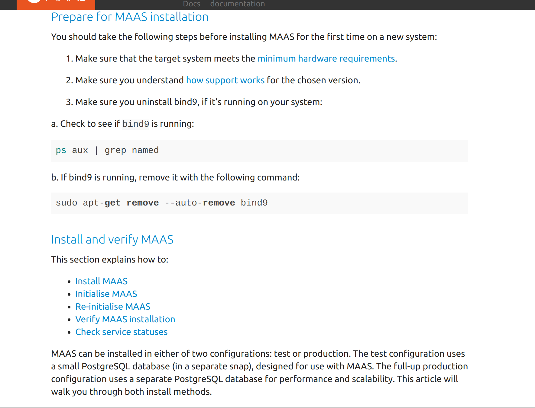

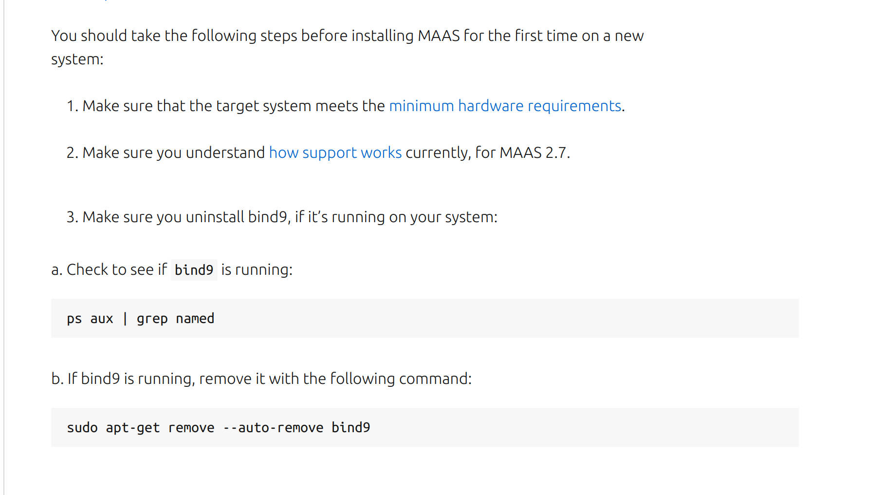

I am about to redo my server farm, which has about 30 machines managed by MAAS. Before I do this, I wanted to get some clarity on configuring the network settings properly, as I’ve always found this confusing, even if I try and follow the tutorials line for line. There seem to be some assumptions and/or missing information that I am missing.
I am using this as a reference:

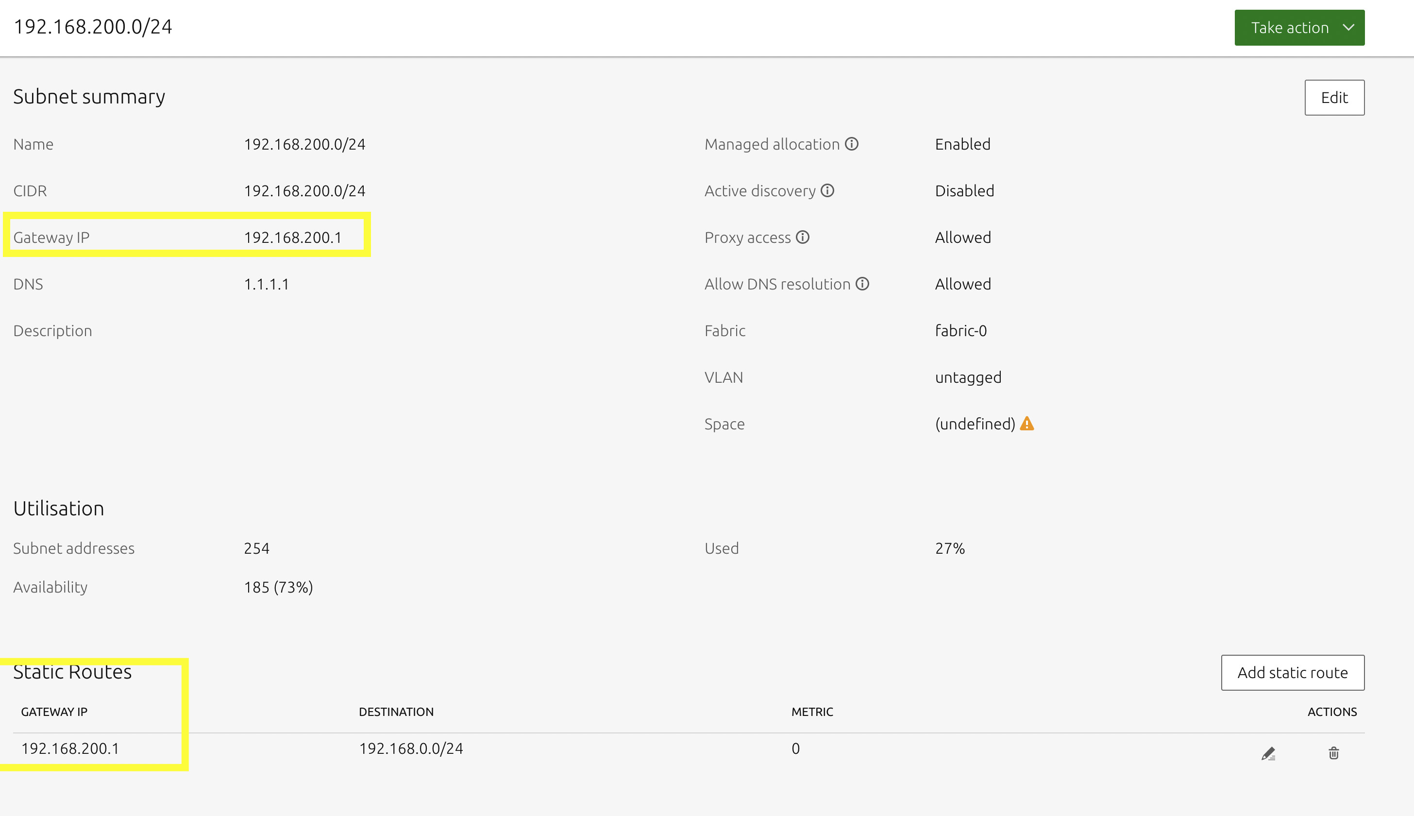

Eth1: This is manually configured to 192.168.20.1 (no gateway set)
This “red” network connects to all of my IPMI ports on all of my machines; each machine has a static IP address for the IPMI network.

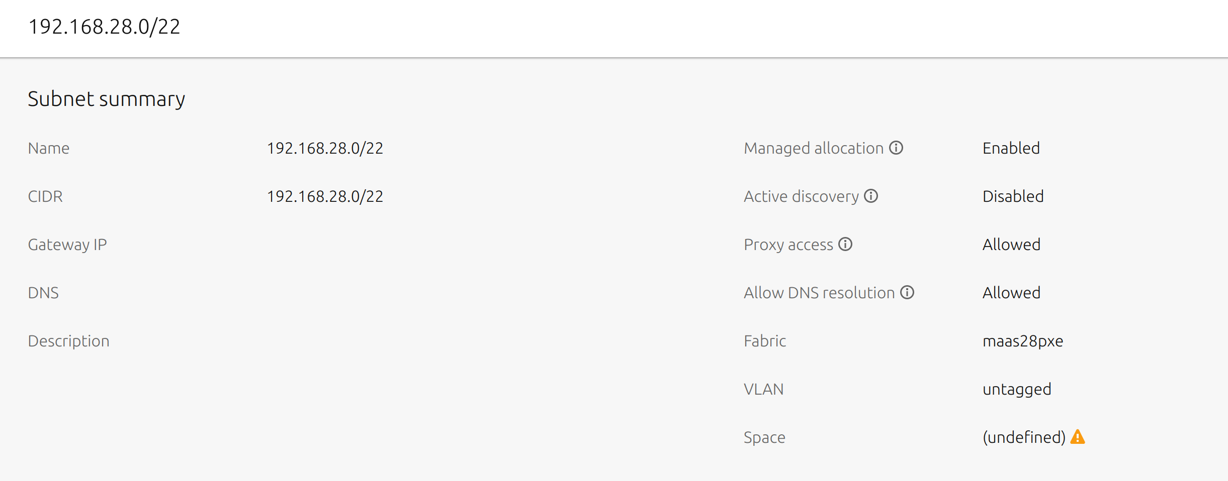

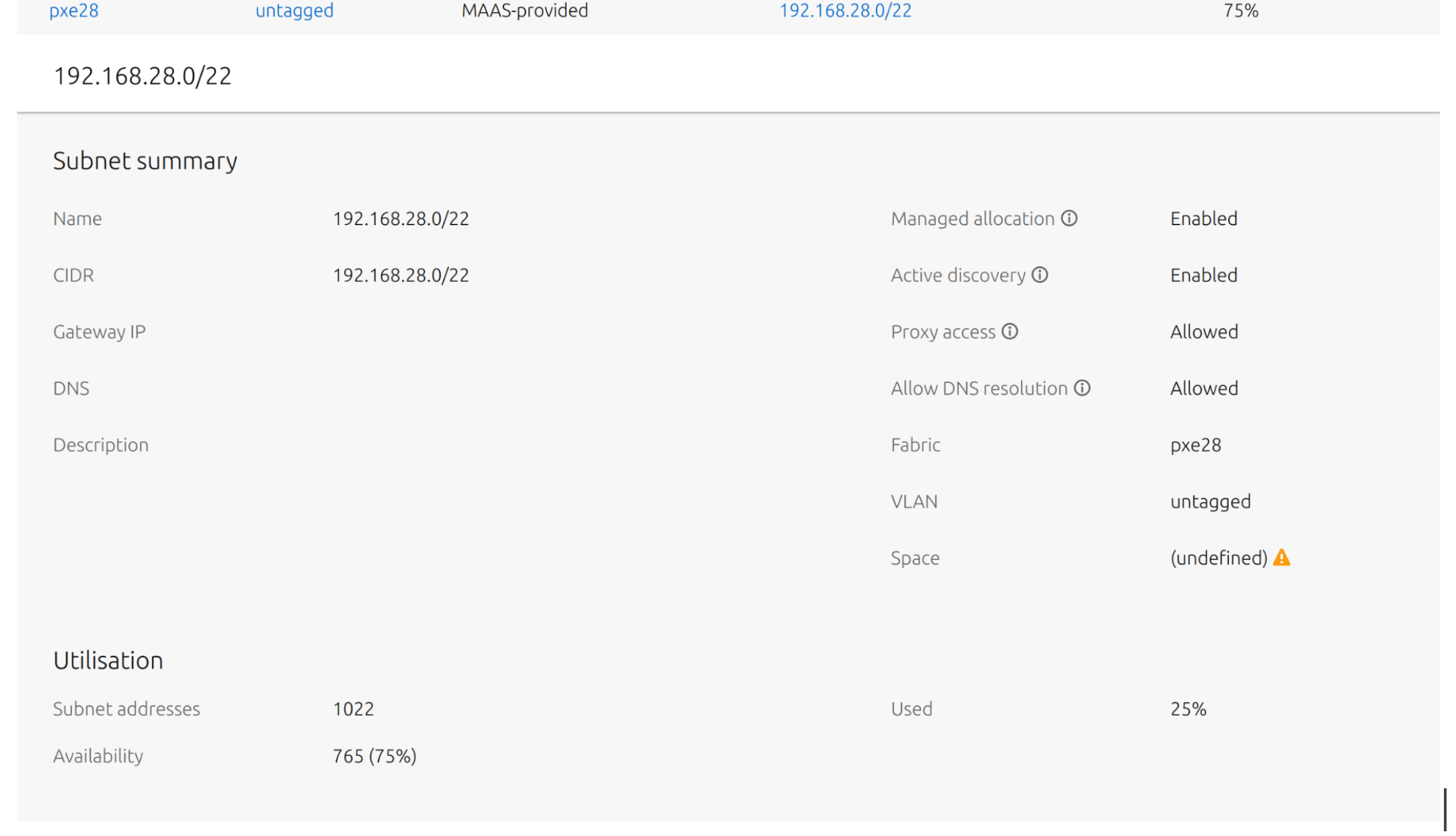

Eth2 (Black Network): 192.168.30.XXX This is the network I would like to use for PXE booting/setup
Eth3 (Yellow Network) 192.168.80.XXX This is my high speed network I use for connecting to my NAS
So initially, the black/yellow network have no IP address. I want MAAS to provide DHCP for both networks.
So I currently then reconfigure Eth3/Eth4 (Yellow/Black) and assign them each a STATIC Ip address ( 30.1 and 80.1 respectively).
So at this phase, should/do I also configure the network adapters to have a gateway ?? In the past, I’ve put in 30.1 and 80.1… On my latest installation, I avoided doing that.
So I was able to PXE boot, so I know I am on the right track. However I did not put an IP address for the gateway for the PXE network… should this be set to the static IP of the MAAS controller’s INTERNAL network (i.e. 192.168.30.1 ).

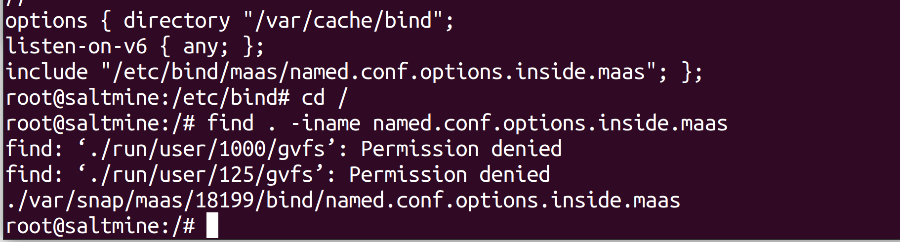

I can ssh into the machine using ubuntu@192.168.28.1, however if I try and do nslookup node1or node1.maas on the maas headnode/server I can a NXDOMAIN. I realize this means my machine isn’t checking the MAAS DNS server, but I would have thought that when I enable DNS on the MAAS UI, it should/would automatically update the host machine so it can query/lookup these addresses locally.
I know the DNS service itself is running, because once I connect to node1 via it’s IP Address, I CAN do an NSLOOKUP from that machine, and it is able to resolve addresses on the 192.168.30.XX network.
Working on those tweaks. One thing to just clarify for clarity… I am going to set the DNS on the primary adapter to 127.0.0.1 … The GUI for the network manager tool won’t allow me to type in localhost… it has to be an OCTET format IP address…
