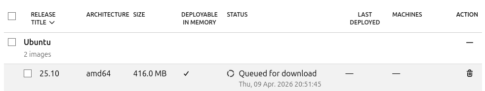

However, the controller indicates that Ubuntu images selected during the UI-based region configuration process are queued for download - but they never download:
Also, the maas-temporal-worker persistently complains about an SSL failure, tweaked to hopefully render into a format that’s more easily read by us humans:
$ journalctl -u snap.maas.pebble.service -t maas-temporal-worker --grep "Completing activity as fai
led" | tail -n 1 | sed 's/^[^{]*//g' | jq . | sed 's/^"//;s/"$//;s/\\n/\n/g;s/\\"/"/g'

The MAAS url in the regiond.conf must be http
Excellent - thank you very much, @r00ta! Your answer resolves one of the issues… Do you have any suggestions on how best to determine why the DHCP configuration files are empty and the dhcpd server does not start when I specify a non-TLS endpoint? I see nothing in the logs that indicates an error processing DHCP configuration, so I’m rather at a loss.
Thank you again for your help!

I’ll confess I’m having trouble understanding this one. Do I need to configure some kind of token for DHCP configuration to succeed once TLS is configured? I didn’t see anything in the documentation describing any such step, but I may have overlooked something.
One more potentially interesting data point: I reset my sandbox environment and configured it without any TLS, and I found that DHCP configuration occurs without an error. I then reset the sandbox environment again and configured it without MaaS native TLS but with Apache providing TLS termination on port 443 and acting as a proxy to MaaS on port 5240. With this configuration and with the MaaS URL pointing to unencrypted port 5240 as per your direction, both image download and DHCP configuration function without error.
This data point and the previously noted exception seem to suggest that DHCP configuration attempts - and fails - to use the native TLS endpoint when native TLS is configured, but is able to use unencrypted port 5240 without an issue. If this theory is correct, should DHCP configuration be made to correctly function with the native TLS endpoint, or should it instead use the unencrypted MaaS URL?
Thank you again for your help and your time!
