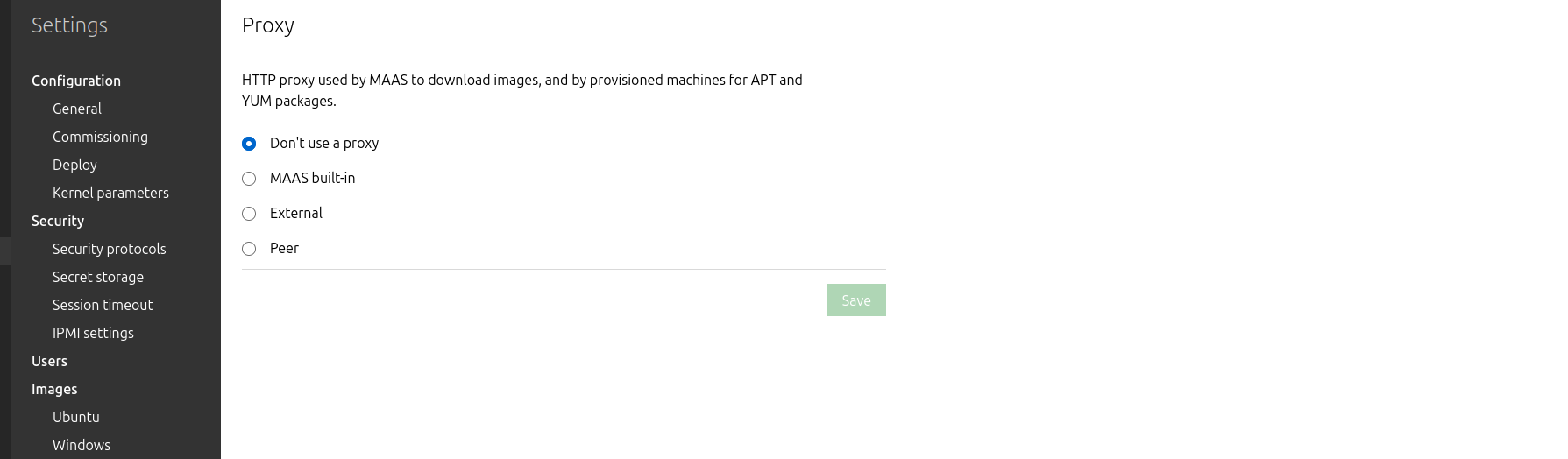

Hi MAAS team, I faced a weird issue to bootstrap juju controllers using MAAS. My setup uses proxy server to access the internet. In the MAAS configuration I do not explicitly configure proxy server:
