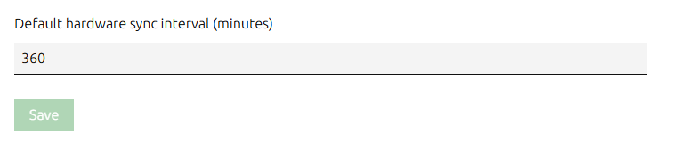

I’m running into an issue where I want my hardware to sync every 6 hours, since I want to get any hardware updates but I don’t want to inundate my maas server with hardware updates. I set the “Default hardware sync interval (minutes)” to 360 but it looks like it errors:
Jan 29 18:04:27 101-u26 systemd[1]: /lib/systemd/system/maas_hardware_sync.timer:12: Failed to parse calendar specification, ignoring: --* *:00/360:00
Jan 29 18:04:27 101-u26 systemd[1]: maas_hardware_sync.timer: Timer unit lacks value setting. Refusing.
I’m guessing MaaS is trying to configure the hardware timer so the minutes are between 0 and 60; if that is the case, can someone update the UI to reflect that and/or can someone update the maas_hardware_sync.timer script so it can take values greater than 60 so we can configure hardware syncs in intervals greater than an hour?

I set it to 7h to see if it changed the UI and it does, it sets it to 420:

Looks like configuring it via the CLI worked. The systemd timer is set properly with:
OnCalendar=*-*-* 00/7:00:00
So there must be some disconnect with setting large intervals in the UI and deploying it to the systems? Thanks for your help!
