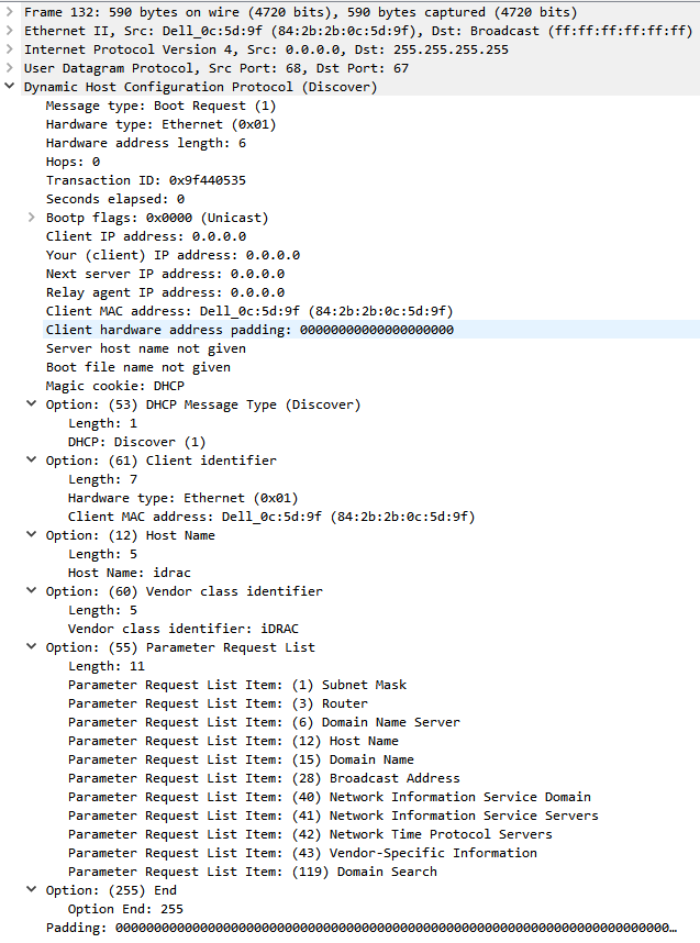

As shown below, I can see the DHCP discover message in tcpdump
But when I check DHCP logs as shown below it says DHCP discover is received on VLAN 5004 and no leases present for the same. As shown in previous packet capture I can only see untagged DHCP discover message. This is really weird as vlan 5004 is not even within valid vlan range

Packet capture from tcpdump for reference
12:25:33.623049 84:2b:2b:0c:5d:9f (oui Unknown) > Broadcast, ethertype IPv4 (0x0800), length 590: (tos 0x0, ttl 64, id 0, offset 0, flags [none], proto UDP (17), length 576)
    0.0.0.0.bootpc > 255.255.255.255.bootps: BOOTP/DHCP, Request from 84:2b:2b:0c:5d:9f (oui Unknown), length 548, xid 0x13b44c18, Flags [none]
	  Client-Ethernet-Address 84:2b:2b:0c:5d:9f (oui Unknown)
	  Vendor-rfc1048 Extensions
	    Magic Cookie 0x63825363
	    DHCP-Message (53), length 1: Discover
	    Client-ID (61), length 7: ether 84:2b:2b:0c:5d:9f
	    Hostname (12), length 5: "idrac"
	    Vendor-Class (60), length 5: "iDRAC"
	    Parameter-Request (55), length 11:
	      Subnet-Mask (1), Default-Gateway (3), Domain-Name-Server (6), Hostname (12)
	      Domain-Name (15), BR (28), YD (40), YS (41)
	      NTP (42), Vendor-Option (43), Unknown (119)

On further troubleshooting, we observed that DHCP requests from the Server [both iDRAC and Host] are ignored by MAAS. As shown in my previous logs, packet capture on MAAS shows DHCP DISCOVER messages are received from the server in untagged format. But DHCP server is displaying a log saying DHCP-DISCOVER from server is part of network vlan-5004 and it contains no free leases.
Vlan range is valid only from 2-4096 and I am confused why DHCP server says it is vlan-5004.
NOTE: I have tried replacing SWITCH1 with SWITCH2 and it seems to work fine. I see the same packet on MAAS end with both SWITCH1 and SWITCH2 but it works fine with SWITCH2 only.

Well even I was thinking it could be the switch issue but the packet captures were showing untagged frames and this confused me. Anyhow I will try to trouble shoot it at the switch level to confirm the same
