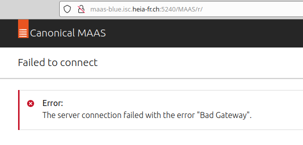

MAAS dashboard unaccessible after snap updated maas from 3.3.4 to 3.3.5
maas-blue
Snap updated automatically maas from 3.3.4 to 3.3.5 on January 18th at 04:37 UTC. Since, I cannot access the MAAS dashboard and I’m also not able to access via the CLI:
maas02:~# maas login admin http://160.98.45.26:5240/MAAS
API key (leave empty for anonymous access):
The MAAS server gave an unexpected response: 502
maas02:~#
The OpenStack installed on the machines managed by MAAS work well and with a “maas status” on a terminal mentionned all services RUNNING except the proxy which was not started.
A reboot of the MAAS server was made yesterday and the “maas status” is eve worse than before, not only the proxy is stopped but also dhcpd, dhcpd6 and syslog:

2024-01-18T05:17:01.496394+00:00 maas02 maas.power_monitor_service: [error] Failed to query nodes' power status:
2024-01-18T05:19:16.500332+00:00 maas02 maas.power_monitor_service: [error] Failed to query nodes' power status:
2024-01-18T05:20:46.521396+00:00 maas02 maas.boot_image_download_service: [error] Failed to download images:
2024-01-18T05:20:56.554643+00:00 maas02 maas.dhcp.probe: [error] Unable to probe for DHCP servers:
2024-01-18T05:21:31.497131+00:00 maas02 maas.power_monitor_service: [error] Failed to query nodes' power status:
2024-01-18T05:23:46.497641+00:00 maas02 maas.power_monitor_service: [error] Failed to query nodes' power status:
2024-01-18T05:25:46.502331+00:00 maas02 maas.boot_image_download_service: [error] Failed to download images:
2024-01-18T05:26:01.496437+00:00 maas02 maas.power_monitor_service: [error] Failed to query nodes' power status:
2024-01-18T05:30:31.496896+00:00 maas02 maas.power_monitor_service: message repeated 2 times: [ [error] Failed to query nodes' power status: ]
content of /var/snap/maas/common/log/rackd.log
2024-01-18 04:33:24 sstreams: [info] maas:v2:download/maas:boot:ubuntu:amd64:hwe-22.04-lowlatency-edge:jammy: to_add=['20230328'] to_remove=[]
2024-01-18 04:33:24 sstreams: [info] maas:v2:download/maas:boot:ubuntu:amd64:hwe-22.04-lowlatency:jammy: to_add=['20230328'] to_remove=[]
2024-01-18 04:33:24 sstreams: [info] maas:v2:download/maas:boot:ubuntu:amd64:hwe-22.04:jammy: to_add=['20230328'] to_remove=[]
2024-01-18 04:33:54 provisioningserver.rackdservices.dhcp_probe_service: [info] External DHCP probe complete.
2024-01-18 04:37:04 ClusterClient,client: [info] ClusterClient connection lost (HOST:IPv6Address(type='TCP', host='::ffff:10.43.0.2', port=43146, flowInfo=0, scopeID=0) PEER:IPv6Address(type='TCP', host='::ffff:10.43.0.2', port=5252, flowInfo=0, scopeID=0))
2024-01-18 04:37:24 Uninitialized: [info] ClusterClient connection established (HOST:IPv6Address(type='TCP', host='::ffff:10.43.0.2', port=37744, flowInfo=0, scopeID=0) PEER:IPv6Address(type='TCP', host='::ffff:10.43.0.2', port=5252, flowInfo=0, scopeID=0))
2024-01-18 04:37:24 provisioningserver.rpc.clusterservice: [info] Event-loop 'maas02:pid=1431' authenticated.
2024-01-18 04:37:24 provisioningserver.rpc.clusterservice: [info] Rack controller 'by6f8t' registered (via maas02:pid=1431) with MAAS version 3.3.4-13189-g.f88272d1e.
2024-01-18 04:37:34 ClusterClient,client: [info] ClusterClient connection lost (HOST:IPv6Address(type='TCP', host='::ffff:10.43.0.2', port=42512, flowInfo=0, scopeID=0) PEER:IPv6Address(type='TCP', host='::ffff:10.43.0.2', port=5252, flowInfo=0, scopeID=0))
2024-01-18 04:37:54 Uninitialized: [info] ClusterClient connection established (HOST:IPv6Address(type='TCP', host='::ffff:10.43.0.2', port=37724, flowInfo=0, scopeID=0) PEER:IPv6Address(type='TCP', host='::ffff:10.43.0.2', port=5252, flowInfo=0, scopeID=0))
2024-01-18 04:37:54 Uninitialized: [info] ClusterClient connection established (HOST:IPv6Address(type='TCP', host='::ffff:10.43.0.2', port=37726, flowInfo=0, scopeID=0) PEER:IPv6Address(type='TCP', host='::ffff:10.43.0.2', port=5252, flowInfo=0, scopeID=0))
2024-01-18 04:37:54 provisioningserver.rpc.clusterservice: [info] Event-loop 'maas02:pid=1431' authenticated.
2024-01-18 04:37:54 provisioningserver.rpc.clusterservice: [info] Rack controller 'by6f8t' registered (via maas02:pid=1431) with MAAS version 3.3.4-13189-g.f88272d1e.
2024-01-18 04:37:55 provisioningserver.rpc.clusterservice: [info] Rack controller 'by6f8t' registered (via maas02:pid=1431) with MAAS version 3.3.4-13189-g.f88272d1e.
2024-01-18 04:38:04 ClusterClient,client: [info] ClusterClient connection lost (HOST:IPv6Address(type='TCP', host='::ffff:10.43.0.2', port=58846, flowInfo=0, scopeID=0) PEER:IPv6Address(type='TCP', host='::ffff:10.43.0.2', port=5252, flowInfo=0, scopeID=0))
2024-01-18 04:38:27 -: [info] Received SIGTERM, shutting down.
2024-01-18 04:38:27 twisted.internet.unix: [info] (Port '/var/snap/maas/common/maas/dhcpd.sock' Closed)
2024-01-18 04:38:27 twisted.internet.defer: [critical] Unhandled error in Deferred:
	  File "/snap/maas/28521/usr/lib/python3/dist-packages/twisted/internet/defer.py", line 661, in callback
	    self._startRunCallbacks(result)
	  File "/snap/maas/28521/usr/lib/python3/dist-packages/twisted/internet/defer.py", line 763, in _startRunCallbacks
	    self._runCallbacks()
	  File "/snap/maas/28521/usr/lib/python3/dist-packages/twisted/internet/defer.py", line 857, in _runCallbacks
	    current.result = callback(  # type: ignore[misc]
	  File "/snap/maas/28521/usr/lib/python3/dist-packages/twisted/internet/defer.py", line 1750, in gotResult
	    current_context.run(_inlineCallbacks, r, gen, status)
	--- <exception caught here> ---
	  File "/snap/maas/28521/usr/lib/python3/dist-packages/twisted/internet/defer.py", line 1656, in _inlineCallbacks
	    result = current_context.run(
	  File "/snap/maas/28521/usr/lib/python3/dist-packages/twisted/python/failure.py", line 489, in throwExceptionIntoGenerator
	    return g.throw(self.type, self.value, self.tb)
	  File "/snap/maas/28521/lib/python3.10/site-packages/provisioningserver/rackdservices/lease_socket_service.py", line 121, in processNotification
	    yield pause(wait, self.clock)
	builtins.AttributeError: 'LeaseSocketService' object has no attribute 'clock'
2024-01-18 04:38:27 provisioningserver.utils.services: [info] New interface monitoring state: {}
2024-01-18 04:38:27 provisioningserver.utils.services: [info] Stopping neighbour discovery for interfaces: {'ens224', 'ens192', 'ens160'}
2024-01-18 04:38:27 provisioningserver.utils.services: [info] Stopping beaconing for interfaces: {'ens224', 'ens192', 'ens160'}
2024-01-18 04:38:27 ClusterClient,client: [info] ClusterClient connection lost (HOST:IPv6Address(type='TCP', host='::ffff:160.98.45.26', port=53402, flowInfo=0, scopeID=0) PEER:IPv6Address(type='TCP', host='::ffff:160.98.45.26', port=5250, flowInfo=0, scopeID=0))
2024-01-18 04:38:27 ClusterClient,client: [info] ClusterClient connection lost (HOST:IPv6Address(type='TCP', host='::ffff:160.98.45.26', port=47288, flowInfo=0, scopeID=0) PEER:IPv6Address(type='TCP', host='::ffff:160.98.45.26', port=5250, flowInfo=0, scopeID=0))
2024-01-18 04:38:27 ClusterClient,client: [info] ClusterClient connection lost (HOST:IPv6Address(type='TCP', host='::ffff:160.98.45.26', port=38618, flowInfo=0, scopeID=0) PEER:IPv6Address(type='TCP', host='::ffff:160.98.45.26', port=5250, flowInfo=0, scopeID=0))
2024-01-18 04:38:27 ClusterClient,client: [info] ClusterClient connection lost (HOST:IPv6Address(type='TCP', host='::ffff:160.98.45.26', port=47304, flowInfo=0, scopeID=0) PEER:IPv6Address(type='TCP', host='::ffff:160.98.45.26', port=5250, flowInfo=0, scopeID=0))
2024-01-18 04:38:27 provisioningserver.utils.services: [info] observe-beacons[ens192]: 0 packets captured
2024-01-18 04:38:27 provisioningserver.utils.services: [info] observe-beacons[ens192]: 215382 packets received by filter
2024-01-18 04:38:27 provisioningserver.utils.services: [info] observe-beacons[ens192]: 0 packets dropped by kernel
2024-01-18 04:38:27 provisioningserver.utils.services: [info] observe-beacons[ens160]: 639068 packets captured
2024-01-18 04:38:27 provisioningserver.utils.services: [info] observe-beacons[ens160]: 854450 packets received by filter
2024-01-18 04:38:27 provisioningserver.utils.services: [info] observe-beacons[ens160]: 0 packets dropped by kernel
2024-01-18 04:38:27 ClusterClient,client: [info] ClusterClient connection lost (HOST:IPv6Address(type='TCP', host='::ffff:10.23.0.2', port=60292, flowInfo=0, scopeID=0) PEER:IPv6Address(type='TCP', host='::ffff:10.23.0.2', port=5253, flowInfo=0, scopeID=0))
2024-01-18 04:38:27 ClusterClient,client: [info] ClusterClient connection lost (HOST:IPv6Address(type='TCP', host='::ffff:10.23.0.2', port=38652, flowInfo=0, scopeID=0) PEER:IPv6Address(type='TCP', host='::ffff:10.23.0.2', port=5253, flowInfo=0, scopeID=0))
2024-01-18 04:38:27 ClusterClient,client: [info] ClusterClient connection lost (HOST:IPv6Address(type='TCP', host='::ffff:10.23.0.2', port=55294, flowInfo=0, scopeID=0) PEER:IPv6Address(type='TCP', host='::ffff:10.23.0.2', port=5253, flowInfo=0, scopeID=0))
2024-01-18 04:38:27 ClusterClient,client: [info] ClusterClient connection lost (HOST:IPv6Address(type='TCP', host='::ffff:10.23.0.2', port=57790, flowInfo=0, scopeID=0) PEER:IPv6Address(type='TCP', host='::ffff:10.23.0.2', port=5253, flowInfo=0, scopeID=0))
2024-01-18 04:38:27 provisioningserver.utils.services: [info] observe-beacons[ens224]: 0 packets captured
2024-01-18 04:38:27 provisioningserver.utils.services: [info] observe-beacons[ens224]: 215382 packets received by filter
2024-01-18 04:38:27 provisioningserver.utils.services: [info] observe-beacons[ens224]: 0 packets dropped by kernel
2024-01-18 04:38:27 provisioningserver.utils.services: [info] observe-arp[ens160]: 1932145 packets captured
2024-01-18 04:38:27 provisioningserver.utils.services: [info] observe-arp[ens160]: 1932145 packets received by filter
2024-01-18 04:38:27 provisioningserver.utils.services: [info] observe-arp[ens160]: 0 packets dropped by kernel
2024-01-18 04:38:27 provisioningserver.utils.services: [info] observe-arp[ens192]: 2290553 packets captured
2024-01-18 04:38:27 provisioningserver.utils.services: [info] observe-arp[ens192]: 2290553 packets received by filter
2024-01-18 04:38:27 provisioningserver.utils.services: [info] observe-arp[ens192]: 0 packets dropped by kernel
2024-01-18 04:38:27 provisioningserver.utils.services: [info] observe-arp[ens224]: 32 packets captured
2024-01-18 04:38:27 provisioningserver.utils.services: [info] observe-arp[ens224]: 32 packets received by filter
2024-01-18 04:38:27 provisioningserver.utils.services: [info] observe-arp[ens224]: 0 packets dropped by kernel
2024-01-18 04:38:27 ClusterClient,client: [info] ClusterClient connection lost (HOST:IPv6Address(type='TCP', host='::ffff:10.43.0.2', port=37726, flowInfo=0, scopeID=0) PEER:IPv6Address(type='TCP', host='::ffff:10.43.0.2', port=5252, flowInfo=0, scopeID=0))
2024-01-18 04:38:27 ClusterClient,client: [info] ClusterClient connection lost (HOST:IPv6Address(type='TCP', host='::ffff:10.43.0.2', port=37744, flowInfo=0, scopeID=0) PEER:IPv6Address(type='TCP', host='::ffff:10.43.0.2', port=5252, flowInfo=0, scopeID=0))
2024-01-18 04:38:27 ClusterClient,client: [info] ClusterClient connection lost (HOST:IPv6Address(type='TCP', host='::ffff:10.43.0.2', port=46202, flowInfo=0, scopeID=0) PEER:IPv6Address(type='TCP', host='::ffff:10.43.0.2', port=5252, flowInfo=0, scopeID=0))
2024-01-18 04:38:27 ClusterClient,client: [info] ClusterClient connection lost (HOST:IPv6Address(type='TCP', host='::ffff:10.43.0.2', port=37724, flowInfo=0, scopeID=0) PEER:IPv6Address(type='TCP', host='::ffff:10.43.0.2', port=5252, flowInfo=0, scopeID=0))
2024-01-18 04:38:27 ClusterClient,client: [info] ClusterClient connection lost (HOST:IPv6Address(type='TCP', host='2001:620:40b:1045:250:56ff:fe92:b1c0', port=56368, flowInfo=0, scopeID=0) PEER:IPv6Address(type='TCP', host='2001:620:40b:1045:250:56ff:fe92:b1c0', port=5251, flowInfo=0, scopeID=0))
2024-01-18 04:38:27 ClusterClient,client: [info] ClusterClient connection lost (HOST:IPv6Address(type='TCP', host='2001:620:40b:1045:250:56ff:fe92:b1c0', port=35720, flowInfo=0, scopeID=0) PEER:IPv6Address(type='TCP', host='2001:620:40b:1045:250:56ff:fe92:b1c0', port=5251, flowInfo=0, scopeID=0))
2024-01-18 04:38:27 ClusterClient,client: [info] ClusterClient connection lost (HOST:IPv6Address(type='TCP', host='2001:620:40b:1045:250:56ff:fe92:b1c0', port=35730, flowInfo=0, scopeID=0) PEER:IPv6Address(type='TCP', host='2001:620:40b:1045:250:56ff:fe92:b1c0', port=5251, flowInfo=0, scopeID=0))
2024-01-18 04:38:27 provisioningserver.rpc.clusterservice: [info] Lost all connections to region controllers. Stopping service(s) dhcpd.
2024-01-18 04:38:27 ClusterClient,client: [info] ClusterClient connection lost (HOST:IPv6Address(type='TCP', host='2001:620:40b:1045:250:56ff:fe92:b1c0', port=44174, flowInfo=0, scopeID=0) PEER:IPv6Address(type='TCP', host='2001:620:40b:1045:250:56ff:fe92:b1c0', port=5251, flowInfo=0, scopeID=0))
	  File "/snap/maas/28521/usr/lib/python3/dist-packages/twisted/internet/base.py", line 492, in fireEvent
	    result = callable(*args, **kwargs)
	  File "/snap/maas/28521/usr/lib/python3/dist-packages/twisted/application/service.py", line 284, in stopService
	    l.append(defer.maybeDeferred(service.stopService))
	  File "/snap/maas/28521/usr/lib/python3/dist-packages/twisted/internet/defer.py", line 190, in maybeDeferred
	    result = f(*args, **kwargs)
	  File "/snap/maas/28521/lib/python3.10/site-packages/provisioningserver/rackdservices/lease_socket_service.py", line 68, in stopService
	    self.processor.stop()
	  File "/snap/maas/28521/usr/lib/python3/dist-packages/twisted/internet/task.py", line 213, in stop
	    assert self.running, "Tried to stop a LoopingCall that was " "not running."
	builtins.AssertionError: Tried to stop a LoopingCall that was not running.
2024-01-18 04:38:27 twisted.scripts: [info] Server Shut Down.
2024-01-18 04:38:46 twisted.scripts: [info] twistd 22.1.0 (/snap/maas/32636/bin/python3 3.10.12) starting up.
2024-01-18 04:38:46 twisted.scripts: [info] reactor class: twisted.internet.asyncioreactor.AsyncioSelectorReactor.
2024-01-18 04:38:46 provisioningserver.rpc.clusterservice: [info] Region is not advertising RPC endpoints. (While requesting RPC info at http://160.98.45.26:5240/MAAS)
2024-01-18 04:38:46 provisioningserver.utils.services: [info] Starting beaconing for interfaces: {'ens160', 'ens224', 'ens192'}
2024-01-18 04:38:46 provisioningserver.utils.services: [info] Beaconing process for ens160 started.
2024-01-18 04:38:46 provisioningserver.utils.services: [info] Beaconing process for ens224 started.
2024-01-18 04:38:46 provisioningserver.utils.services: [info] Beaconing process for ens192 started.
2024-01-18 04:38:47 provisioningserver.rpc.clusterservice: [info] Region is not advertising RPC endpoints. (While requesting RPC info at http://160.98.45.26:5240/MAAS)
2024-01-18 04:38:47 provisioningserver.utils.services: [info] observe-beacons[ens160]: tcpdump: listening on ens160, link-type EN10MB (Ethernet), snapshot length 16384 bytes
2024-01-18 04:38:47 provisioningserver.utils.services: [info] observe-beacons[ens224]: tcpdump: listening on ens224, link-type EN10MB (Ethernet), snapshot length 16384 bytes
2024-01-18 04:38:48 provisioningserver.utils.services: [info] observe-beacons[ens192]: tcpdump: listening on ens192, link-type EN10MB (Ethernet), snapshot length 16384 bytes
2024-01-18 04:38:48 provisioningserver.rpc.clusterservice: [info] Region is not advertising RPC endpoints. (While requesting RPC info at http://160.98.45.26:5240/MAAS)
2024-01-18 04:38:49 provisioningserver.rpc.clusterservice: [info] Region is not advertising RPC endpoints. (While requesting RPC info at http://160.98.45.26:5240/MAAS)
2024-01-18 04:38:50 provisioningserver.rpc.clusterservice: [info] Region is not advertising RPC endpoints. (While requesting RPC info at http://160.98.45.26:5240/MAAS)
2024-01-18 04:38:51 provisioningserver.rpc.clusterservice: [info] Region is not advertising RPC endpoints. (While requesting RPC info at http://160.98.45.26:5240/MAAS)
2024-01-18 04:38:52 provisioningserver.rpc.clusterservice: [info] Region is not advertising RPC endpoints. (While requesting RPC info at http://160.98.45.26:5240/MAAS)
2024-01-18 04:38:53 provisioningserver.rpc.clusterservice: [info] Region is not advertising RPC endpoints. (While requesting RPC info at http://160.98.45.26:5240/MAAS)
2024-01-18 04:38:54 provisioningserver.rpc.clusterservice: [info] Region is not advertising RPC endpoints. (While requesting RPC info at http://160.98.45.26:5240/MAAS)
2024-01-18 04:38:55 provisioningserver.rpc.clusterservice: [info] Region is not advertising RPC endpoints. (While requesting RPC info at http://160.98.45.26:5240/MAAS)
2024-01-18 04:38:56 provisioningserver.rpc.clusterservice: [info] Region is not advertising RPC endpoints. (While requesting RPC info at http://160.98.45.26:5240/MAAS)
2024-01-18 04:38:57 provisioningserver.rpc.clusterservice: [info] Region is not advertising RPC endpoints. (While requesting RPC info at http://160.98.45.26:5240/MAAS)
2024-01-18 04:38:58 provisioningserver.rpc.clusterservice: [info] Region is not advertising RPC endpoints. (While requesting RPC info at http://160.98.45.26:5240/MAAS)
2024-01-18 04:38:59 provisioningserver.rpc.clusterservice: [info] Making connections to event-loops: maas02:pid=274023, maas02:pid=274024, maas02:pid=274026, maas02:pid=274027
2024-01-18 04:38:59 Uninitialized: [info] ClusterClient connection established (HOST:IPv6Address(type='TCP', host='::ffff:10.23.0.2', port=34154, flowInfo=0, scopeID=0) PEER:IPv6Address(type='TCP', host='::ffff:10.23.0.2', port=5251, flowInfo=0, scopeID=0))
2024-01-18 04:38:59 Uninitialized: [info] ClusterClient connection established (HOST:IPv6Address(type='TCP', host='2001:620:40b:1045:250:56ff:fe92:b1c0', port=45204, flowInfo=0, scopeID=0) PEER:IPv6Address(type='TCP', host='2001:620:40b:1045:250:56ff:fe92:b1c0', port=5252, flowInfo=0, scopeID=0))
2024-01-18 04:38:59 Uninitialized: [info] ClusterClient connection established (HOST:IPv6Address(type='TCP', host='::ffff:10.43.0.2', port=47740, flowInfo=0, scopeID=0) PEER:IPv6Address(type='TCP', host='::ffff:10.43.0.2', port=5250, flowInfo=0, scopeID=0))
2024-01-18 04:38:59 Uninitialized: [info] ClusterClient connection established (HOST:IPv6Address(type='TCP', host='::ffff:160.98.45.26', port=55320, flowInfo=0, scopeID=0) PEER:IPv6Address(type='TCP', host='::ffff:160.98.45.26', port=5253, flowInfo=0, scopeID=0))
2024-01-18 04:38:59 provisioningserver.rpc.clusterservice: [info] Event-loop 'maas02:pid=274026' authenticated.
2024-01-18 04:38:59 provisioningserver.rpc.clusterservice: [info] Event-loop 'maas02:pid=274024' authenticated.
2024-01-18 04:38:59 provisioningserver.rpc.clusterservice: [info] Event-loop 'maas02:pid=274027' authenticated.
2024-01-18 04:38:59 provisioningserver.rpc.clusterservice: [info] Event-loop 'maas02:pid=274023' authenticated.
2024-01-18 04:38:59 provisioningserver.rpc.clusterservice: [info] Fully connected to all 4 event-loops on all 1 region controllers (maas02).
2024-01-18 04:38:59 provisioningserver.rpc.clusterservice: [info] Rack controller 'by6f8t' registered (via maas02:pid=274026) with MAAS version 3.3.5-13222-g.78dd996c0.
2024-01-18 04:39:00 provisioningserver.rpc.clusterservice: [info] Rack controller 'by6f8t' registered (via maas02:pid=274024) with MAAS version 3.3.5-13222-g.78dd996c0.
2024-01-18 04:39:00 provisioningserver.rpc.clusterservice: [info] Rack controller 'by6f8t' registered (via maas02:pid=274027) with MAAS version 3.3.5-13222-g.78dd996c0.
2024-01-18 04:39:00 provisioningserver.rpc.clusterservice: [info] Rack controller 'by6f8t' registered (via maas02:pid=274023) with MAAS version 3.3.5-13222-g.78dd996c0.
2024-01-18 04:39:01 provisioningserver.rackdservices.dhcp_probe_service: [info] Probe for external DHCP servers started on interfaces: ens160, ens192, ens224.
2024-01-18 04:39:01 provisioningserver.utils.services: [warn] Couldn't report test results: Unexpected error [Remote end closed connection without response]
2024-01-18 04:39:16 Uninitialized: [info] ClusterClient connection established (HOST:IPv6Address(type='TCP', host='::ffff:10.43.0.2', port=48146, flowInfo=0, scopeID=0) PEER:IPv6Address(type='TCP', host='::ffff:10.43.0.2', port=5250, flowInfo=0, scopeID=0))
2024-01-18 04:39:16 Uninitialized: [info] ClusterClient connection established (HOST:IPv6Address(type='TCP', host='::ffff:10.43.0.2', port=48148, flowInfo=0, scopeID=0) PEER:IPv6Address(type='TCP', host='::ffff:10.43.0.2', port=5250, flowInfo=0, scopeID=0))
2024-01-18 04:39:16 provisioningserver.rpc.clusterservice: [info] Event-loop 'maas02:pid=274026' authenticated.
2024-01-18 04:39:16 twisted.internet.defer: [critical] Unhandled error in Deferred:
	Failure: twisted.internet.error.MulticastJoinError: (b'\xe0\x00\x00v', b'\xa0b-\x1a', 98, 'Address already in use')
	Failure: twisted.internet.error.MulticastJoinError: (b'\xe0\x00\x00v', b'\n\x17\x00\x02', 98, 'Address already in use')
	Failure: twisted.internet.error.MulticastJoinError: (b'\xe0\x00\x00v', b'\n+\x00\x02', 98, 'Address already in use')
2024-01-18 04:39:16 provisioningserver.rpc.clusterservice: [info] Rack controller 'by6f8t' registered (via maas02:pid=274026) with MAAS version 3.3.5-13222-g.78dd996c0.
2024-01-18 04:39:17 provisioningserver.rpc.clusterservice: [info] Rack controller 'by6f8t' registered (via maas02:pid=274026) with MAAS version 3.3.5-13222-g.78dd996c0.
2024-01-18 04:39:28 provisioningserver.utils.services: [info] New interface monitoring state: {'ens160': {'neighbour': True, 'mdns': True}, 'ens192': {'neighbour': True, 'mdns': True}, 'ens224': {'neighbour': True, 'mdns': True}}
2024-01-18 04:39:28 provisioningserver.utils.services: [info] Starting neighbour discovery for interfaces: {'ens160', 'ens224', 'ens192'}
2024-01-18 04:39:28 provisioningserver.utils.services: [info] Neighbour observation process for ens160 started.
2024-01-18 04:39:28 provisioningserver.utils.services: [info] Neighbour observation process for ens224 started.
2024-01-18 04:39:28 provisioningserver.utils.services: [info] Neighbour observation process for ens192 started.
2024-01-18 04:39:28 provisioningserver.utils.services: [info] mDNS observation process started.
2024-01-18 04:39:29 provisioningserver.utils.services: [info] observe-arp[ens224]: tcpdump: listening on ens224, link-type EN10MB (Ethernet), snapshot length 64 bytes
2024-01-18 04:39:29 provisioningserver.utils.services: [info] observe-arp[ens160]: tcpdump: listening on ens160, link-type EN10MB (Ethernet), snapshot length 64 bytes
2024-01-18 04:39:29 provisioningserver.utils.services: [info] observe-arp[ens192]: tcpdump: listening on ens192, link-type EN10MB (Ethernet), snapshot length 64 bytes
2024-01-18 04:39:31 provisioningserver.rackdservices.dhcp_probe_service: [info] External DHCP probe complete.
2024-01-18 04:39:46 Uninitialized: [info] ClusterClient connection established (HOST:IPv6Address(type='TCP', host='::ffff:10.43.0.2', port=52984, flowInfo=0, scopeID=0) PEER:IPv6Address(type='TCP', host='::ffff:10.43.0.2', port=5250, flowInfo=0, scopeID=0))
2024-01-18 04:39:46 Uninitialized: [info] ClusterClient connection established (HOST:IPv6Address(type='TCP', host='::ffff:10.43.0.2', port=53000, flowInfo=0, scopeID=0) PEER:IPv6Address(type='TCP', host='::ffff:10.43.0.2', port=5250, flowInfo=0, scopeID=0))
2024-01-18 04:39:46 Uninitialized: [info] ClusterClient connection established (HOST:IPv6Address(type='TCP', host='::ffff:10.43.0.2', port=53002, flowInfo=0, scopeID=0) PEER:IPv6Address(type='TCP', host='::ffff:10.43.0.2', port=5250, flowInfo=0, scopeID=0))
2024-01-18 04:39:46 provisioningserver.rpc.clusterservice: [info] Event-loop 'maas02:pid=274026' authenticated.
2024-01-18 04:39:47 provisioningserver.rpc.clusterservice: [info] Rack controller 'by6f8t' registered (via maas02:pid=274026) with MAAS version 3.3.5-13222-g.78dd996c0.
2024-01-18 04:40:16 Uninitialized: [info] ClusterClient connection established (HOST:IPv6Address(type='TCP', host='2001:620:40b:1045:250:56ff:fe92:b1c0', port=42168, flowInfo=0, scopeID=0) PEER:IPv6Address(type='TCP', host='2001:620:40b:1045:250:56ff:fe92:b1c0', port=5252, flowInfo=0, scopeID=0))
2024-01-18 04:40:16 Uninitialized: [info] ClusterClient connection established (HOST:IPv6Address(type='TCP', host='2001:620:40b:1045:250:56ff:fe92:b1c0', port=42172, flowInfo=0, scopeID=0) PEER:IPv6Address(type='TCP', host='2001:620:40b:1045:250:56ff:fe92:b1c0', port=5252, flowInfo=0, scopeID=0))
2024-01-18 04:40:16 Uninitialized: [info] ClusterClient connection established (HOST:IPv6Address(type='TCP', host='2001:620:40b:1045:250:56ff:fe92:b1c0', port=42176, flowInfo=0, scopeID=0) PEER:IPv6Address(type='TCP', host='2001:620:40b:1045:250:56ff:fe92:b1c0', port=5252, flowInfo=0, scopeID=0))
2024-01-18 04:40:16 provisioningserver.rpc.clusterservice: [info] Event-loop 'maas02:pid=274024' authenticated.
2024-01-18 04:40:17 provisioningserver.rpc.clusterservice: [info] Rack controller 'by6f8t' registered (via maas02:pid=274024) with MAAS version 3.3.5-13222-g.78dd996c0.
2024-01-18 04:40:18 provisioningserver.rpc.clusterservice: [info] Rack controller 'by6f8t' registered (via maas02:pid=274024) with MAAS version 3.3.5-13222-g.78dd996c0.
2024-01-18 04:40:19 provisioningserver.rpc.clusterservice: [info] Rack controller 'by6f8t' registered (via maas02:pid=274024) with MAAS version 3.3.5-13222-g.78dd996c0.
2024-01-18 04:40:41 sstreams: [info] maas:v2:download/maas:boot:grub-efi-signed:amd64:generic:uefi: to_add=['20230222.0'] to_remove=[]
2024-01-18 04:40:41 sstreams: [info] maas:v2:download/maas:boot:grub-efi:arm64:generic:uefi: to_add=['20230222.0'] to_remove=[]
2024-01-18 04:40:41 sstreams: [info] maas:v2:download/maas:boot:grub-ieee1275:ppc64el:generic:open-firmware: to_add=['20210509.0'] to_remove=[]
2024-01-18 04:40:41 sstreams: [info] maas:v2:download/maas:boot:pxelinux:i386:generic:pxe: to_add=['20210203.0'] to_remove=[]
2024-01-18 04:40:41 sstreams: [info] maas:v2:download/maas:boot:ubuntu:amd64:ga-20.04-lowlatency:focal: to_add=['20240101'] to_remove=[]
2024-01-18 04:40:41 sstreams: [info] maas:v2:download/maas:boot:ubuntu:amd64:ga-20.04:focal: to_add=['20240101'] to_remove=[]
2024-01-18 04:40:41 sstreams: [info] maas:v2:download/maas:boot:ubuntu:amd64:ga-22.04-lowlatency:jammy: to_add=['20231222'] to_remove=[]
2024-01-18 04:40:41 sstreams: [info] maas:v2:download/maas:boot:ubuntu:amd64:ga-22.04:jammy: to_add=['20231222'] to_remove=[]
2024-01-18 04:40:41 sstreams: [info] maas:v2:download/maas:boot:ubuntu:amd64:hwe-20.04-edge:focal: to_add=['20240101'] to_remove=[]
2024-01-18 04:40:41 sstreams: [info] maas:v2:download/maas:boot:ubuntu:amd64:hwe-20.04-lowlatency-edge:focal: to_add=['20240101'] to_remove=[]
2024-01-18 04:40:41 sstreams: [info] maas:v2:download/maas:boot:ubuntu:amd64:hwe-20.04-lowlatency:focal: to_add=['20240101'] to_remove=[]
2024-01-18 04:40:41 sstreams: [info] maas:v2:download/maas:boot:ubuntu:amd64:hwe-20.04:focal: to_add=['20240101'] to_remove=[]
2024-01-18 04:40:41 sstreams: [info] maas:v2:download/maas:boot:ubuntu:amd64:hwe-22.04-edge:jammy: to_add=['20231222'] to_remove=[]
2024-01-18 04:40:41 sstreams: [info] maas:v2:download/maas:boot:ubuntu:amd64:hwe-22.04-lowlatency-edge:jammy: to_add=['20231222'] to_remove=[]
2024-01-18 04:40:41 sstreams: [info] maas:v2:download/maas:boot:ubuntu:amd64:hwe-22.04-lowlatency:jammy: to_add=['20231222'] to_remove=[]
2024-01-18 04:40:41 sstreams: [info] maas:v2:download/maas:boot:ubuntu:amd64:hwe-22.04:jammy: to_add=['20231222'] to_remove=[]
2024-01-18 04:40:46 Uninitialized: [info] ClusterClient connection established (HOST:IPv6Address(type='TCP', host='::ffff:160.98.45.26', port=33718, flowInfo=0, scopeID=0) PEER:IPv6Address(type='TCP', host='::ffff:160.98.45.26', port=5253, flowInfo=0, scopeID=0))
2024-01-18 04:40:46 Uninitialized: [info] ClusterClient connection established (HOST:IPv6Address(type='TCP', host='::ffff:160.98.45.26', port=33724, flowInfo=0, scopeID=0) PEER:IPv6Address(type='TCP', host='::ffff:160.98.45.26', port=5253, flowInfo=0, scopeID=0))
2024-01-18 04:40:46 Uninitialized: [info] ClusterClient connection established (HOST:IPv6Address(type='TCP', host='::ffff:160.98.45.26', port=33728, flowInfo=0, scopeID=0) PEER:IPv6Address(type='TCP', host='::ffff:160.98.45.26', port=5253, flowInfo=0, scopeID=0))
2024-01-18 04:40:46 provisioningserver.rpc.clusterservice: [info] Event-loop 'maas02:pid=274027' authenticated.
2024-01-18 04:40:47 sstreams: [info] maas:v2:download/maas:boot:ubuntu:amd64:ga-20.04:focal: to_add=['20240101'] to_remove=[]
2024-01-18 04:40:48 sstreams: [info] maas:v2:download/maas:boot:ubuntu:amd64:ga-22.04-lowlatency:jammy: to_add=['20231222'] to_remove=[]
2024-01-18 04:40:52 sstreams: [info] maas:v2:download/maas:boot:ubuntu:amd64:ga-22.04:jammy: to_add=['20231222'] to_remove=[]
2024-01-18 04:40:53 sstreams: [info] maas:v2:download/maas:boot:ubuntu:amd64:hwe-20.04-edge:focal: to_add=['20240101'] to_remove=[]
2024-01-18 04:40:55 sstreams: [info] maas:v2:download/maas:boot:ubuntu:amd64:hwe-20.04-lowlatency-edge:focal: to_add=['20240101'] to_remove=[]
2024-01-18 04:40:56 sstreams: [info] maas:v2:download/maas:boot:ubuntu:amd64:hwe-20.04-lowlatency:focal: to_add=['20240101'] to_remove=[]
2024-01-18 04:40:57 sstreams: [info] maas:v2:download/maas:boot:ubuntu:amd64:hwe-20.04:focal: to_add=['20240101'] to_remove=[]
2024-01-18 04:40:58 sstreams: [info] maas:v2:download/maas:boot:ubuntu:amd64:hwe-22.04-edge:jammy: to_add=['20231222'] to_remove=[]
2024-01-18 04:40:59 sstreams: [info] maas:v2:download/maas:boot:ubuntu:amd64:hwe-22.04-lowlatency-edge:jammy: to_add=['20231222'] to_remove=[]
2024-01-18 04:41:01 sstreams: [info] maas:v2:download/maas:boot:ubuntu:amd64:hwe-22.04-lowlatency:jammy: to_add=['20231222'] to_remove=[]
2024-01-18 04:41:02 sstreams: [info] maas:v2:download/maas:boot:ubuntu:amd64:hwe-22.04:jammy: to_add=['20231222'] to_remove=[]
2024-01-18 04:41:16 Uninitialized: [info] ClusterClient connection established (HOST:IPv6Address(type='TCP', host='::ffff:160.98.45.26', port=59364, flowInfo=0, scopeID=0) PEER:IPv6Address(type='TCP', host='::ffff:160.98.45.26', port=5253, flowInfo=0, scopeID=0))
2024-01-18 04:41:16 Uninitialized: [info] ClusterClient connection established (HOST:IPv6Address(type='TCP', host='::ffff:160.98.45.26', port=59380, flowInfo=0, scopeID=0) PEER:IPv6Address(type='TCP', host='::ffff:160.98.45.26', port=5253, flowInfo=0, scopeID=0))
2024-01-18 04:41:16 Uninitialized: [info] ClusterClient connection established (HOST:IPv6Address(type='TCP', host='::ffff:160.98.45.26', port=59382, flowInfo=0, scopeID=0) PEER:IPv6Address(type='TCP', host='::ffff:160.98.45.26', port=5253, flowInfo=0, scopeID=0))
2024-01-18 04:41:16 provisioningserver.rpc.clusterservice: [info] Event-loop 'maas02:pid=274027' authenticated.
2024-01-18 04:41:46 Uninitialized: [info] ClusterClient connection established (HOST:IPv6Address(type='TCP', host='::ffff:160.98.45.26', port=55642, flowInfo=0, scopeID=0) PEER:IPv6Address(type='TCP', host='::ffff:160.98.45.26', port=5253, flowInfo=0, scopeID=0))
2024-01-18 04:41:46 Uninitialized: [info] ClusterClient connection established (HOST:IPv6Address(type='TCP', host='::ffff:160.98.45.26', port=55648, flowInfo=0, scopeID=0) PEER:IPv6Address(type='TCP', host='::ffff:160.98.45.26', port=5253, flowInfo=0, scopeID=0))
2024-01-18 04:41:46 Uninitialized: [info] ClusterClient connection established (HOST:IPv6Address(type='TCP', host='::ffff:160.98.45.26', port=55654, flowInfo=0, scopeID=0) PEER:IPv6Address(type='TCP', host='::ffff:160.98.45.26', port=5253, flowInfo=0, scopeID=0))
2024-01-18 04:41:46 provisioningserver.rpc.clusterservice: [info] Event-loop 'maas02:pid=274027' authenticated.
2024-01-18 04:42:16 Uninitialized: [info] ClusterClient connection established (HOST:IPv6Address(type='TCP', host='::ffff:160.98.45.26', port=39390, flowInfo=0, scopeID=0) PEER:IPv6Address(type='TCP', host='::ffff:160.98.45.26', port=5253, flowInfo=0, scopeID=0))
2024-01-18 04:42:16 Uninitialized: [info] ClusterClient connection established (HOST:IPv6Address(type='TCP', host='::ffff:160.98.45.26', port=39402, flowInfo=0, scopeID=0) PEER:IPv6Address(type='TCP', host='::ffff:160.98.45.26', port=5253, flowInfo=0, scopeID=0))
2024-01-18 04:42:16 Uninitialized: [info] ClusterClient connection established (HOST:IPv6Address(type='TCP', host='::ffff:160.98.45.26', port=39410, flowInfo=0, scopeID=0) PEER:IPv6Address(type='TCP', host='::ffff:160.98.45.26', port=5253, flowInfo=0, scopeID=0))
2024-01-18 04:42:37 twisted.internet.defer: [critical] Unhandled error in Deferred:
	  File "/snap/maas/32636/usr/lib/python3/dist-packages/twisted/internet/defer.py", line 857, in _runCallbacks
	  File "/snap/maas/32636/lib/python3.10/site-packages/provisioningserver/rpc/common.py", line 149, in _global_intercept_errback
	    failure.raiseException()
	  File "/snap/maas/32636/usr/lib/python3/dist-packages/twisted/python/failure.py", line 475, in raiseException
	    raise self.value.with_traceback(self.tb)
	  File "/snap/maas/32636/usr/lib/python3/dist-packages/twisted/protocols/amp.py", line 1946, in _massageError
	    error.trap(RemoteAmpError)
	  File "/snap/maas/32636/usr/lib/python3/dist-packages/twisted/python/failure.py", line 451, in trap
	    self.raiseException()
	twisted.internet.defer.CancelledError:
2024-01-18 04:42:38 twisted.internet.defer: [critical] Unhandled error in Deferred:
2024-01-18 04:42:46 Uninitialized: [info] ClusterClient connection established (HOST:IPv6Address(type='TCP', host='::ffff:160.98.45.26', port=33622, flowInfo=0, scopeID=0) PEER:IPv6Address(type='TCP', host='::ffff:160.98.45.26', port=5253, flowInfo=0, scopeID=0))
2024-01-18 04:42:46 Uninitialized: [info] ClusterClient connection established (HOST:IPv6Address(type='TCP', host='::ffff:160.98.45.26', port=33634, flowInfo=0, scopeID=0) PEER:IPv6Address(type='TCP', host='::ffff:160.98.45.26', port=5253, flowInfo=0, scopeID=0))
2024-01-18 04:42:46 Uninitialized: [info] ClusterClient connection established (HOST:IPv6Address(type='TCP', host='::ffff:160.98.45.26', port=33646, flowInfo=0, scopeID=0) PEER:IPv6Address(type='TCP', host='::ffff:160.98.45.26', port=5253, flowInfo=0, scopeID=0))
2024-01-18 04:42:51 twisted.internet.defer: [critical] Unhandled error in Deferred:
2024-01-18 04:42:52 twisted.internet.defer: [critical] Unhandled error in Deferred:
content of /var/snap/maas/common/log/regiond.log
2024-01-18 04:31:56 maasserver.dhcp: [info] Successfully configured DHCPv4 on rack controller 'maas02 (by6f8t)'.
2024-01-18 04:31:56 maasserver.dhcp: [info] Successfully configured DHCPv6 on rack controller 'maas02 (by6f8t)'.
2024-01-18 04:33:26 maasserver: [error] Error while calling ScanNetworks: Unable to get RPC connection for rack controller 'maas02' (by6f8t).
2024-01-18 04:33:26 maasserver.regiondservices.active_discovery: [info] Active network discovery: Unable to initiate network scanning on any rack controller. Verify that the rack controllers are started and have connected to the region.
2024-01-18 04:37:04 RegionServer,10914,::ffff:10.43.0.2: [info] RegionServer connection lost (HOST:IPv6Address(type='TCP', host='::ffff:10.43.0.2', port=5252, flowInfo=0, scopeID=0) PEER:IPv6Address(type='TCP', host='::ffff:10.43.0.2', port=43146, flowInfo=0, scopeID=0))
2024-01-18 04:37:04 maasserver.ipc: [info] Worker pid:1431 lost RPC connection to ('by6f8t', '10.43.0.2', 5252).
2024-01-18 04:37:24 twisted.internet.protocol.Factory: [info] RegionServer connection established (HOST:IPv6Address(type='TCP', host='::ffff:10.43.0.2', port=5252, flowInfo=0, scopeID=0) PEER:IPv6Address(type='TCP', host='::ffff:10.43.0.2', port=37744, flowInfo=0, scopeID=0))
2024-01-18 04:37:24 maasserver.rpc.regionservice: [info] Rack controller authenticated from '::ffff:10.43.0.2:37744'.
2024-01-18 04:37:25 maasserver.ipc: [info] Worker pid:1431 registered RPC connection to ('by6f8t', '10.43.0.2', 5252).
2024-01-18 04:37:26 maasserver.dhcp: [info] Successfully configured DHCPv4 on rack controller 'maas02 (by6f8t)'.
2024-01-18 04:37:26 maasserver.dhcp: [info] Successfully configured DHCPv6 on rack controller 'maas02 (by6f8t)'.
2024-01-18 04:37:34 RegionServer,10915,::ffff:10.43.0.2: [info] RegionServer connection lost (HOST:IPv6Address(type='TCP', host='::ffff:10.43.0.2', port=5252, flowInfo=0, scopeID=0) PEER:IPv6Address(type='TCP', host='::ffff:10.43.0.2', port=42512, flowInfo=0, scopeID=0))
2024-01-18 04:37:34 maasserver.ipc: [info] Worker pid:1431 lost RPC connection to ('by6f8t', '10.43.0.2', 5252).
2024-01-18 04:37:35 maasserver.dhcp: [info] Successfully configured DHCPv4 on rack controller 'maas02 (by6f8t)'.
2024-01-18 04:37:35 maasserver.dhcp: [info] Successfully configured DHCPv6 on rack controller 'maas02 (by6f8t)'.
2024-01-18 04:37:54 twisted.internet.protocol.Factory: [info] RegionServer connection established (HOST:IPv6Address(type='TCP', host='::ffff:10.43.0.2', port=5252, flowInfo=0, scopeID=0) PEER:IPv6Address(type='TCP', host='::ffff:10.43.0.2', port=37724, flowInfo=0, scopeID=0))
2024-01-18 04:37:54 twisted.internet.protocol.Factory: [info] RegionServer connection established (HOST:IPv6Address(type='TCP', host='::ffff:10.43.0.2', port=5252, flowInfo=0, scopeID=0) PEER:IPv6Address(type='TCP', host='::ffff:10.43.0.2', port=37726, flowInfo=0, scopeID=0))
2024-01-18 04:37:54 maasserver.rpc.regionservice: [info] Rack controller authenticated from '::ffff:10.43.0.2:37724'.
2024-01-18 04:37:54 maasserver.rpc.regionservice: [info] Rack controller authenticated from '::ffff:10.43.0.2:37726'.
2024-01-18 04:37:55 maasserver.ipc: [info] Worker pid:1431 registered RPC connection to ('by6f8t', '10.43.0.2', 5252).
2024-01-18 04:37:56 maasserver.dhcp: [info] Successfully configured DHCPv4 on rack controller 'maas02 (by6f8t)'.
2024-01-18 04:37:56 maasserver.dhcp: [info] Successfully configured DHCPv6 on rack controller 'maas02 (by6f8t)'.
2024-01-18 04:38:04 RegionServer,10916,::ffff:10.43.0.2: [info] RegionServer connection lost (HOST:IPv6Address(type='TCP', host='::ffff:10.43.0.2', port=5252, flowInfo=0, scopeID=0) PEER:IPv6Address(type='TCP', host='::ffff:10.43.0.2', port=58846, flowInfo=0, scopeID=0))
2024-01-18 04:38:04 maasserver.ipc: [info] Worker pid:1431 lost RPC connection to ('by6f8t', '10.43.0.2', 5252).
2024-01-18 04:38:05 maasserver.dhcp: [info] Successfully configured DHCPv4 on rack controller 'maas02 (by6f8t)'.
2024-01-18 04:38:05 maasserver.dhcp: [info] Successfully configured DHCPv6 on rack controller 'maas02 (by6f8t)'.
2024-01-18 04:38:10 regiond: [info] 127.0.0.1 GET /MAAS/api/2.0/machines/?agent_name=c9a5d008-b9f8-4342-88e9-abc562edccaf&id=sexdbx&id=draqqd&id=684hws&id=atf7st&id=hbka8f&id=rwrawq&id=kekxp7&id=wqnsct HTTP/1.1 --> 200 OK (referrer: -; agent: Go-http-client/1.1)
2024-01-18 04:38:11 regiond: [info] 127.0.0.1 GET /MAAS/api/2.0/machines/?agent_name=c9a5d008-b9f8-4342-88e9-abc562edccaf&id=sexdbx&id=draqqd&id=684hws&id=atf7st&id=hbka8f&id=rwrawq&id=kekxp7&id=wqnsct HTTP/1.1 --> 200 OK (referrer: -; agent: Go-http-client/1.1)
2024-01-18 04:38:26 maasserver: [error] Error while calling ScanNetworks: Unable to get RPC connection for rack controller 'maas02' (by6f8t).
2024-01-18 04:38:26 maasserver.regiondservices.active_discovery: [info] Active network discovery: Unable to initiate network scanning on any rack controller. Verify that the rack controllers are started and have connected to the region.
2024-01-18 04:38:27 IPCWorker,client: [info] IPCWorker connection lost (HOST:UNIXAddress(None) PEER:UNIXAddress('/var/snap/maas/28521/maas-regiond.sock'))
2024-01-18 04:38:27 RegionServer,0,::ffff:160.98.45.26: [info] RegionServer connection lost (HOST:IPv6Address(type='TCP', host='::ffff:160.98.45.26', port=5250, flowInfo=0, scopeID=0) PEER:IPv6Address(type='TCP', host='::ffff:160.98.45.26', port=53402, flowInfo=0, scopeID=0))
2024-01-18 04:38:27 RegionServer,10842,::ffff:160.98.45.26: [info] RegionServer connection lost (HOST:IPv6Address(type='TCP', host='::ffff:160.98.45.26', port=5250, flowInfo=0, scopeID=0) PEER:IPv6Address(type='TCP', host='::ffff:160.98.45.26', port=47288, flowInfo=0, scopeID=0))
2024-01-18 04:38:27 RegionServer,10844,::ffff:160.98.45.26: [info] RegionServer connection lost (HOST:IPv6Address(type='TCP', host='::ffff:160.98.45.26', port=5250, flowInfo=0, scopeID=0) PEER:IPv6Address(type='TCP', host='::ffff:160.98.45.26', port=38618, flowInfo=0, scopeID=0))
2024-01-18 04:38:27 maasserver.rpc.regionservice: [info] Rack controller 'by6f8t' disconnected.
2024-01-18 04:38:27 RegionServer,10843,::ffff:160.98.45.26: [info] RegionServer connection lost (HOST:IPv6Address(type='TCP', host='::ffff:160.98.45.26', port=5250, flowInfo=0, scopeID=0) PEER:IPv6Address(type='TCP', host='::ffff:160.98.45.26', port=47304, flowInfo=0, scopeID=0))
2024-01-18 04:38:27 RegionServer,10822,::ffff:10.23.0.2: [info] RegionServer connection lost (HOST:IPv6Address(type='TCP', host='::ffff:10.23.0.2', port=5253, flowInfo=0, scopeID=0) PEER:IPv6Address(type='TCP', host='::ffff:10.23.0.2', port=60292, flowInfo=0, scopeID=0))
2024-01-18 04:38:27 RegionServer,0,::ffff:10.23.0.2: [info] RegionServer connection lost (HOST:IPv6Address(type='TCP', host='::ffff:10.23.0.2', port=5253, flowInfo=0, scopeID=0) PEER:IPv6Address(type='TCP', host='::ffff:10.23.0.2', port=38652, flowInfo=0, scopeID=0))
2024-01-18 04:38:27 RegionServer,10821,::ffff:10.23.0.2: [info] RegionServer connection lost (HOST:IPv6Address(type='TCP', host='::ffff:10.23.0.2', port=5253, flowInfo=0, scopeID=0) PEER:IPv6Address(type='TCP', host='::ffff:10.23.0.2', port=55294, flowInfo=0, scopeID=0))
2024-01-18 04:38:27 RegionServer,10823,::ffff:10.23.0.2: [info] RegionServer connection lost (HOST:IPv6Address(type='TCP', host='::ffff:10.23.0.2', port=5253, flowInfo=0, scopeID=0) PEER:IPv6Address(type='TCP', host='::ffff:10.23.0.2', port=57790, flowInfo=0, scopeID=0))
2024-01-18 04:38:27 RegionServer,10919,::ffff:10.43.0.2: [info] RegionServer connection lost (HOST:IPv6Address(type='TCP', host='::ffff:10.43.0.2', port=5252, flowInfo=0, scopeID=0) PEER:IPv6Address(type='TCP', host='::ffff:10.43.0.2', port=37726, flowInfo=0, scopeID=0))
2024-01-18 04:38:27 RegionServer,10917,::ffff:10.43.0.2: [info] RegionServer connection lost (HOST:IPv6Address(type='TCP', host='::ffff:10.43.0.2', port=5252, flowInfo=0, scopeID=0) PEER:IPv6Address(type='TCP', host='::ffff:10.43.0.2', port=37744, flowInfo=0, scopeID=0))
2024-01-18 04:38:27 RegionServer,0,::ffff:10.43.0.2: [info] RegionServer connection lost (HOST:IPv6Address(type='TCP', host='::ffff:10.43.0.2', port=5252, flowInfo=0, scopeID=0) PEER:IPv6Address(type='TCP', host='::ffff:10.43.0.2', port=46202, flowInfo=0, scopeID=0))
2024-01-18 04:38:27 RegionServer,10918,::ffff:10.43.0.2: [info] RegionServer connection lost (HOST:IPv6Address(type='TCP', host='::ffff:10.43.0.2', port=5252, flowInfo=0, scopeID=0) PEER:IPv6Address(type='TCP', host='::ffff:10.43.0.2', port=37724, flowInfo=0, scopeID=0))
2024-01-18 04:38:27 maasserver.workers: [info] Killing worker pid:1427.
2024-01-18 04:38:27 maasserver.workers: [info] Killing worker pid:1429.
2024-01-18 04:38:27 maasserver.workers: [info] Killing worker pid:1430.
2024-01-18 04:38:27 maasserver.workers: [info] Killing worker pid:1431.
2024-01-18 04:38:27 -: [critical] Unhandled Error
	  File "/usr/lib/python3.10/asyncio/base_events.py", line 603, in run_forever
	    self._run_once()
	  File "/usr/lib/python3.10/asyncio/base_events.py", line 1909, in _run_once
	    handle._run()
	  File "/usr/lib/python3.10/asyncio/events.py", line 80, in _run
	    self._context.run(self._callback, *self._args)
	  File "/snap/maas/28521/usr/lib/python3/dist-packages/twisted/internet/asyncioreactor.py", line 271, in _onTimer
	    self.runUntilCurrent()
	  File "/snap/maas/28521/usr/lib/python3/dist-packages/twisted/internet/base.py", line 991, in runUntilCurrent
	    call.func(*call.args, **call.kw)
	  File "/snap/maas/28521/usr/lib/python3/dist-packages/twisted/internet/asyncioreactor.py", line 260, in stop
	    super().stop()
	  File "/snap/maas/28521/usr/lib/python3/dist-packages/twisted/internet/base.py", line 708, in stop
	    raise error.ReactorNotRunning("Can't stop reactor that isn't running.")
	twisted.internet.error.ReactorNotRunning: Can't stop reactor that isn't running.
2024-01-18 04:38:27 maasserver.ipc: [info] Worker pid:1430 IPC disconnected.
2024-01-18 04:38:28 maasserver.ipc: [info] Worker pid:1431 IPC disconnected.
2024-01-18 04:38:29 twisted.scripts: [info] Server Shut Down.
2024-01-18 04:38:47 maasserver.eventloop_273934.master: [info] Calling start_up to start region process
2024-01-18 04:38:47 maasserver.regiondservices.active_discovery: [info] Active network discovery: Discovery interval set to 10800 seconds.
2024-01-18 04:38:48 maasserver: [error] Error while calling ScanNetworks: Unable to get RPC connection for rack controller 'maas02' (by6f8t).
2024-01-18 04:38:48 maasserver.regiondservices.active_discovery: [info] Active network discovery: Unable to initiate network scanning on any rack controller. Verify that the rack controllers are started and have connected to the region.
2024-01-18 04:38:48 maasserver.listener: [info] Listening for database notifications.
2024-01-18 04:38:48 maasserver.region_controller: [info] Successfully configured proxy.
2024-01-18 04:38:49 maasserver.region_controller: [critical] Failed configuring DNS; killing and restarting
	  File "/snap/maas/32636/usr/lib/python3/dist-packages/twisted/internet/defer.py", line 763, in _startRunCallbacks
	  File "/snap/maas/32636/usr/lib/python3/dist-packages/twisted/internet/defer.py", line 1905, in unwindGenerator
	    return _cancellableInlineCallbacks(gen)
	  File "/snap/maas/32636/usr/lib/python3/dist-packages/twisted/internet/defer.py", line 1815, in _cancellableInlineCallbacks
	    _inlineCallbacks(None, gen, status)
	  File "/snap/maas/32636/usr/lib/python3/dist-packages/twisted/internet/defer.py", line 1660, in _inlineCallbacks
	    result = current_context.run(gen.send, result)
	  File "/snap/maas/32636/lib/python3.10/site-packages/maasserver/region_controller.py", line 337, in _checkSerial
	    raise DNSReloadError(
	maasserver.region_controller.DNSReloadError: Failed to reload DNS; timeout or rdnc command failed.
2024-01-18 04:38:49 twisted.scripts: [info] twistd 22.1.0 (/snap/maas/32636/bin/python3 3.10.12) starting up.
2024-01-18 04:38:49 twisted.scripts: [info] reactor class: twisted.internet.asyncioreactor.AsyncioSelectorReactor.
2024-01-18 04:38:49 maasserver.eventloop_274026.worker: [info] Calling start_up to start region process
2024-01-18 04:38:50 twisted.scripts: [info] twistd 22.1.0 (/snap/maas/32636/bin/python3 3.10.12) starting up.
2024-01-18 04:38:50 twisted.scripts: [info] reactor class: twisted.internet.asyncioreactor.AsyncioSelectorReactor.
2024-01-18 04:38:50 maasserver.eventloop_274023.worker: [info] Calling start_up to start region process
2024-01-18 04:38:50 -: [info] IPCWorker connection established (HOST:UNIXAddress(None) PEER:UNIXAddress('/var/snap/maas/32636/maas-regiond.sock'))
2024-01-18 04:38:50 twisted.internet.protocol.Factory: [info] IPCMaster connection established (HOST:UNIXAddress('/var/snap/maas/32636/maas-regiond.sock') PEER:UNIXAddress(None))
2024-01-18 04:38:50 maasserver.ipc: [info] Worker pid:274026 IPC connected.
2024-01-18 04:38:50 maasserver.eventloop_274024.worker: [info] Calling start_up to start region process
2024-01-18 04:38:50 maasserver.eventloop_274027.worker: [info] Calling start_up to start region process
2024-01-18 04:38:50 maasserver.ipc: [info] Worker pid:274026 opened RPC listener on port:5250.
2024-01-18 04:38:50 maasserver.ipc: [info] Worker pid:274023 IPC connected.
2024-01-18 04:38:50 maasserver.ipc: [info] Worker pid:274024 IPC connected.
2024-01-18 04:38:50 sstreams: [info] com.ubuntu.maas:stable:1:bootloader-download/com.ubuntu.maas.stable:1:grub-efi-signed:uefi:amd64: to_add=['20231004.0'] to_remove=[]
2024-01-18 04:38:50 sstreams: [info] com.ubuntu.maas:stable:1:bootloader-download/com.ubuntu.maas.stable:1:grub-efi:uefi:arm64: to_add=['20231004.0'] to_remove=[]
2024-01-18 04:38:50 sstreams: [info] com.ubuntu.maas:stable:1:bootloader-download/com.ubuntu.maas.stable:1:grub-ieee1275:open-firmware:ppc64el: to_add=['20210509.0'] to_remove=[]
2024-01-18 04:38:50 sstreams: [info] com.ubuntu.maas:stable:1:bootloader-download/com.ubuntu.maas.stable:1:pxelinux:pxe:amd64: to_add=['20230615.0'] to_remove=[]
2024-01-18 04:38:50 sstreams: [info] com.ubuntu.maas:stable:1:bootloader-download/com.ubuntu.maas.stable:1:pxelinux:pxe:i386: to_add=['20210203.0'] to_remove=[]
2024-01-18 04:38:50 sstreams: [info] com.ubuntu.maas:stable:centos-bases-download/com.ubuntu.maas.stable:centos-bases:7.0:amd64: to_add=['20231216_01'] to_remove=[]
2024-01-18 04:38:50 sstreams: [info] com.ubuntu.maas:stable:centos-bases-download/com.ubuntu.maas.stable:centos-bases:8:amd64: to_add=['20211104_01'] to_remove=[]
2024-01-18 04:38:50 maasserver.region_controller: [critical] Failed to kill and restart DNS.
	  File "/snap/maas/32636/usr/lib/python3/dist-packages/twisted/internet/defer.py", line 700, in errback
	    self._startRunCallbacks(fail)
	  File "/snap/maas/32636/usr/lib/python3/dist-packages/twisted/internet/defer.py", line 1750, in gotResult
	  File "/snap/maas/32636/usr/lib/python3/dist-packages/twisted/internet/defer.py", line 1656, in _inlineCallbacks
	  File "/snap/maas/32636/usr/lib/python3/dist-packages/twisted/python/failure.py", line 489, in throwExceptionIntoGenerator
	  File "/snap/maas/32636/lib/python3.10/site-packages/provisioningserver/utils/service_monitor.py", line 432, in killService
	    state = yield self.ensureService(name)
	  File "/snap/maas/32636/lib/python3.10/site-packages/provisioningserver/utils/service_monitor.py", line 741, in _ensureService
	    raise ServiceActionError(error_msg)
	provisioningserver.utils.service_monitor.ServiceActionError: Service 'bind9' failed to start. Its current state is 'dead' and 'Result: exit-code'.
2024-01-18 04:38:50 maasserver.ipc: [info] Worker pid:274024 opened RPC listener on port:5252.
2024-01-18 04:38:50 maasserver.ipc: [info] Worker pid:274027 IPC connected.
2024-01-18 04:38:50 maasserver.ipc: [info] Worker pid:274027 opened RPC listener on port:5253.
2024-01-18 04:38:50 sstreams: [info] com.ubuntu.maas:stable:v3:download/com.ubuntu.maas.stable:v3:boot:12.04:amd64:hwe-p: to_add=['20170424.1'] to_remove=[]
2024-01-18 04:38:50 sstreams: [info] com.ubuntu.maas:stable:v3:download/com.ubuntu.maas.stable:v3:boot:12.04:amd64:hwe-q: to_add=['20170424'] to_remove=[]
2024-01-18 04:38:50 sstreams: [info] com.ubuntu.maas:stable:v3:download/com.ubuntu.maas.stable:v3:boot:12.04:amd64:hwe-r: to_add=['20170424'] to_remove=[]
2024-01-18 04:38:50 sstreams: [info] com.ubuntu.maas:stable:v3:download/com.ubuntu.maas.stable:v3:boot:12.04:amd64:hwe-s: to_add=['20170424'] to_remove=[]
2024-01-18 04:38:50 sstreams: [info] com.ubuntu.maas:stable:v3:download/com.ubuntu.maas.stable:v3:boot:12.04:amd64:hwe-t: to_add=['20170424'] to_remove=[]
Hi Jean-François and welcome to MAAS discourse!
Based on your logs, I can see that the error is coming from this line:
  File /snap/maas/28521/lib/python3.10/site-packages/provisioningserver/rackdservices/lease_socket_service.py, line 121, in processNotification
builtins.AttributeError: 'LeaseSocketService' object has no attribute 'clock'|
that was reported as a bug. The bug was fixed, and released for 3.3.5. The line in 3.3.5 changed self.clock for just clock.
Could you please run sudo snap restart maas?
Hi Javier
Thanks a lot for your answer and I restarted maas as asked but it didn’t work. You will find below the during maas restart modified log files (regiond.log, rackd.log, supervisor-run.log, nginx.log, chrony.log, named.log) in hope this can help to find the cause of the problem.
Before the reboot I made 2 days ago, just the proxy service was stopped but after the reboot, added to the proxy service, other services (dhcpd, dhcpd6 ans syslog) could not be started, although the current maas installed version is 3.3.5 (current → 32636). It looks that the reboot caused more problems than just the update.
Best regards
Jean-François
regiond.log:
	builtins.AttributeError: 'TimerService' object has no attribute '_loop'
2024-01-26 07:02:10 twisted.scripts: [info] Server Shut Down.
2024-01-26 07:02:26 twisted.scripts: [info] twistd 22.1.0 (/snap/maas/32636/bin/python3 3.10.12) starting up.
2024-01-26 07:02:26 twisted.scripts: [info] reactor class: twisted.internet.asyncioreactor.AsyncioSelectorReactor.
2024-01-26 07:02:26 maasserver.eventloop_42709.master: [info] Calling start_up to start region process
2024-01-26 07:04:11 -: [info] Received SIGTERM, shutting down.
2024-01-26 07:04:32 twisted.scripts: [info] twistd 22.1.0 (/snap/maas/32636/bin/python3 3.10.12) starting up.
2024-01-26 07:04:32 twisted.scripts: [info] reactor class: twisted.internet.asyncioreactor.AsyncioSelectorReactor.
2024-01-26 07:04:32 maasserver.eventloop_42956.master: [info] Calling start_up to start region process
2024-01-26 07:06:02 -: [info] Received SIGTERM, shutting down.
2024-01-26 07:06:02 -: [critical] Unhandled Error
	    self._run_once()
	    handle._run()
	  File "/snap/maas/32636/usr/lib/python3/dist-packages/twisted/internet/asyncioreactor.py", line 271, in _onTimer
	  File "/snap/maas/32636/usr/lib/python3/dist-packages/twisted/internet/base.py", line 991, in runUntilCurrent
	  File "/snap/maas/32636/usr/lib/python3/dist-packages/twisted/internet/asyncioreactor.py", line 260, in stop
	    super().stop()
	  File "/snap/maas/32636/usr/lib/python3/dist-packages/twisted/internet/base.py", line 708, in stop
2024-01-26 07:06:02 twisted.internet.defer: [critical] Unhandled error in Deferred:
	  File "/snap/maas/32636/usr/lib/python3/dist-packages/twisted/internet/base.py", line 492, in fireEvent
	  File "/snap/maas/32636/usr/lib/python3/dist-packages/twisted/application/service.py", line 284, in stopService
	  File "/snap/maas/32636/usr/lib/python3/dist-packages/twisted/internet/defer.py", line 190, in maybeDeferred
	  File "/snap/maas/32636/lib/python3.10/site-packages/provisioningserver/utils/twisted.py", line 128, in wrapper
	    return func(*args, **kwargs)
	  File "/snap/maas/32636/lib/python3.10/site-packages/maasserver/utils/dbtasks.py", line 156, in stopService
	    self.queue.put(self.sentinel)  # See _generateTasks.
	  File "/snap/maas/32636/usr/lib/python3/dist-packages/twisted/internet/defer.py", line 2177, in put
	    raise QueueOverflow()
	twisted.internet.defer.QueueOverflow:
	  File "/snap/maas/32636/lib/python3.10/site-packages/maasserver/region_controller.py", line 145, in stopService
	    self.postgresListener.unregister("sys_dns", self.markDNSForUpdate)
	  File "/snap/maas/32636/lib/python3.10/site-packages/maasserver/listener.py", line 220, in unregister
	    raise PostgresListenerUnregistrationError(
	maasserver.listener.PostgresListenerUnregistrationError: Channel 'sys_dns' is not registered with the listener.
	  File "/snap/maas/32636/usr/lib/python3/dist-packages/twisted/application/internet.py", line 325, in stopService
	    if self._loop.running:
	builtins.AttributeError: 'NonceCleanupService' object has no attribute '_loop'
	  File "/snap/maas/32636/lib/python3.10/site-packages/maasserver/dns/publication.py", line 37, in stopService
	builtins.AttributeError: 'DNSPublicationGarbageService' object has no attribute '_loop'
	builtins.AttributeError: 'StatusMonitorService' object has no attribute '_loop'
	builtins.AttributeError: 'StatsService' object has no attribute '_loop'
	builtins.AttributeError: 'PrometheusService' object has no attribute '_loop'
	builtins.AttributeError: 'ServiceMonitorService' object has no attribute '_loop'
	  File "/snap/maas/32636/lib/python3.10/site-packages/provisioningserver/utils/services.py", line 1156, in stopService
	    return super().stopService()
	  File "/snap/maas/32636/lib/python3.10/site-packages/provisioningserver/utils/services.py", line 1011, in stopService
	    d = super().stopService()
	  File "/snap/maas/32636/lib/python3.10/site-packages/maasserver/regiondservices/active_discovery.py", line 55, in stopService
	    self.listener.unregister("config", self.refreshDiscoveryConfig)
	maasserver.listener.PostgresListenerUnregistrationError: Channel 'config' is not registered with the listener.
	  File "/snap/maas/32636/lib/python3.10/site-packages/maasserver/regiondservices/reverse_dns.py", line 43, in stopService

2024-01-26 07:06:02,168 INFO exited: http (exit status 0; expected)
2024-01-26 07:06:04,133 INFO exited: rackd (exit status 0; expected)
2024-01-26 07:06:06,136 INFO waiting for regiond to die
2024-01-26 07:06:09,140 INFO waiting for regiond to die
2024-01-26 07:06:12,144 INFO waiting for regiond to die
2024-01-26 07:06:13,145 WARN killing 'regiond' (42956) with SIGKILL
2024-01-26 07:06:13,155 WARN stopped: regiond (terminated by SIGKILL)
2024-01-26 07:06:15,143 INFO Set uid to user 0 succeeded
2024-01-26 07:06:15,146 INFO RPC interface 'supervisor' initialized
2024-01-26 07:06:15,146 CRIT Server 'unix_http_server' running without any HTTP authentication checking
2024-01-26 07:06:15,146 INFO supervisord started with pid 43139
2024-01-26 07:06:16,148 INFO spawned: 'bind9' with pid 43171
2024-01-26 07:06:16,150 INFO spawned: 'http' with pid 43172
2024-01-26 07:06:16,152 INFO spawned: 'ntp' with pid 43173
2024-01-26 07:06:16,153 INFO spawned: 'rackd' with pid 43174
2024-01-26 07:06:16,155 INFO spawned: 'regiond' with pid 43177
2024-01-26 07:06:17,351 INFO waiting for http to stop
2024-01-26 07:06:17,353 INFO stopped: http (exit status 0)
2024-01-26 07:06:17,359 INFO spawned: 'http' with pid 43230
2024-01-26 07:06:26,217 INFO success: bind9 entered RUNNING state, process has stayed up for > than 10 seconds (startsecs)
2024-01-26 07:06:26,217 INFO success: ntp entered RUNNING state, process has stayed up for > than 10 seconds (startsecs)
2024-01-26 07:06:26,218 INFO success: rackd entered RUNNING state, process has stayed up for > than 10 seconds (startsecs)
2024-01-26 07:06:26,218 INFO success: regiond entered RUNNING state, process has stayed up for > than 10 seconds (startsecs)
2024-01-26 07:06:27,491 INFO success: http entered RUNNING state, process has stayed up for > than 10 seconds (startsecs)
nginx.log
nginx: [alert] could not open error log file: open() "/var/log/nginx/error.log" failed (2: No such file or directory)
chrony.log
2024-01-26T07:02:24Z Running with root privileges
2024-01-26T07:02:24Z Frequency -98.938 +/- 3.167 ppm read from /var/snap/maas/common/chrony/chrony.drift
2024-01-26T07:02:30Z Selected source 160.98.2.110 (ntp.hefr.ch)
2024-01-26T07:03:35Z Selected source 160.98.2.111 (ntp.hefr.ch)
2024-01-26T07:04:11Z chronyd exiting
2024-01-26T07:04:30Z chronyd version 4.2 starting (+CMDMON +NTP +REFCLOCK +RTC +PRIVDROP +SCFILTER +SIGND +ASYNCDNS +NTS +SECHASH +IPV6 -DEBUG)
2024-01-26T07:04:30Z Could not open keyfile /var/snap/maas/current/etc/chrony/chrony.keys
2024-01-26T07:04:30Z Running with root privileges
2024-01-26T07:04:30Z Frequency -98.503 +/- 5.247 ppm read from /var/snap/maas/common/chrony/chrony.drift
2024-01-26T07:04:36Z Selected source 160.98.2.111 (ntp.hefr.ch)
2024-01-26T07:06:02Z chronyd exiting
2024-01-26T07:06:16Z chronyd version 4.2 starting (+CMDMON +NTP +REFCLOCK +RTC +PRIVDROP +SCFILTER +SIGND +ASYNCDNS +NTS +SECHASH +IPV6 -DEBUG)
2024-01-26T07:06:16Z Could not open keyfile /var/snap/maas/current/etc/chrony/chrony.keys
2024-01-26T07:06:16Z Running with root privileges
2024-01-26T07:06:16Z Frequency -97.771 +/- 4.566 ppm read from /var/snap/maas/common/chrony/chrony.drift
2024-01-26T07:06:22Z Selected source 160.98.2.110 (ntp.hefr.ch)
named.log
26-Jan-2024 07:04:31.675 zone 45.98.160.in-addr.arpa/IN: loading from master file /var/snap/maas/32636/bind/zone.45.98.160.in-addr.arpa failed: file not found
26-Jan-2024 07:04:31.675 zone 45.98.160.in-addr.arpa/IN: not loaded due to errors.
26-Jan-2024 07:04:31.675 zone 255.in-addr.arpa/IN: loaded serial 1
26-Jan-2024 07:04:31.675 zone maas/IN: loading from master file /var/snap/maas/32636/bind/zone.maas failed: file not found
26-Jan-2024 07:04:31.675 zone maas/IN: not loaded due to errors.
26-Jan-2024 07:04:31.675 zone tcloud.isc.heia-fr.ch/IN: loading from master file /var/snap/maas/32636/bind/zone.tcloud.isc.heia-fr.ch failed: file not found
26-Jan-2024 07:04:31.675 zone tcloud.isc.heia-fr.ch/IN: not loaded due to errors.
26-Jan-2024 07:04:31.675 all zones loaded
26-Jan-2024 07:04:31.675 running
26-Jan-2024 07:05:14.035 resolver priming query complete: timed out
26-Jan-2024 07:06:02.143 no longer listening on 127.0.0.1#53
26-Jan-2024 07:06:02.143 no longer listening on 160.98.45.26#53
26-Jan-2024 07:06:02.143 no longer listening on 10.23.0.2#53
26-Jan-2024 07:06:02.143 no longer listening on 10.43.0.2#53
26-Jan-2024 07:06:02.143 no longer listening on ::1#53
26-Jan-2024 07:06:02.143 no longer listening on 2001:620:40b:1045:250:56ff:fe92:b1c0#53
26-Jan-2024 07:06:02.143 no longer listening on fe80::250:56ff:fe92:b1c0%2#53
26-Jan-2024 07:06:02.143 no longer listening on fe80::250:56ff:fe92:de6d%3#53
26-Jan-2024 07:06:02.143 no longer listening on fe80::250:56ff:fe92:9e17%4#53
26-Jan-2024 07:06:02.143 shutting down
26-Jan-2024 07:06:02.143 stopping command channel on 127.0.0.1#954
26-Jan-2024 07:06:02.147 resolver priming query complete: shutting down
26-Jan-2024 07:06:02.151 exiting
26-Jan-2024 07:06:16.993 starting BIND 9.18.18-0ubuntu0.22.04.1-Ubuntu (Extended Support Version) <id:>
26-Jan-2024 07:06:16.993 running on Linux x86_64 5.15.0-91-generic #101-Ubuntu SMP Tue Nov 14 13:30:08 UTC 2023
26-Jan-2024 07:06:16.993 built with  '--build=x86_64-linux-gnu' '--prefix=/usr' '--includedir=${prefix}/include' '--mandir=${prefix}/share/man' '--infodir=${prefix}/share/info' '--sysconfdir=/etc' '--localstatedir=/var' '--disable-option-checking' '--disable-silent-rules' '--libdir=${prefix}/lib/x86_64-linux-gnu' '--runstatedir=/run' '--disable-maintainer-mode' '--disable-dependency-tracking' '--libdir=/usr/lib/x86_64-linux-gnu' '--sysconfdir=/etc/bind' '--with-python=python3' '--localstatedir=/' '--enable-threads' '--enable-largefile' '--with-libtool' '--enable-shared' '--disable-static' '--with-gost=no' '--with-openssl=/usr' '--with-gssapi=yes' '--with-libidn2' '--with-json-c' '--with-lmdb=/usr' '--with-gnu-ld' '--with-maxminddb' '--with-atf=no' '--enable-ipv6' '--enable-rrl' '--enable-filter-aaaa' '--disable-native-pkcs11' 'build_alias=x86_64-linux-gnu' 'CFLAGS=-g -O2 -ffile-prefix-map=/build/bind9-Zcprjh/bind9-9.18.18=. -flto=auto -ffat-lto-objects -flto=auto -ffat-lto-objects -fstack-protector-strong -Wformat -Werror=format-security -fno-strict-aliasing -fno-delete-null-pointer-checks -DNO_VERSION_DATE -DDIG_SIGCHASE' 'LDFLAGS=-Wl,-Bsymbolic-functions -flto=auto -ffat-lto-objects -flto=auto -Wl,-z,relro -Wl,-z,now' 'CPPFLAGS=-Wdate-time -D_FORTIFY_SOURCE=2'
26-Jan-2024 07:06:16.993 running as: named -c /var/snap/maas/32636/bind/named.conf -S 524288 -g
26-Jan-2024 07:06:16.993 compiled by GCC 11.4.0
26-Jan-2024 07:06:16.993 compiled with OpenSSL version: OpenSSL 3.0.2 15 Mar 2022
26-Jan-2024 07:06:16.993 linked to OpenSSL version: OpenSSL 3.0.2 15 Mar 2022
26-Jan-2024 07:06:16.993 compiled with libuv version: 1.43.0
26-Jan-2024 07:06:16.993 linked to libuv version: 1.43.0
26-Jan-2024 07:06:16.993 compiled with libxml2 version: 2.9.13
26-Jan-2024 07:06:16.993 linked to libxml2 version: 20913
26-Jan-2024 07:06:16.993 compiled with json-c version: 0.15
26-Jan-2024 07:06:16.993 linked to json-c version: 0.15
26-Jan-2024 07:06:16.993 compiled with zlib version: 1.2.11
26-Jan-2024 07:06:16.993 linked to zlib version: 1.2.11
26-Jan-2024 07:06:16.993 ----------------------------------------------------
26-Jan-2024 07:06:16.993 BIND 9 is maintained by Internet Systems Consortium,
26-Jan-2024 07:06:16.993 Inc. (ISC), a non-profit 501(c)(3) public-benefit
26-Jan-2024 07:06:16.993 corporation.  Support and training for BIND 9 are
26-Jan-2024 07:06:16.993 available at https://www.isc.org/support
26-Jan-2024 07:06:16.993 found 4 CPUs, using 4 worker threads
26-Jan-2024 07:06:16.993 using 4 UDP listeners per interface
26-Jan-2024 07:06:16.997 DNSSEC algorithms: RSASHA1 NSEC3RSASHA1 RSASHA256 RSASHA512 ECDSAP256SHA256 ECDSAP384SHA384 ED25519 ED448
26-Jan-2024 07:06:16.997 DS algorithms: SHA-1 SHA-256 SHA-384
26-Jan-2024 07:06:16.997 HMAC algorithms: HMAC-MD5 HMAC-SHA1 HMAC-SHA224 HMAC-SHA256 HMAC-SHA384 HMAC-SHA512
26-Jan-2024 07:06:16.997 TKEY mode 2 support (Diffie-Hellman): yes
26-Jan-2024 07:06:16.997 TKEY mode 3 support (GSS-API): yes
26-Jan-2024 07:06:16.997 config.c: option 'trust-anchor-telemetry' is experimental and subject to change in the future
26-Jan-2024 07:06:16.997 loading configuration from '/var/snap/maas/32636/bind/named.conf'
26-Jan-2024 07:06:16.997 reading built-in trust anchors from file '/snap/maas/current/etc/bind/bind.keys'
26-Jan-2024 07:06:17.001 looking for GeoIP2 databases in '/usr/share/GeoIP'
26-Jan-2024 07:06:17.001 using default UDP/IPv4 port range: [32768, 60999]
26-Jan-2024 07:06:17.001 using default UDP/IPv6 port range: [32768, 60999]
26-Jan-2024 07:06:17.001 listening on IPv4 interface lo, 127.0.0.1#53
26-Jan-2024 07:06:17.001 listening on IPv4 interface ens160, 160.98.45.26#53
26-Jan-2024 07:06:17.001 listening on IPv4 interface ens192, 10.23.0.2#53
26-Jan-2024 07:06:17.001 listening on IPv4 interface ens224, 10.43.0.2#53
26-Jan-2024 07:06:17.001 IPv6 socket API is incomplete; explicitly binding to each IPv6 address separately
26-Jan-2024 07:06:17.001 listening on IPv6 interface lo, ::1#53
26-Jan-2024 07:06:17.005 listening on IPv6 interface ens160, 2001:620:40b:1045:250:56ff:fe92:b1c0#53
26-Jan-2024 07:06:17.005 listening on IPv6 interface ens160, fe80::250:56ff:fe92:b1c0%2#53
26-Jan-2024 07:06:17.005 listening on IPv6 interface ens192, fe80::250:56ff:fe92:de6d%3#53
26-Jan-2024 07:06:17.005 listening on IPv6 interface ens224, fe80::250:56ff:fe92:9e17%4#53
26-Jan-2024 07:06:17.005 generating session key for dynamic DNS
26-Jan-2024 07:06:17.005 sizing zone task pool based on 14 zones
26-Jan-2024 07:06:17.005 none:99: 'max-cache-size 90%' - setting to 14390MB (out of 15989MB)
26-Jan-2024 07:06:17.005 set up managed keys zone for view _default, file 'managed-keys.bind'
26-Jan-2024 07:06:17.005 command channel listening on 127.0.0.1#954
26-Jan-2024 07:06:17.005 not using config file logging statement for logging due to -g option
26-Jan-2024 07:06:17.013 managed-keys-zone: loaded serial 5
26-Jan-2024 07:06:17.013 zone 23.10.in-addr.arpa/IN: loading from master file /var/snap/maas/32636/bind/zone.23.10.in-addr.arpa failed: file not found
26-Jan-2024 07:06:17.013 zone 23.10.in-addr.arpa/IN: not loaded due to errors.
26-Jan-2024 07:06:17.013 zone 43.10.in-addr.arpa/IN: loading from master file /var/snap/maas/32636/bind/zone.43.10.in-addr.arpa failed: file not found
26-Jan-2024 07:06:17.013 zone 43.10.in-addr.arpa/IN: not loaded due to errors.
26-Jan-2024 07:06:17.013 zone 36.98.160.in-addr.arpa/IN: loading from master file /var/snap/maas/32636/bind/zone.36.98.160.in-addr.arpa failed: file not found
26-Jan-2024 07:06:17.013 zone 127.in-addr.arpa/IN: loaded serial 1
26-Jan-2024 07:06:17.013 zone 255.in-addr.arpa/IN: loaded serial 1
26-Jan-2024 07:06:17.013 zone 5.4.0.1.b.0.4.0.0.2.6.0.1.0.0.2.ip6.arpa/IN: loading from master file /var/snap/maas/32636/bind/zone.5.4.0.1.b.0.4.0.0.2.6.0.1.0.0.2.ip6.arpa failed: file not found
26-Jan-2024 07:06:17.013 zone 5.4.0.1.b.0.4.0.0.2.6.0.1.0.0.2.ip6.arpa/IN: not loaded due to errors.
26-Jan-2024 07:06:17.013 zone 45.98.160.in-addr.arpa/IN: loading from master file /var/snap/maas/32636/bind/zone.45.98.160.in-addr.arpa failed: file not found
26-Jan-2024 07:06:17.013 zone 45.98.160.in-addr.arpa/IN: not loaded due to errors.
26-Jan-2024 07:06:17.013 zone 36.98.160.in-addr.arpa/IN: not loaded due to errors.
26-Jan-2024 07:06:17.013 zone maas-internal/IN: loading from master file /var/snap/maas/32636/bind/zone.maas-internal failed: file not found
26-Jan-2024 07:06:17.013 zone maas-internal/IN: not loaded due to errors.
26-Jan-2024 07:06:17.013 zone maas/IN: loading from master file /var/snap/maas/32636/bind/zone.maas failed: file not found
26-Jan-2024 07:06:17.013 zone maas/IN: not loaded due to errors.
26-Jan-2024 07:06:17.013 zone 0.in-addr.arpa/IN: loaded serial 1
26-Jan-2024 07:06:17.013 zone tcloud.isc.heia-fr.ch/IN: loading from master file /var/snap/maas/32636/bind/zone.tcloud.isc.heia-fr.ch failed: file not found
26-Jan-2024 07:06:17.013 zone tcloud.isc.heia-fr.ch/IN: not loaded due to errors.
26-Jan-2024 07:06:17.013 zone 50.98.160.in-addr.arpa/IN: loading from master file /var/snap/maas/32636/bind/zone.50.98.160.in-addr.arpa failed: file not found
26-Jan-2024 07:06:17.013 zone 50.98.160.in-addr.arpa/IN: not loaded due to errors.
26-Jan-2024 07:06:17.013 zone localhost/IN: loaded serial 2
26-Jan-2024 07:06:17.013 all zones loaded
26-Jan-2024 07:06:17.013 running
