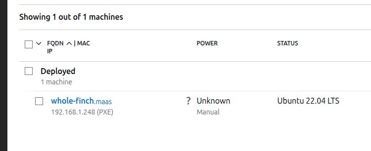

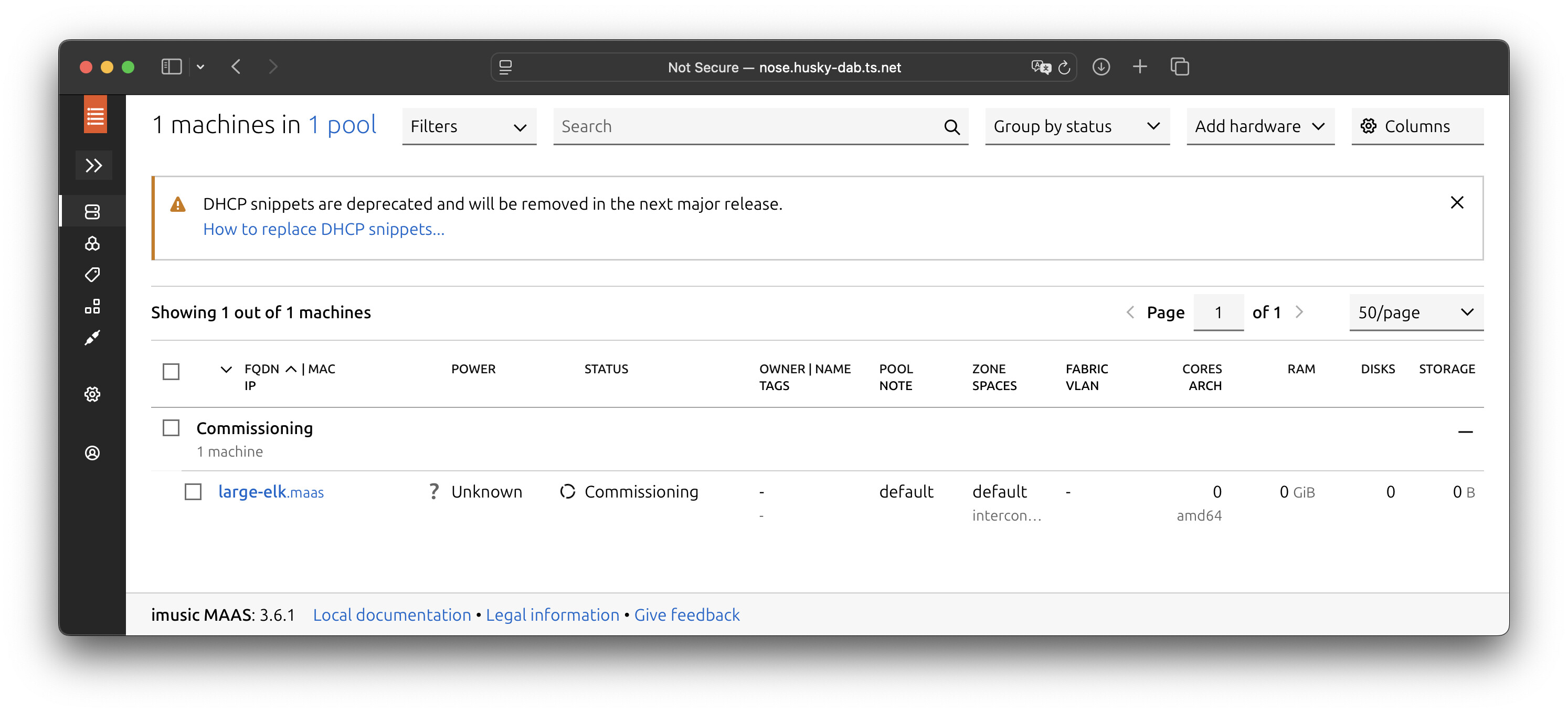

Hey, @christian, welcome to MAAS!
Click on the machine hyperlink in the machine list:

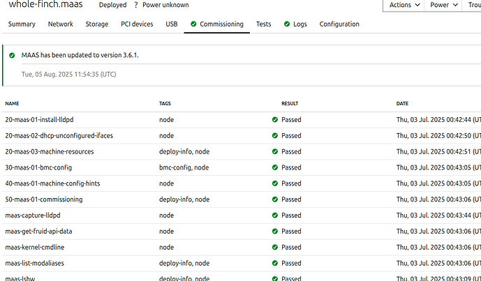

That should bring you to a screen like this:

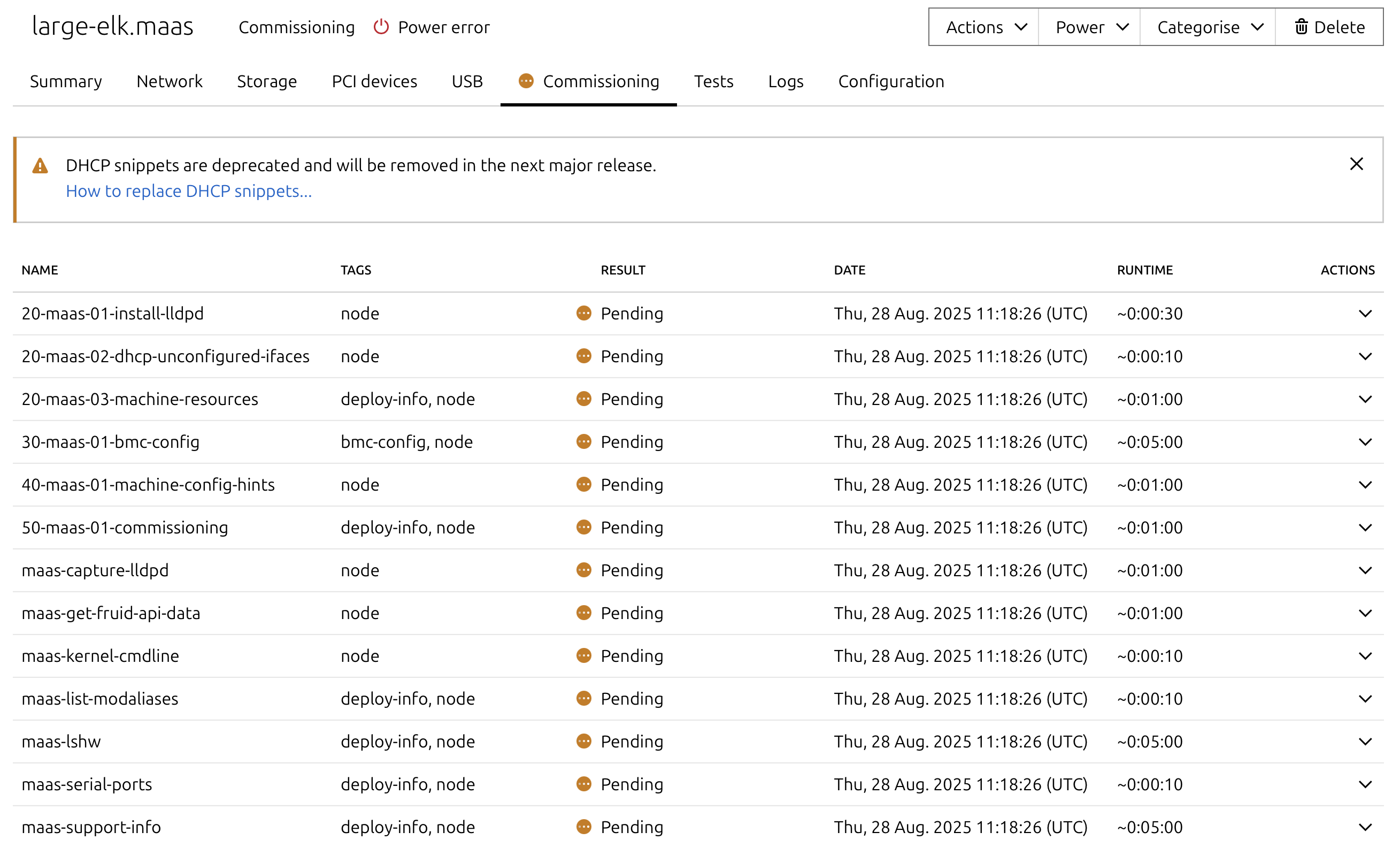

Click on “Commissioning,” on the line “Summary Network …”, which should give you something like this:
What do you see there?
Hi @billwear , thanks for following up.

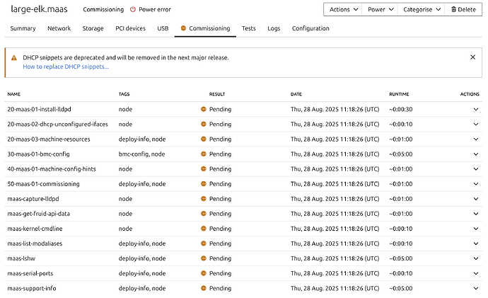

Under Commissioning, the machine shows pending steps:
Additionally, it now shows a power error, with help text “Check power”.
Only a single entry under Logs:
Node changed status - From ‘New’ to ‘Commissioning’

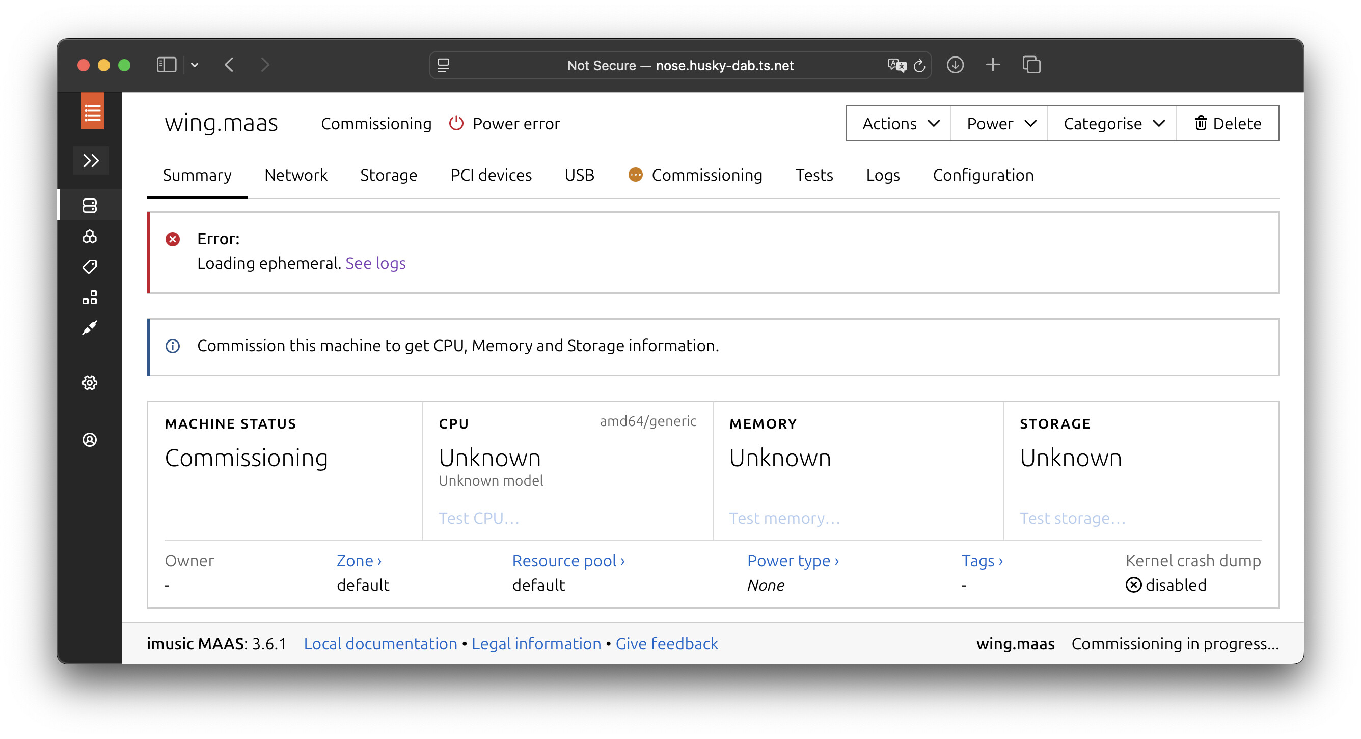

Okay, after defining a gateway on the PXE subnet, the commissioning process went further.
Machine summary now says:
Error: Loading ephemeral

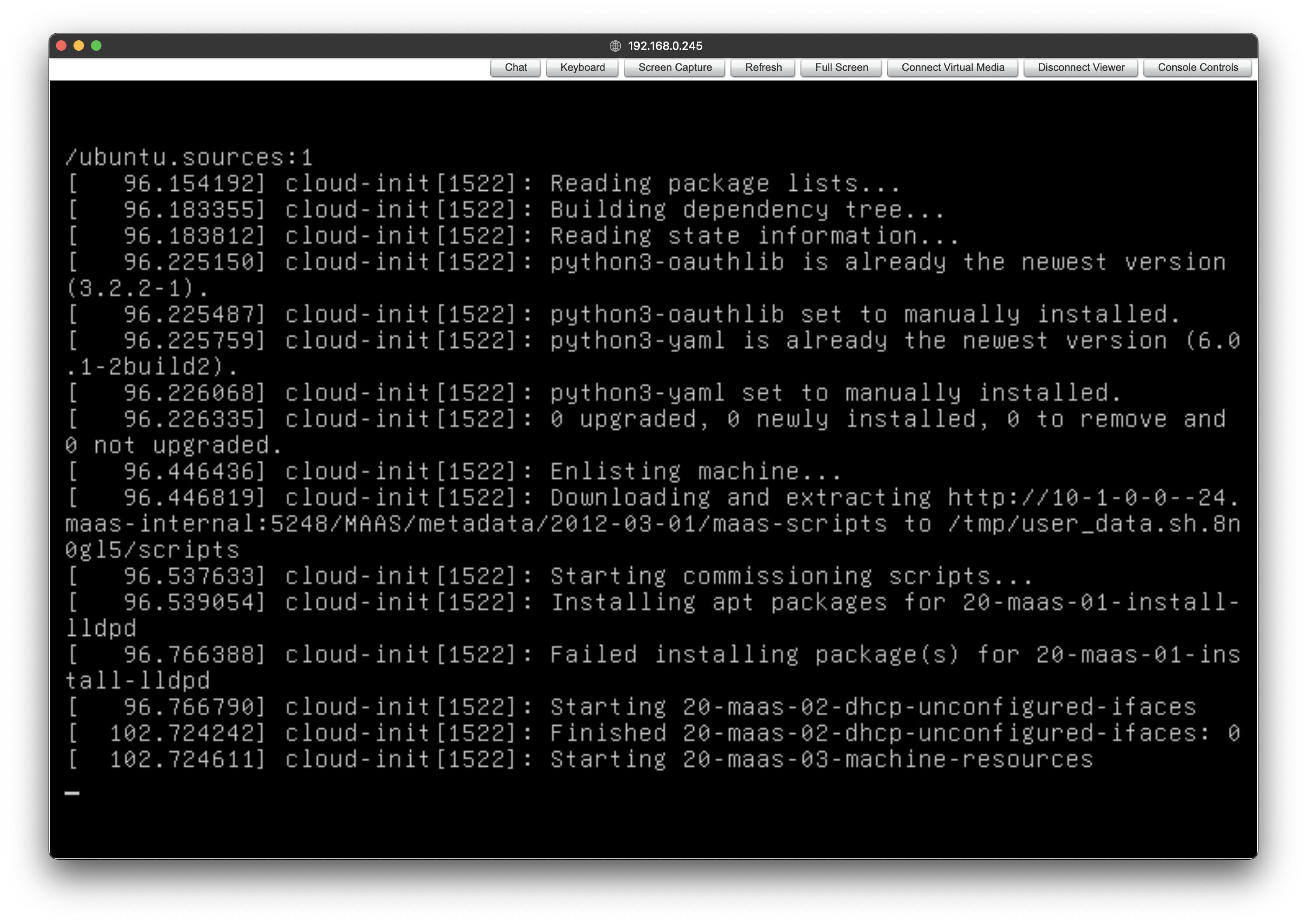

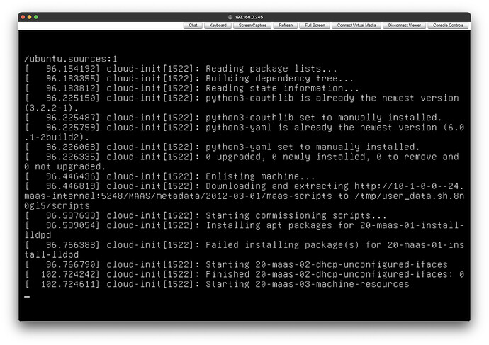

The last thing we see on the console before the commissioning image starts shutting down is:
cloud-init (1545]: Cloud-init v. 25.1.4-@ubuntu0r24.04.1 finished
at Mon, 01 Sep 2025 21:19:47 +0000. Datasource DataSourceMAAS [http://10.1.0.254
:5248/MAAS/metadata/].
Up 44.19 seconds
Then services are stopped and the machine powers down:
systemd-remount-fs.service..mount Root and Kernel File Systems.
lvm2-monitor.service - Monusing dmeventd or progress polling.
Reached target shutdown.target - System Shutdown.
Reached target final.target - Late Shutdown Services.
Finished systemd-poweroff.service - System Power Off.
Reached target poweroff.target - System Power Off.
45.880948] reboot: Power down

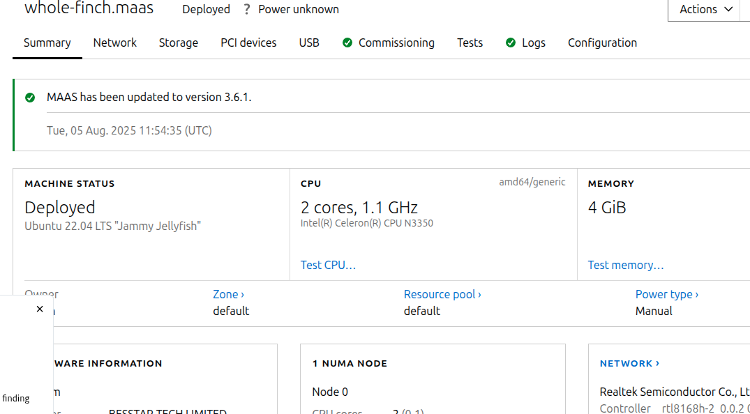

On the machine summary page in the MAAS UI:
I believe something is messed up in your setup. You’d better to check the power credentials as well as the boot interface mac address.
Another thing you can try is to delete the machine from MAAS and power it on manually. It should PXE boot and pop up in the MAAS UI automatically. After that you should be able to commission it without problems
