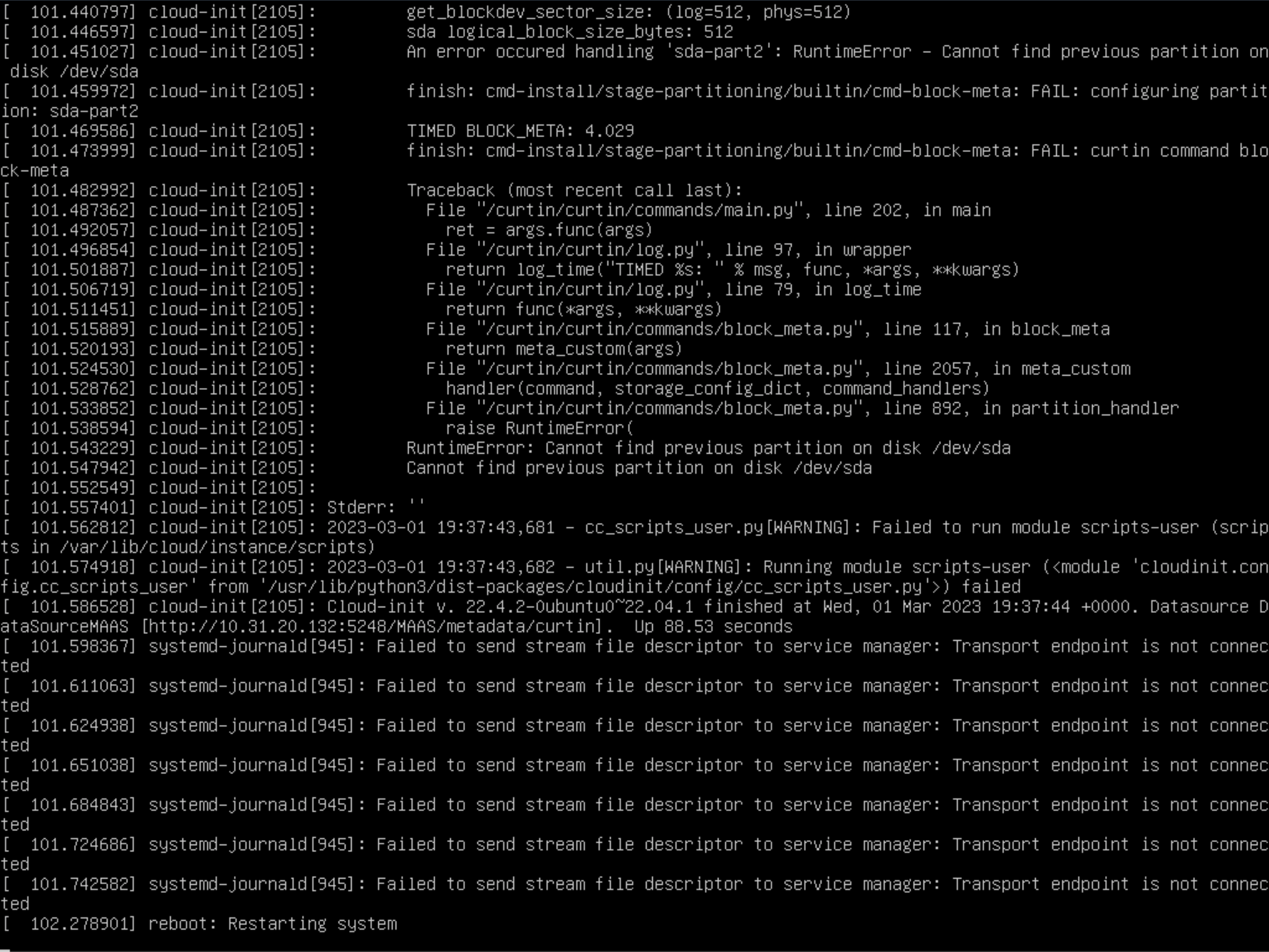

We are currently attempting to deploy to a Lenovo ThinkSystem SD650. The deployment attempt looks something like:
- Node commissions successfully
- We initiate a deployment to it
- It looks as though it deploys successfully, but afterwards it reboots and seems to start deploying again from the beginning.
- This time, the deployment fails (see screenshot ending with “reboot: Restarting system”)
- The node then reboots one more time, attempts to boot under MAAS direction, gives the errors “error: invalid magic number” and “error: you need to load the kernel first” and then stops at the GRUB screen (see second screenshot)
Linked is the messages file from /var/snap/maas/common/log/rsyslog on the region controller. This log file should contain everything from the commissioning, initial deployment, second deployment attempt, etc.
https://gist.github.com/dancaunt/0738006f261177c4e18165ce5a1256e1

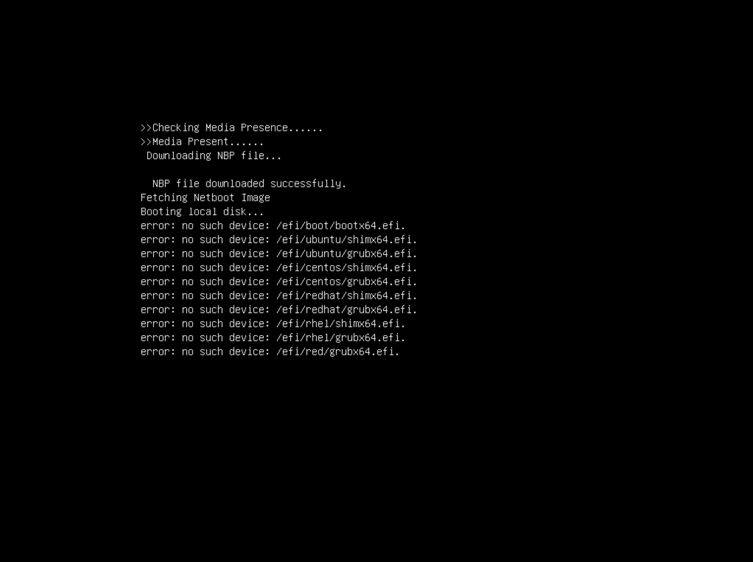

We ran another test today to make sure that the problem was not related to our custom Rocky8 image that we’re attempting to deploy. Even though this image has deployed fine on Dell machines before, we ran another deployment on the Lenovo host with the Ubuntu 22.04 image in MAAS. The results were slightly different so we’re hoping this output may help shed some light on the issue. Or it may look more familiar to those who have more experience deploying Ubuntu.
The deployment attempt looks like:
- We initiate a deployment of Ubuntu 22.04 to it
- It looks as through it deploys successfully, but afterwards it reboots, attempts to boot from disk, and shows the output below (see screenshot)
- After the screen below, we get “no boot device available” and it reboots again (and tries to boot from disk again, and loops like this forever)
https://gist.github.com/dancaunt/b58223d535b2b99a6f5d5005a7a90a93
